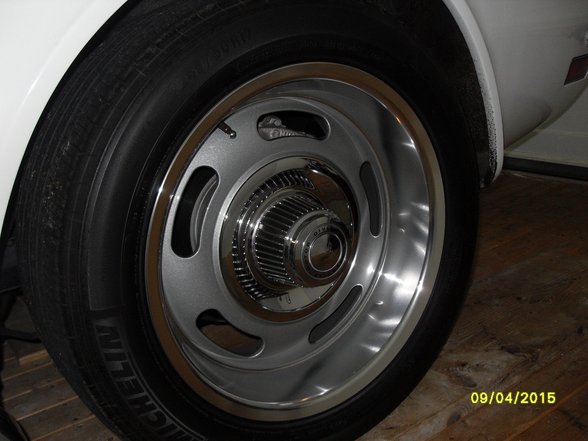

I'm using the Year One 17" Rally wheels 17x8 4.5 BS. I'm using a 1/2" spacer. No issues, wheels work great.
Can't help you with the fitment of the 17x9

Originally Posted by VETFEVER
Hi Barry
Couple of questions:
1 - Is that a trim ring, or the polished edge of the Year One wheel?? If it's a trim ring, are they from Year One? Plastic or metal?
2 - And - Is that a Year One center cap, or an original GM cap? If it's a Year One, is it plastic or metal?
(OK maybe more than one question) Thanks
Couple of answers:
1 - Not a trim ring, it's part of the wheel, and the wheel is one piece aluminum.
2 - The center cap is from Year One, it's plastic. Year One does not recommend using a stock metal cap. I tried one of my original caps and I think it would destroy the aluminum cap retaining "bumps" on the wheel.
Year one caps do not have lettering. I had lettering decals made.

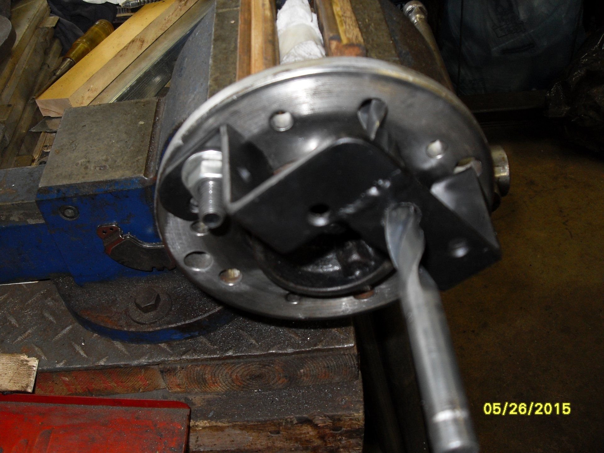

You shouldn't need spacers, others on the forum have the wheels installed without spacers and report they work fine.
I used spacers so the wheel stance/look would be the same as the original rally wheels. However I doubt anyone would know the difference. It's just that I would know.
Also, with spacers I installed new ARP longer studs. A bit of a pain on the rear axles. Hard to "fish" the longer studs in from the rear.
I have 245/50 Michelins and would definitely not go any smaller.
I believe they are about 26.6 inches. I think the later vettes (75-81) had larger tires than that.
Note, with the 17" wheels/Michelin tires, the improvement in handling was incredible. Didn't really feel any harsher ride with the reduced side wall height.

Originally Posted by steve cantrell
Ok I'm going to order the studs from your link now, thank you again for all of the help. The rims arrived today and they are really a beautiful wheel.
Would you happen to have a recommendation for the spacers? I think I want to try the 3/4 inch to kick the wheels out.
Also, do you think there would be any issues with running a 255? I'm wondering what sidewall to use, a 50 or 55? Just wondering your thoughts.
Nothing is ever simple..... The wheel studs in the link was the nearest fit I could find. They are "slightly" larger in the knurl area than the stock Vette wheel stud. You may be able to press them into the flange, however they seemed very tight.
So, I slightly enlarged the holes in the flange using a 15/32" drill bit. Then the new studs still pressed in firmly, but easier.
If you do use a 15/32" drill to enlarge the hole, be very sure you drill them straight. I made a jig.
For the spacers, I used a good quality Billet Aluminum one. There are lots of brands available. Here is the one I used.
Performance World wheel spacers (50500)
http://www.performance-world.com/Bil...ers-s/1877.htm
If you will be using a 3/4" spacer, I would think a 255/50 tire would work fine without any rub issues. With the 1/2" spacers and 245/50 on mine I have no clearance/rub issues at all.
I prefer the "50" series tire, depends on the look you like.
A 255/55 might be getting a bit "tall", you should check the diameter of your choice of tire and compare to what you have now to be sure you have enough room.
My previous tires were 245/60-15, and I had a slight left tire rub when steering was full left. Made a shiny spot on the frame, no bind, just touching.
I don't get this with the Year One wheels. The "rub" was one of the reasons I went with the 1/2" spacers. Without the spacers I had a concern about a potential bind on the left front.
