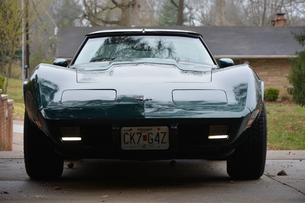

What has been used in a '79? I'm open to either modifying the front turn signal housings or installing behind the grilles.

I did these on my '76. I used clear casting resin to make a front lens and some aluminum to make a mounting bracket for some really intense COB LED's. I sprayed frosting paint over the resin to make it not so clear. They work pretty well.
I added a fifth row and put the lights behind that.

Mine will come on with ignition and turn off when the headlights are turned on. How? Simple. SPST relay. Common relay terminal to IGN power. Normally closed contact to DRLs. Relay coil connected to headlamp low beams and ground.

Your general design won the competition and the spouse approved. Beyond the excellent utility and aesthetics I appreciate how you did not modify the stock components in any noticeable way. It is also a great project to improve my plastic fabrication skills.

Here's the final result:
