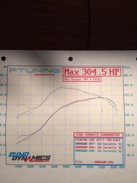

The engine (454 NOM) on my 68 convert ran well when I got it so I spent my time fixing suspension, electrical and brake problems. I finally decided to see if I could add a little more power to the motor. I had it dyno-ed to check my starting point and was surprised to get 304 rwhp on the LF-8, which was supposed to have 250 hp at the flywheel. The PO put headers, intake and a 780cfm carb, but the hp still seemed a little high. When I pulled the valve covers I found a set of roller rocker arms. Nice surprise. I'm going to see if I can get a rough idea what kind of cam is in it by using a dial indicator on one of the valve spring keepers to check lift. Heads are 1976 vintage peanut ports, so I'm going to put a pair of large oval port aluminum heads on it and maybe upgrade the cam. Sounds like a good winter project. RA

Always nice to get a pleasant surprise like that. Also, while there is lots more to be had there, 300HP at the rear wheel is nothing to sneeze at. Makes for a fun ride!

"300HP at the rear wheel is nothing to sneeze at. " True, but with a decent set of heads and a cam with at least 0.500 lift I should get well over 400 hp out of the 454. If I want to go really crazy, I might change the flat top pistons to dome top to boost the compression. Or- as my better half remarked the other day "Why do you need more power? To get pulled over by the cops more often?" RA

That's a darn good starting point.

That is damn good power for peanut port heads....I am doing a peanut port 454 for my 82' C20 and that is right about where I thought it could be.......
