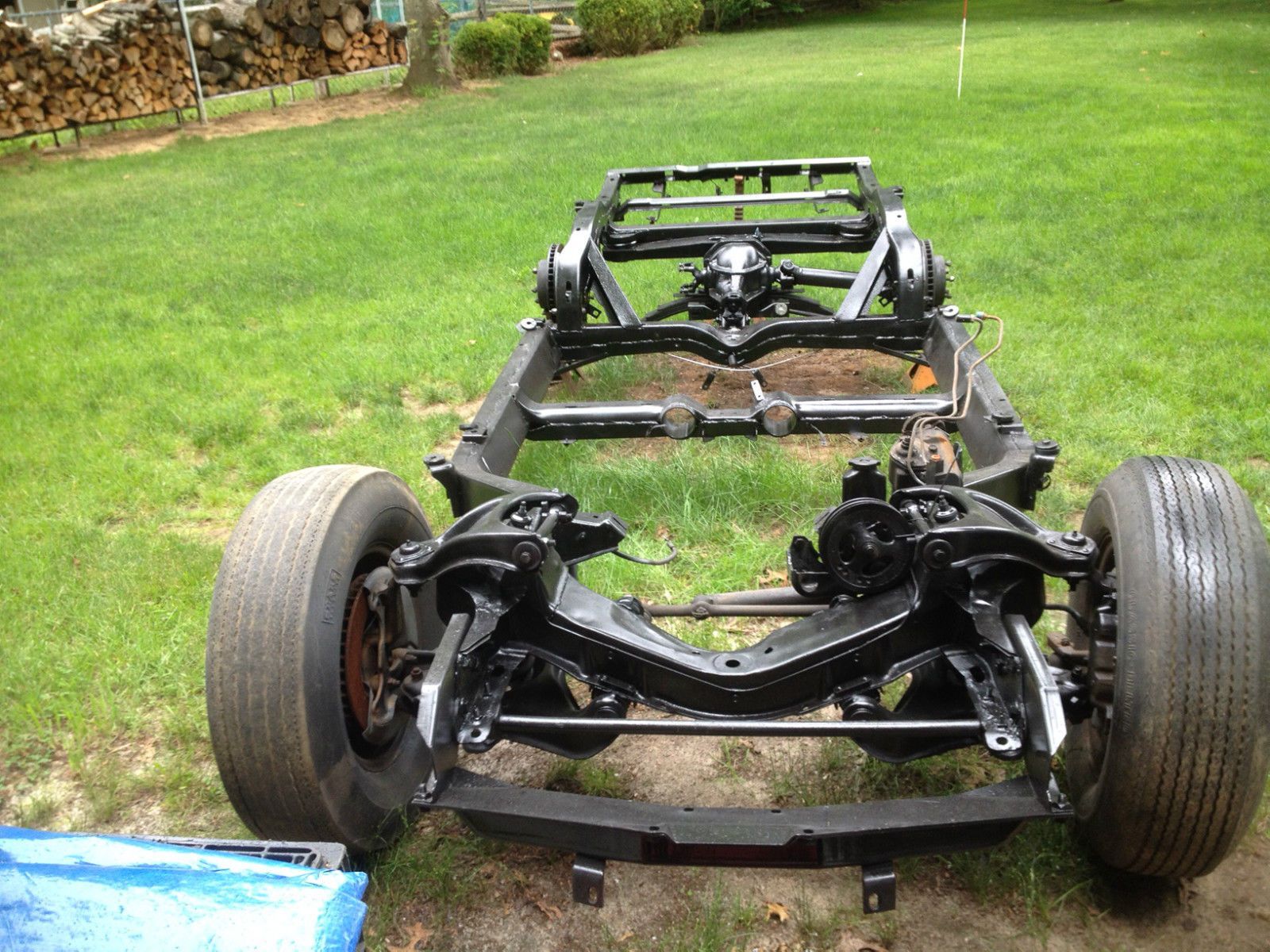

After May-June 1968 frames had the gusset supports to strengthen the frame rails at the kick ups.

4) As others have pointed out, all 69's had the frame reinforcement. This was a running change made during 68.

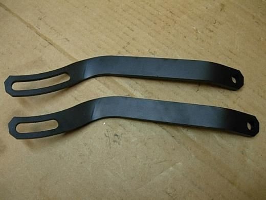

Two types of black smog pump brackets for 427 cars (as opposed to the orange bracket) Early design had a small slit to adjust the smog pump, later design slit was about an inch longer this occurred around February. Some people think the early design was 68 only but I'm positive it started to change around Feb 69.
Here is a pic of the two brackets

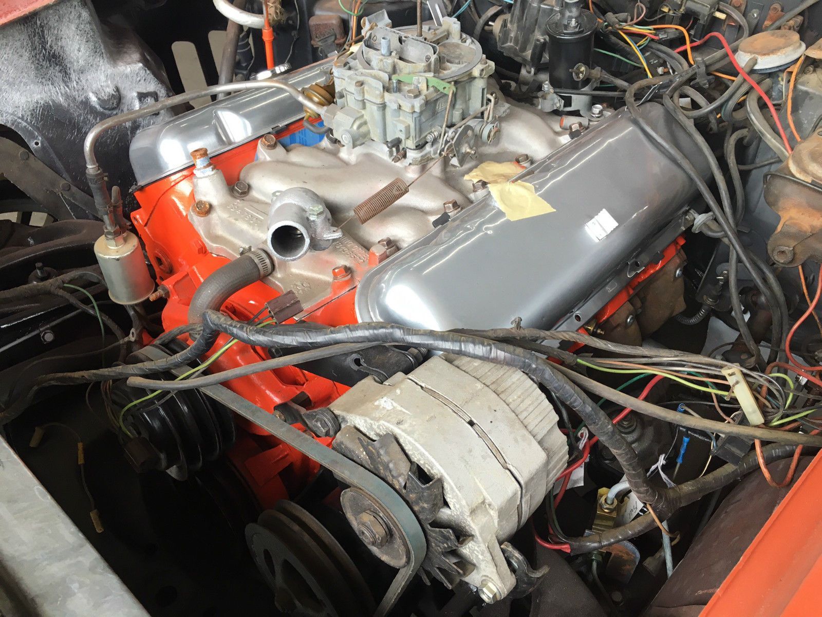

FYI, your alternator belt and alternator pulley are not right. The belt is too big and should be driven off the front groove on the power steering pump only. Do you have a copy of the Assembly Instruction Manual?
