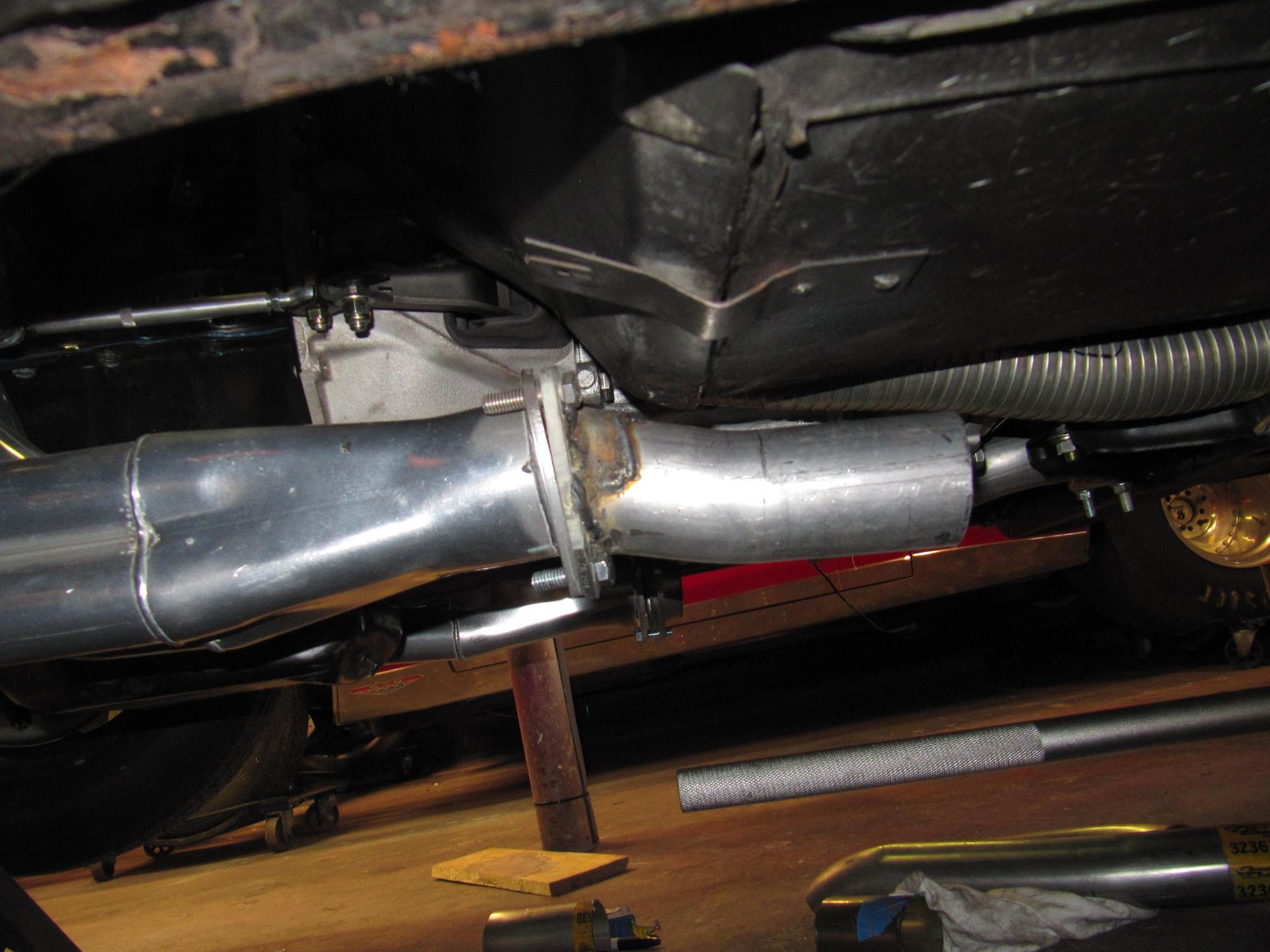

I have a 502 in my car and have Hooker Headers 2123-1 Moroso solid mounts and an Energy trans mount. The car has a 4 speed. The p/s header fits fine but the d/s is close to the floor. I can't get the collector to go on. It seems the engine is about 1 1/2 inches to high. I had the same setup in a 77 and didn't have any problems. Any ideas.

I hate to say this but is it the header? Is the collector welded on properly? If it's tilted up just a bit it's going to give you a problem. It wouldn't be the 1st time a set of headers had a manufacturing quality issue.

In that pic, it looks like the header flange looks like it at a angle, compared to the long pipes that are welded up to it...
I noticed that to guys. The top of the flange is tilted in. What I think about doing is cut the collector back about 1 1/2 to 2 inches and then re weld the collector ring back on at a slight downward angle. That should give me clearance...I hope.

Well here's what I came up with. Don't mind my crappy weld. It will be all ground down and made nice. Now I have to plumb the exhaust, I may use the flex pipe or I may figure something out with pipe. Either way it will be wrapped and some insulation on the floor. I used flex pipe on a 77 I had that had a 540 in it and they worked fine.

Looks like it should work, to bad Hooker doesn't have better quality control...
