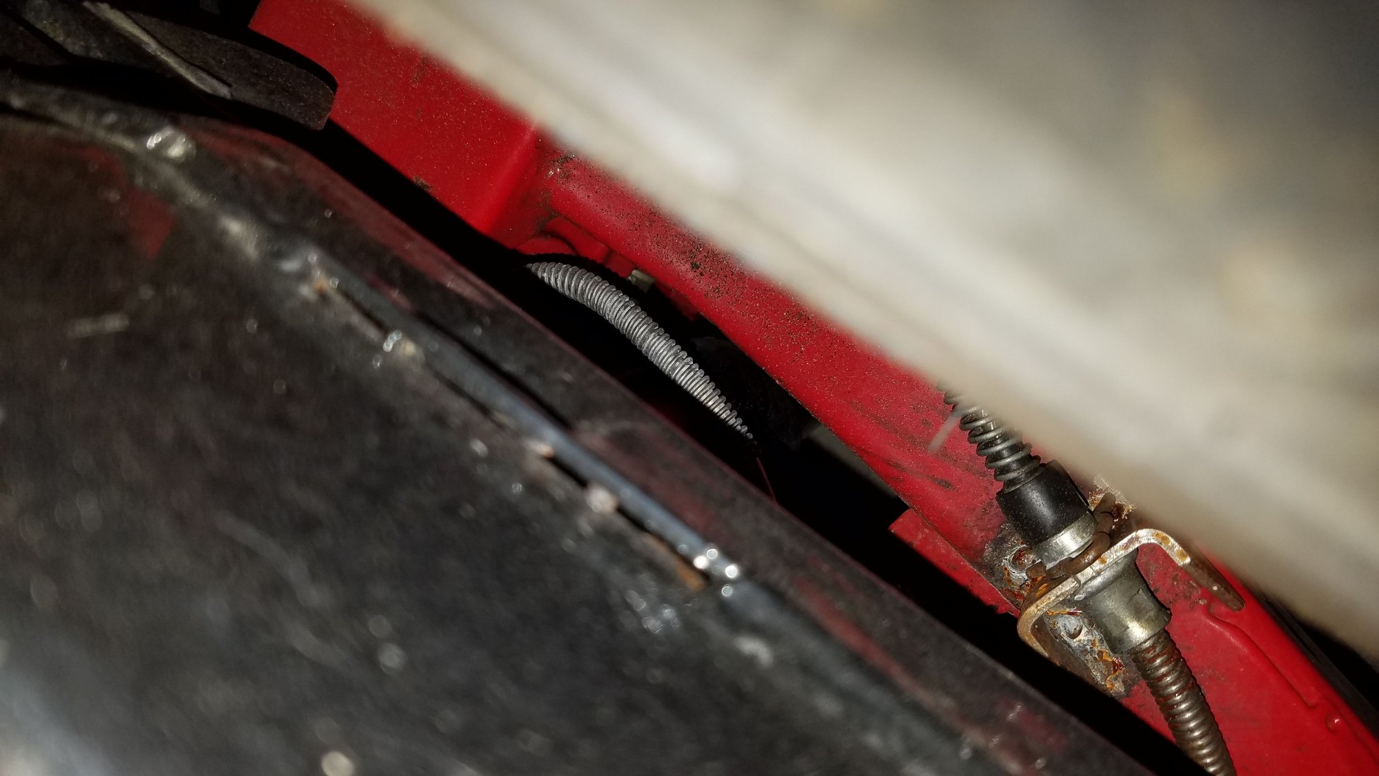

Redcruz1120. You probably wouldn't have any pictures of what you did would you
I just went to take this picture. Obviously it's from the top looking down
