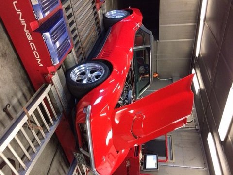

Perhaps post some pics...its a very sought after hood some glass house should jump on producing,
I am sure vanacors wasnt the only place that made them just the only one i knew off, there were also a few that made it raised in the back like the l88
Hood raised up

Okay, yeah yours is like l88 in rear....very sweet
