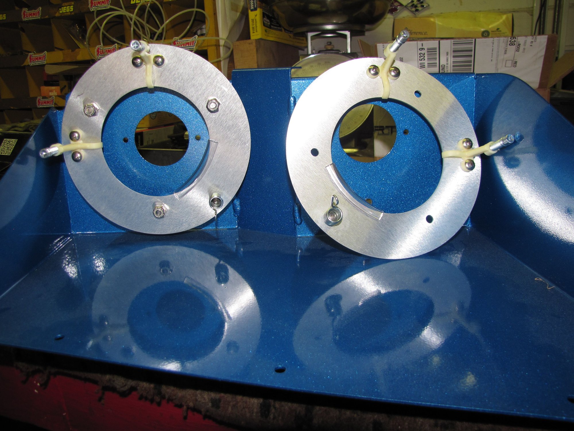

So a number of years ago I bought the FIA headlight kit from FGregg Racing.
I am actually getting around to finishing the installation and I was wondering:
What is the donor vehicle that the headlight adjuster screws come from? The guys at autozone are less than helpful if they cant look it up on the computer.
Any help would be greatly appeciated.
The other thing I noticed is that the springs are really tight and like to bend the headlight cups. Any experience anybody may have in this regard is also helpful

Whenever I try and adjust one of the lights to be remotely straight the spring pulls the adjuster out of the housing. I bought the buckets and rings from Zip, and I think they may have the wrong taper on the back relative to the buckets in the other pictures.
I will take a picture tomorrow.
