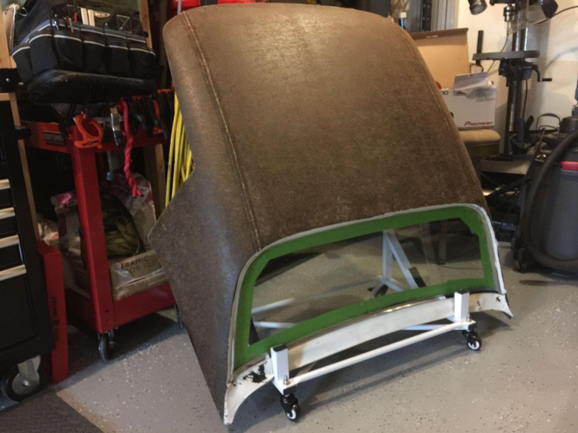

CF Nation,
I'm in the middle of restoring my hardtop and I can't get the trim to budge. I have tried many tools including the arrow tool I saw in so many videos and still no luck!
Can someone share their knowledge and experience so I can begin ripping the vinyl off...Please!!

The more I try to get the trim off the more I think it's held in by the sealant. I say this because I can't seem to visually or feel a clip as I slide my tool beneath the trim. My tool comes out black with sealant residue which makes me wonder?
I'm hoping someone who has done a top before responds, if not I'm going to search out an auto body shop and solicit their help.
