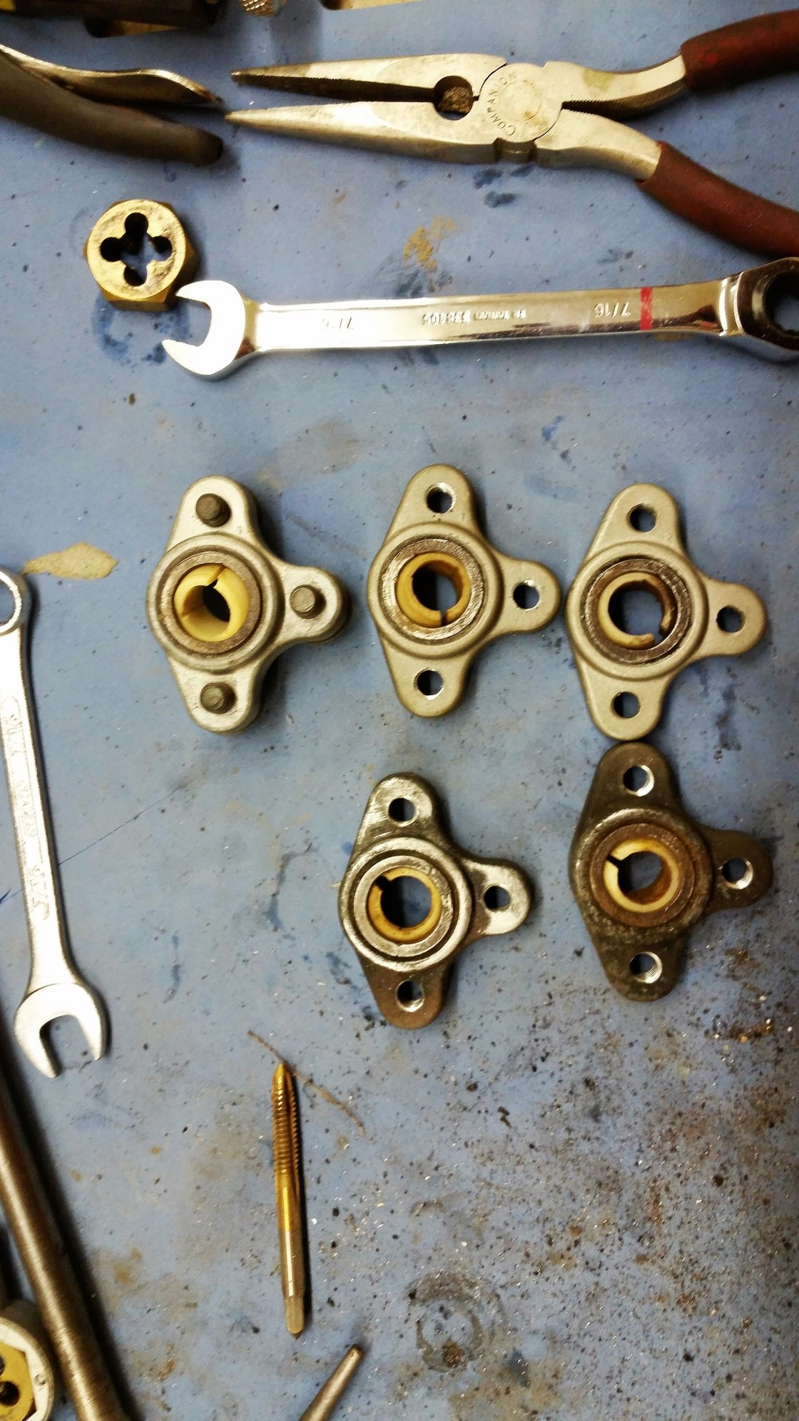

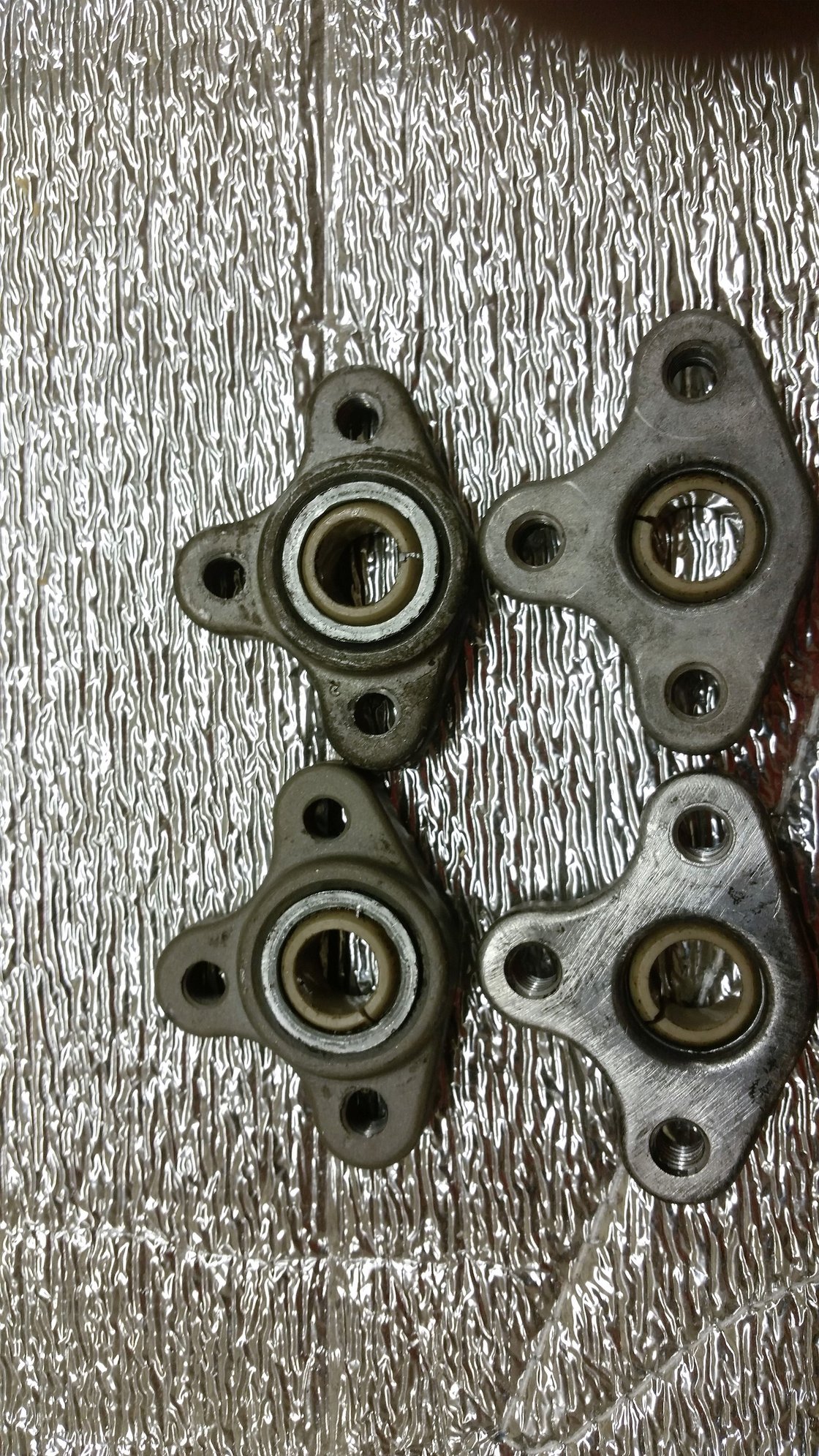

While they are apart it's a great time to review the pivot bushings which can have a lot of a wobble effect which could lead to paint chipping and bad gaps. I replaced the white plastic ball in all for a great fit still using the original housings. The new housings are very different.
A forum member did them for me in his shop.
