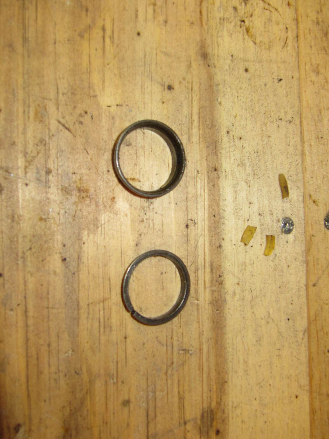

The upper bearing lists a bearing , race and upper bearing inner race seat. I have the race and then another piece that looks like the race but has a split in it.
How are put in in relation to the bearing. The lower bearing seems to ride on the tilt shaft. I don't have the inner race seat that they show on Jims site.

I'm going from memory- and it's been a while. The race without the split goes on after the bearing, then the split one goes on last, then the short fat spring for the cancel cam.
I also have a washer that I think goes over the split one. Then the spring and lock plate and c clip.
Like I said earlier I did these 30 years ago. It is coming back the more I read up on them.
