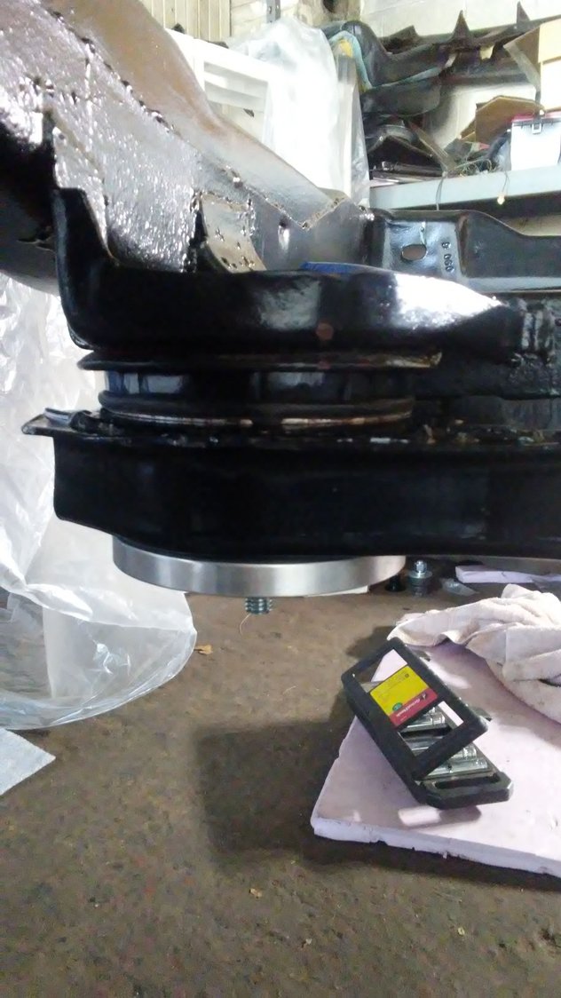

Next were some spacers I had made to fit between the cushion and frame:
I modified the cushion so that the cross member stabilizer disks would compress against the cross member instead of the cushion sleeve, pushing the cushion against the spacer. You can check the modification on my web-site, but here's the installation:

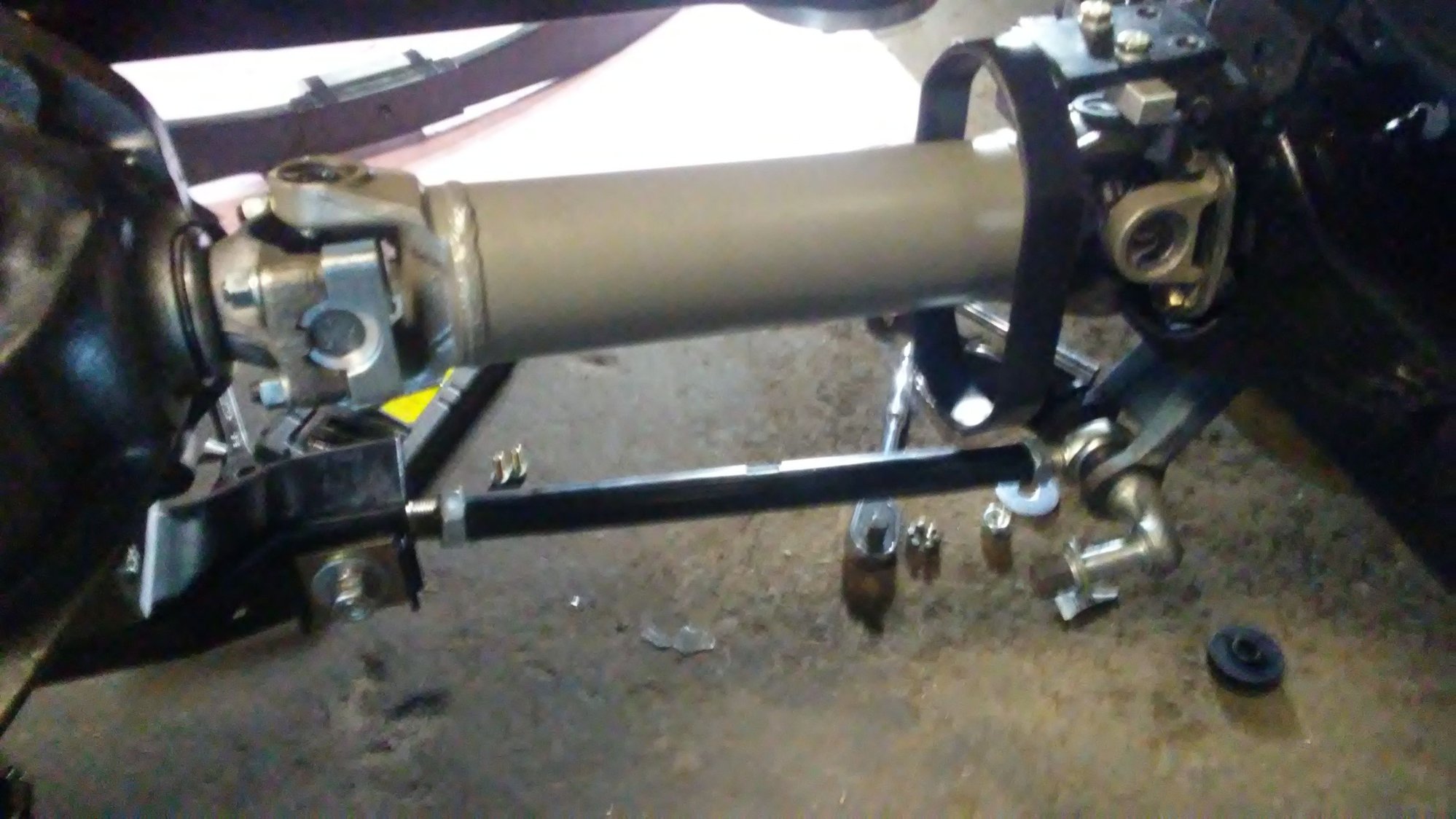

Next we installed the trailing arms followed by the strut rod bracket with the 1/2" spacer a local machine shop made for me.

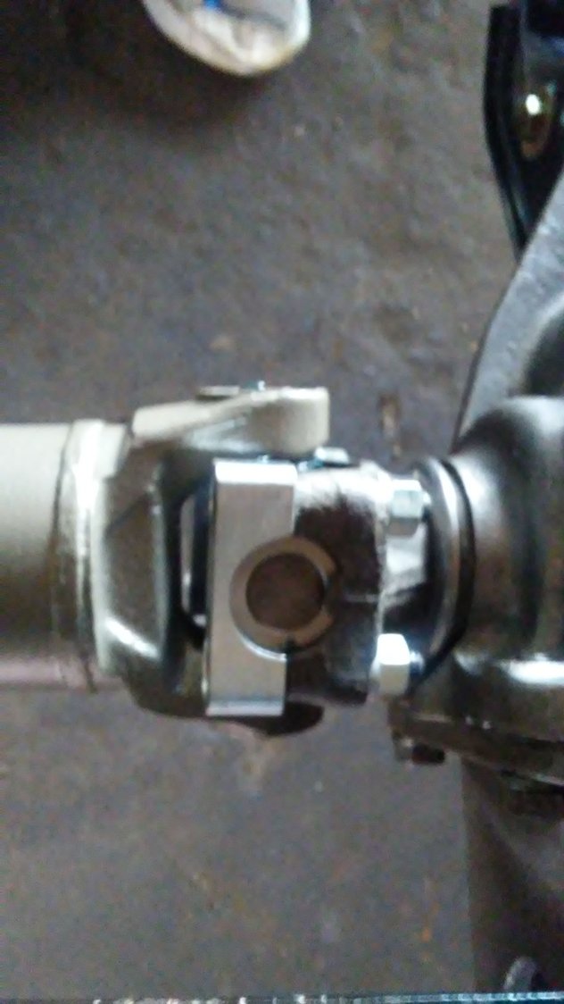

Then we installed the half shafts. I used the upgraded u-joint caps available from dragvette:
Then we put on the half shaft safety loops, connected the half-shafts, and installed the strut rods:

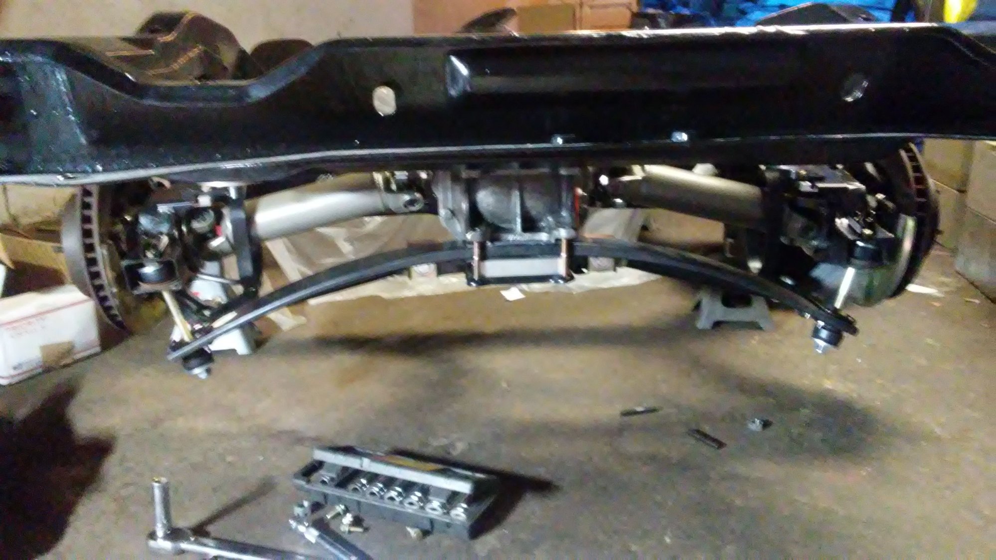

We finished for the day by putting on the VP&P 300# composite spring:
The next day I installed the 3/4" rear sway bar, but forgot to bring my phone, so have no pictures yet. So after a little over three years, I finally have a rolling chassis:
