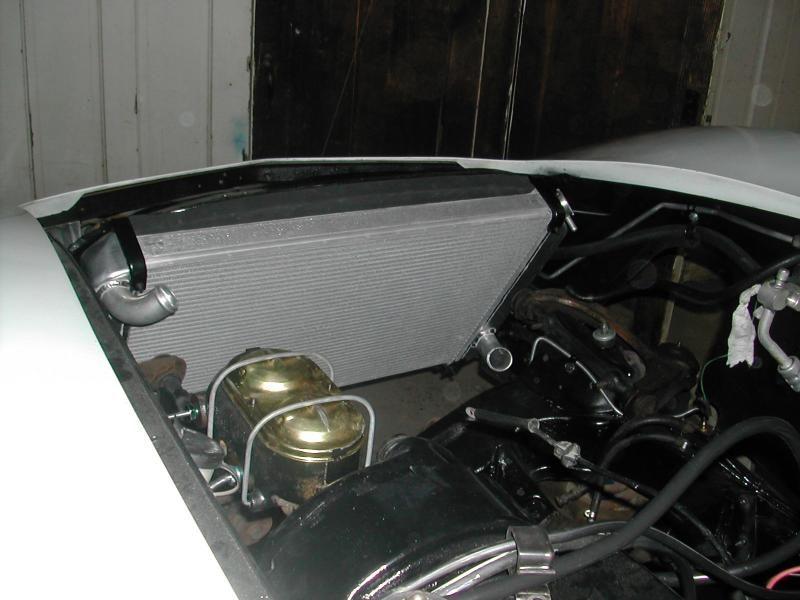

DSCN8005
DSCN8197
DeWitts, look no further, year specific, direct fit, you will never look back. Must have good seal at shroud or you will not get the cooling from even the best radiator.
