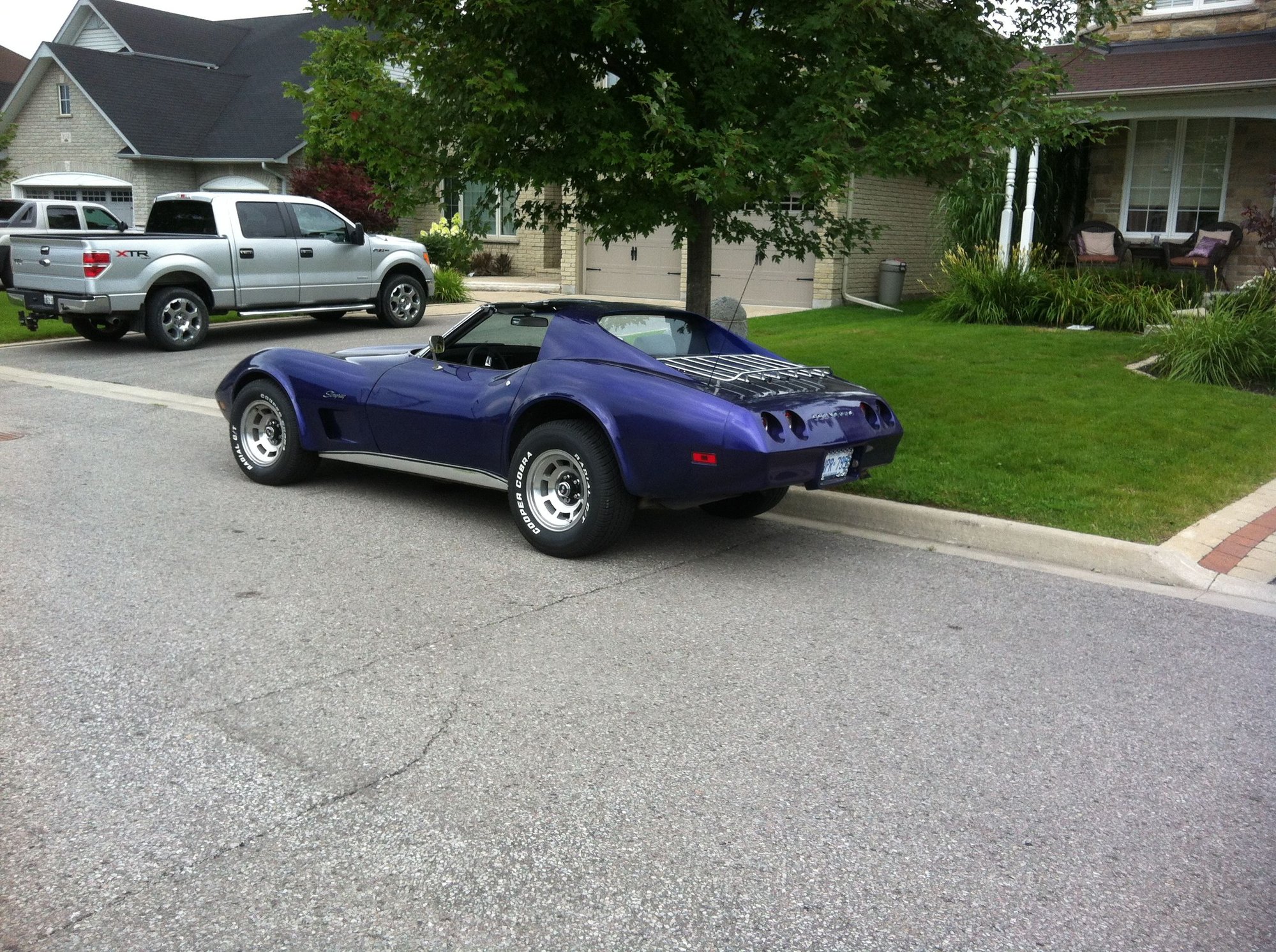

295's would require you to move the parking brake cable.
I was going to go this rout also, but found that the 295's were really hard to find and I didn't want the hassle down the road if I had a problem with one.
I opted for 255's on the front and 275's on the back.
