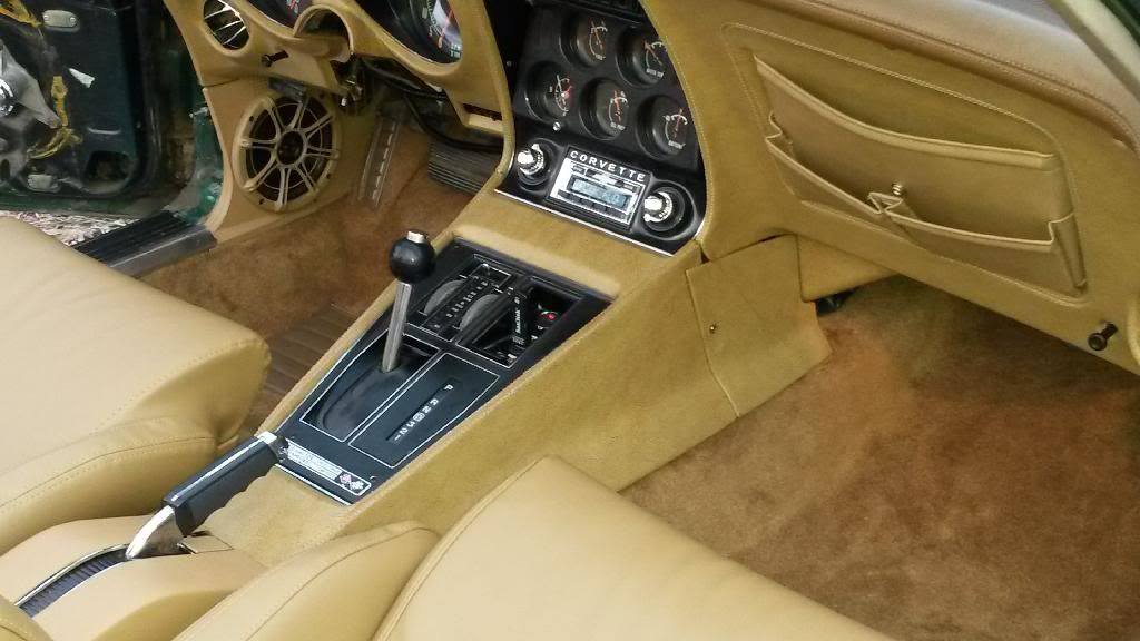

After researching what was available, I went with the CustomAutosound 300 watt version. I have an hidden external amp for the hidden subwoofer.
It looks stock, with the Corvette badging, and has USB music port integrated into the location that used to house an ashtray. This area also has a USB charge port, and remote function and indicator for the Passport radar detector.
As far as quality, it's as good as you will find in an upgraded stock looking head unit.

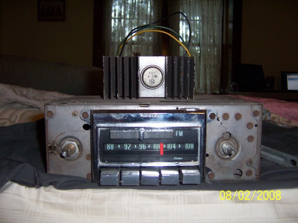

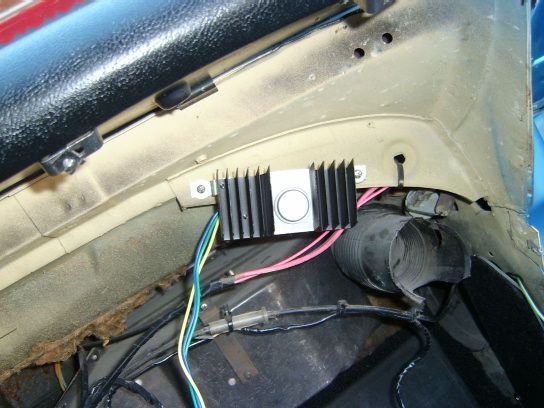

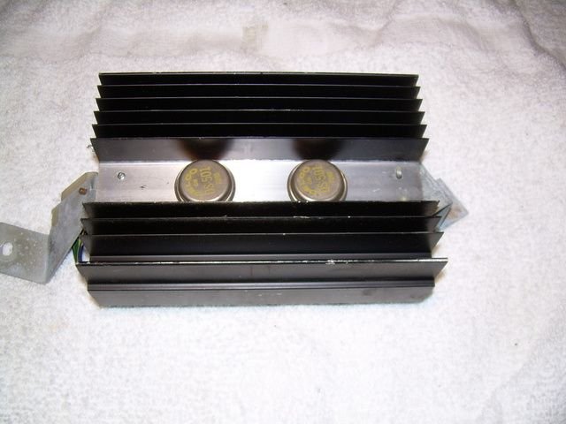

68-76 OEM radios has separate final audio outputs due to space limitation behind the cluster. They amount to D-501 transistors in a heat sink. One transistor for mono.
Two for stereo;
Common installation:
Old Apr 2, 2017 | 09:53 AM
Two for stereo;
ok....that clears it up. I was trying to figure out where the external amp mounts. Will orig radio work without the amplifier?

Originally Posted by Vettesic
...Will orig radio work without the amplifier?...
You will get no sound to the speakers without the final audio.
