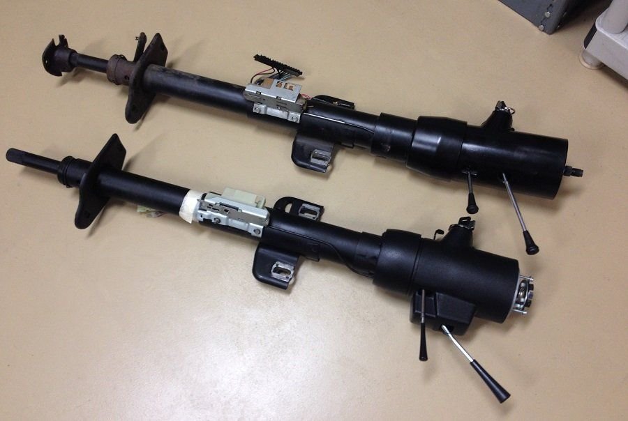

Since the '76 Vette has the "Vega" steering wheel, do you want to keep that one or go with a different OEM wheel or aftermarket?
As stated earlier, if you want to keep your car all original, then rebuilding the factory steering column would be the way to go, or you can look for one that's been rebuilt. 1976 columns pop up on eBay from time to time.
I have a '76 but did not care for the look of the steering wheel and how close it is to the driver, so I found a used '78 column ('77 -'82 units are 2 inches shorter) and rebuilt it. There's a steep learning curve and some mods are necessary, but it's doable if you have the necessary tools, skills, and patience.
The photo above shows the length difference between the '76 Corvette steering column (top) and the '78. The shorter column makes driving the car so much more comfortable and enjoyable, IMO.
