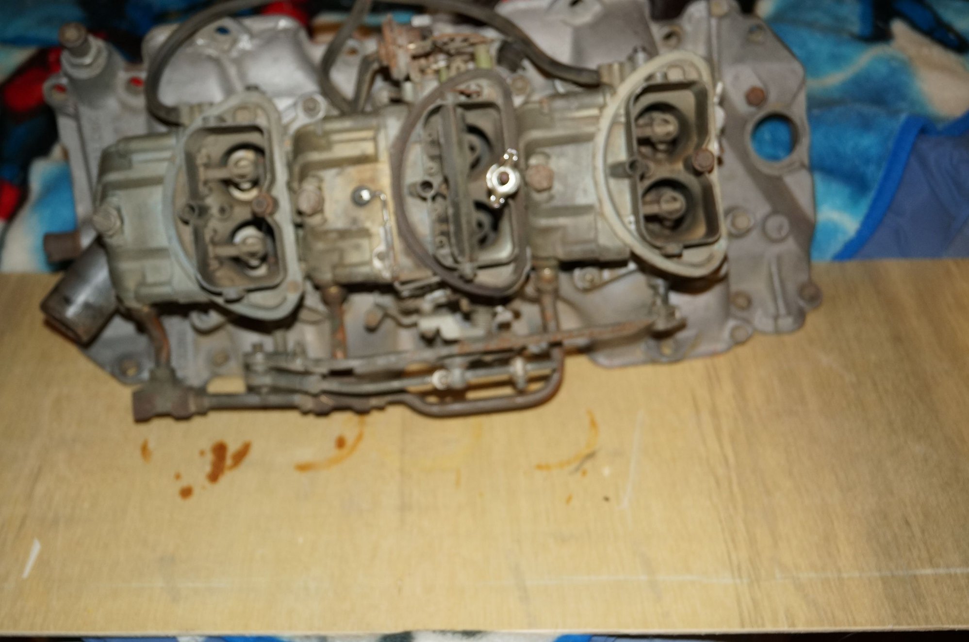

Old Apr 13, 2017 | 12:57 AM
454tuff's Avatar
454tuff
7th Gear
Joined: Apr 2017
Posts: 7
there are the photos i promised to show

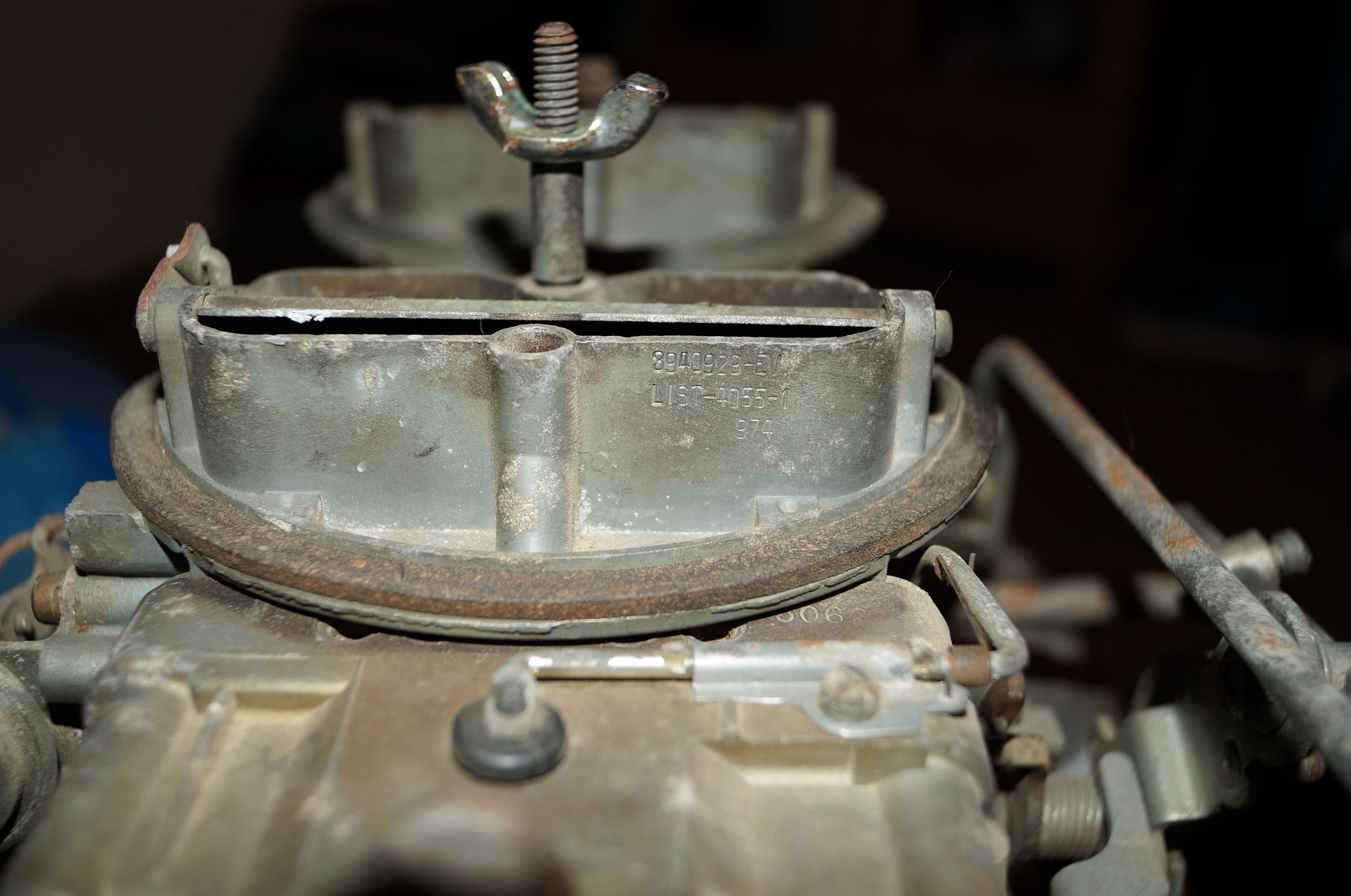

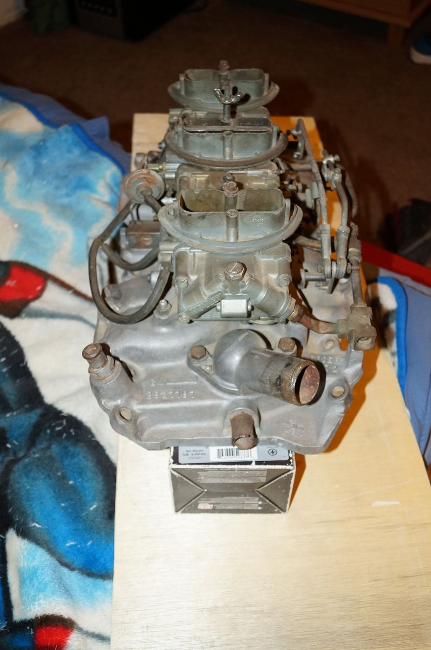

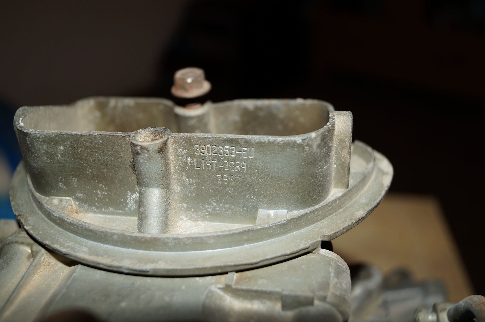

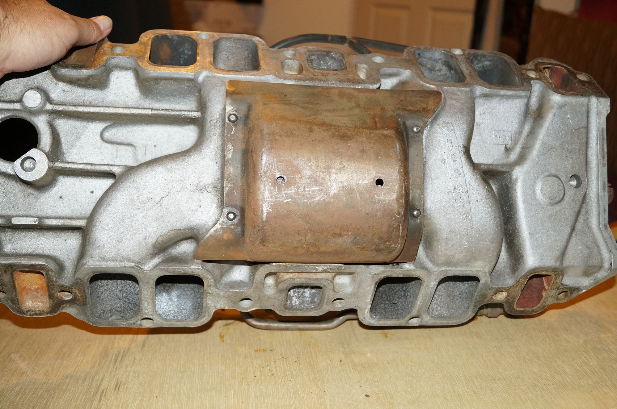

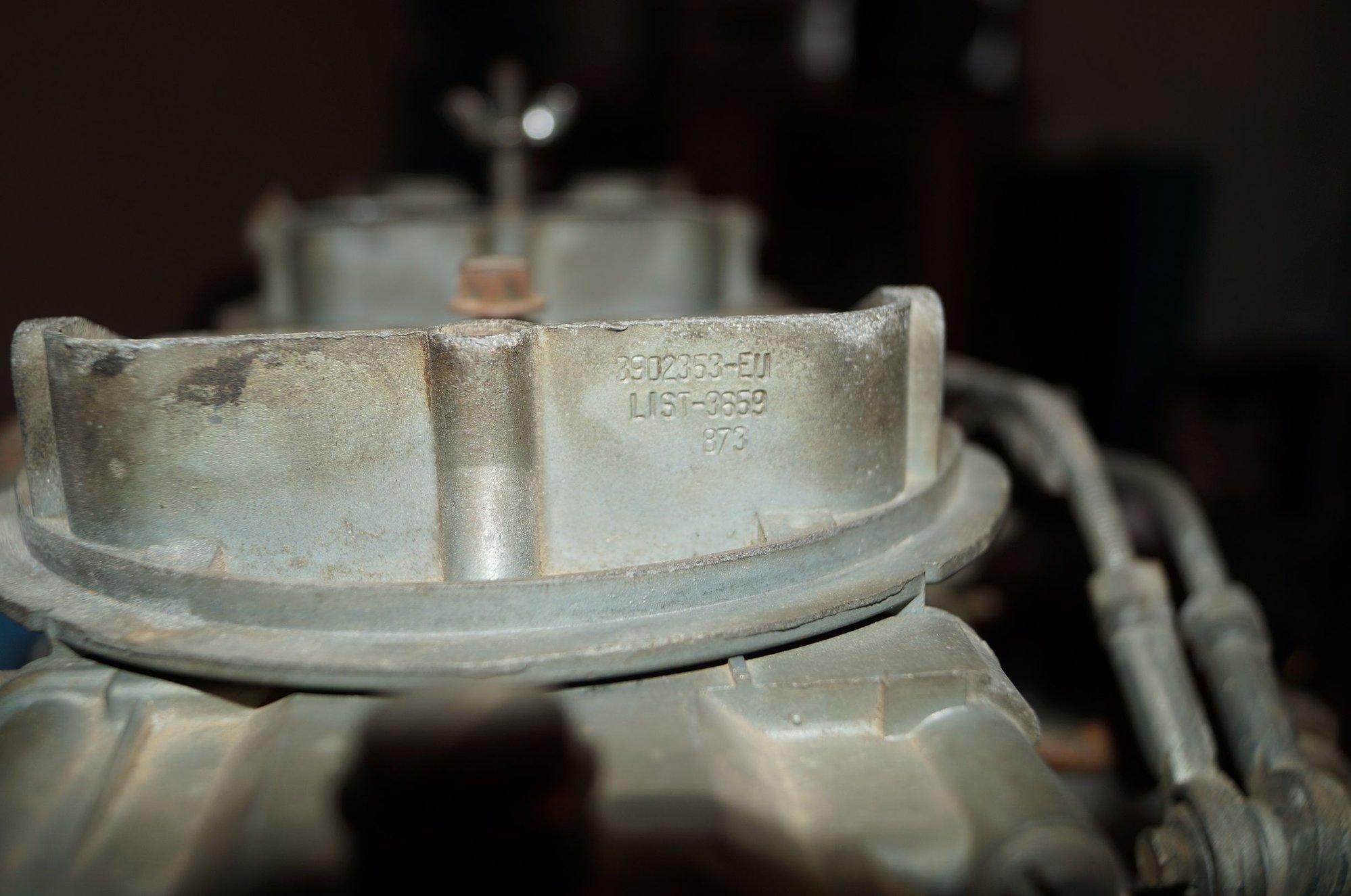

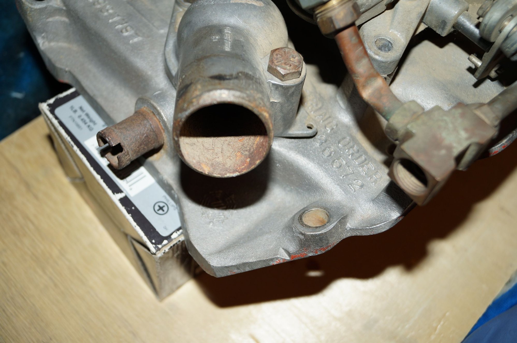

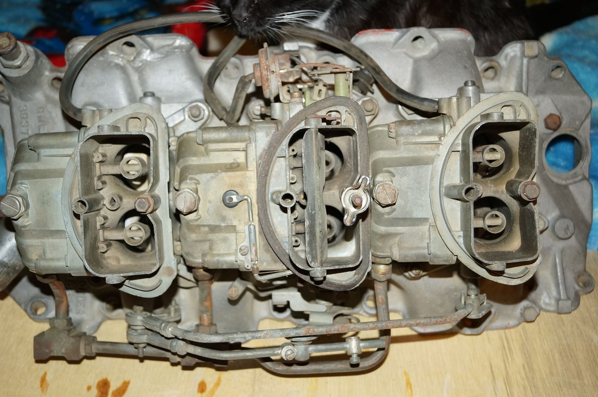

That is a 68-69 427/435 intake and carbs. The "797" intake was used in 68-69 on 435 hp engines. The carbs are correct for a 68-69 435 also, but I'm not sure they are all the original carbs, for that intake. If I'm reading the dates correctly, it appears you have one dated June 67 (763), one July 68 (873), and one July 69 (974). The dates would normally be much closer together.

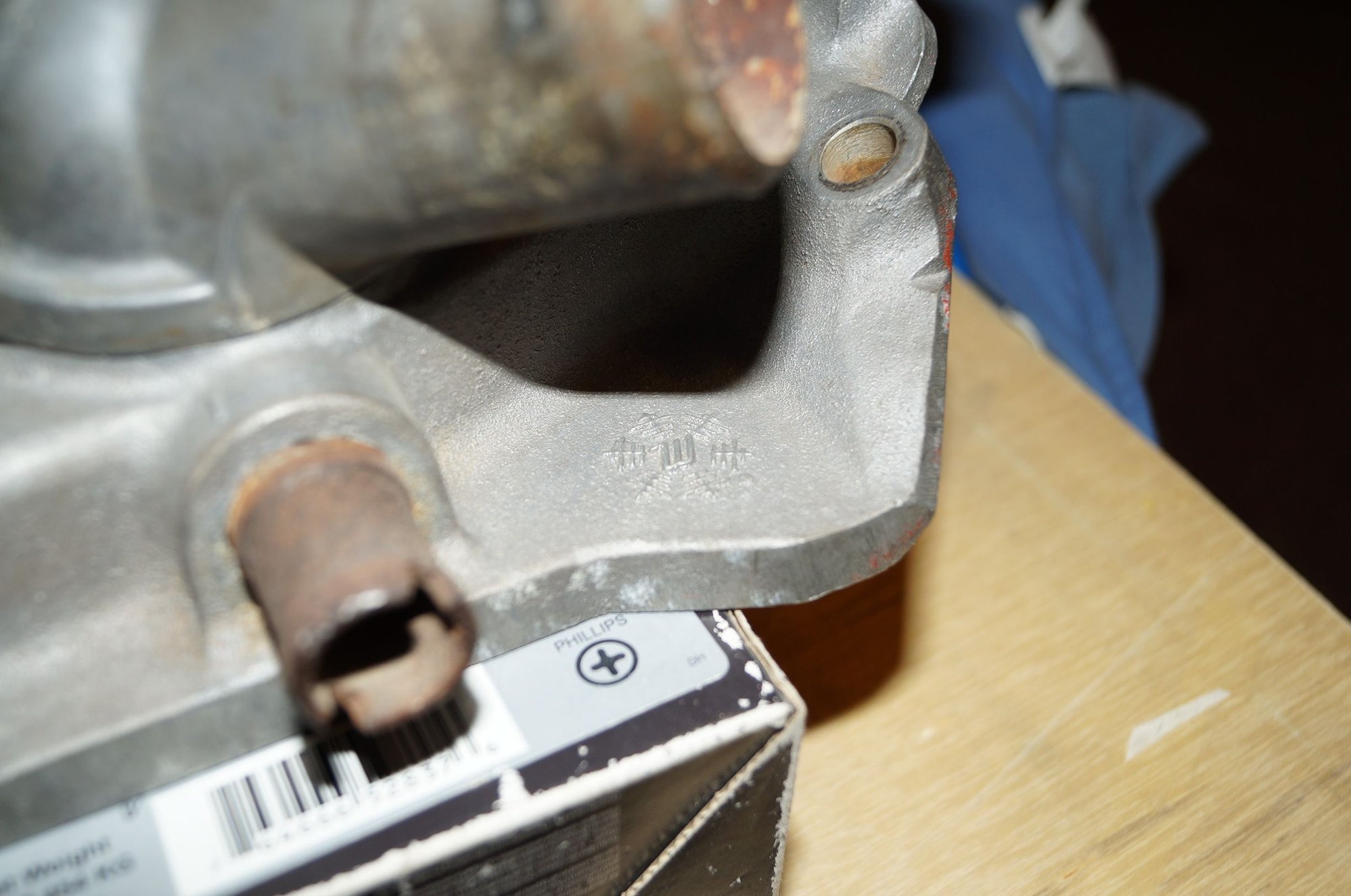

The intake has a date code on the bottom of it, but I can't make it out in your pictures.

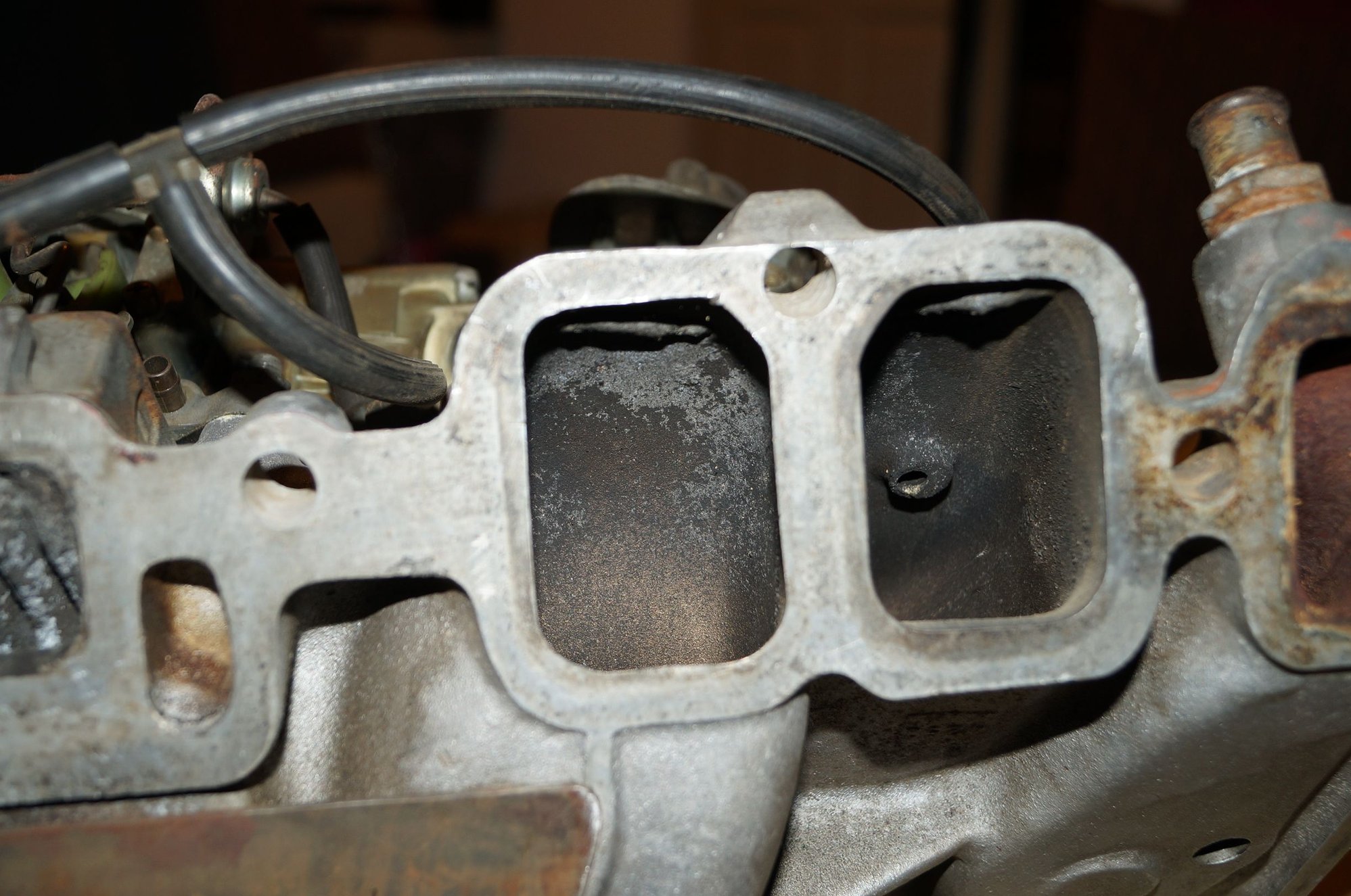

The repair hurts the value of the set up, as does the mismatched carb dates, but I'd still put the value at around $3000. There are people who can clean up and restore the repair.
If the air cleaner bolts in the two end carbs, have an "M" in the center of them, you might want to remove them to sell separately. People will pay ridiculous money for just those two bolts.

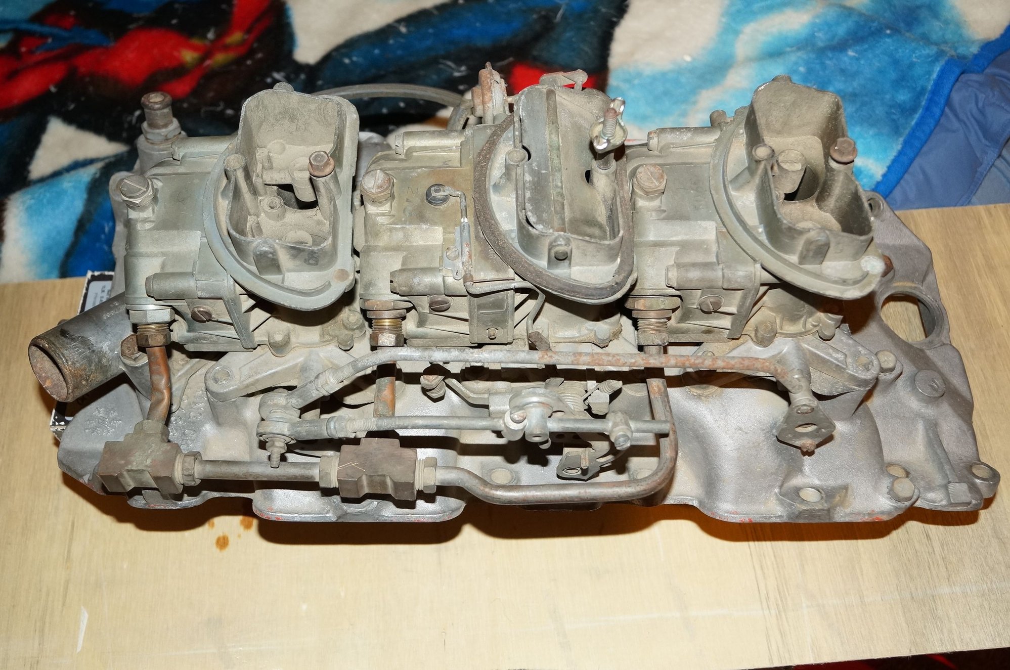

it almost looks like the date casting is missing on the manifold??
I'm not home to double check my manifold, but i thought it was directly next to the other number (pic 4) that says what looks like "4259"
also I agree I'm seeing the same thing for the carbs dates and those numbers mean its not a matched set.
I don't think that setup will bring close to $3k.

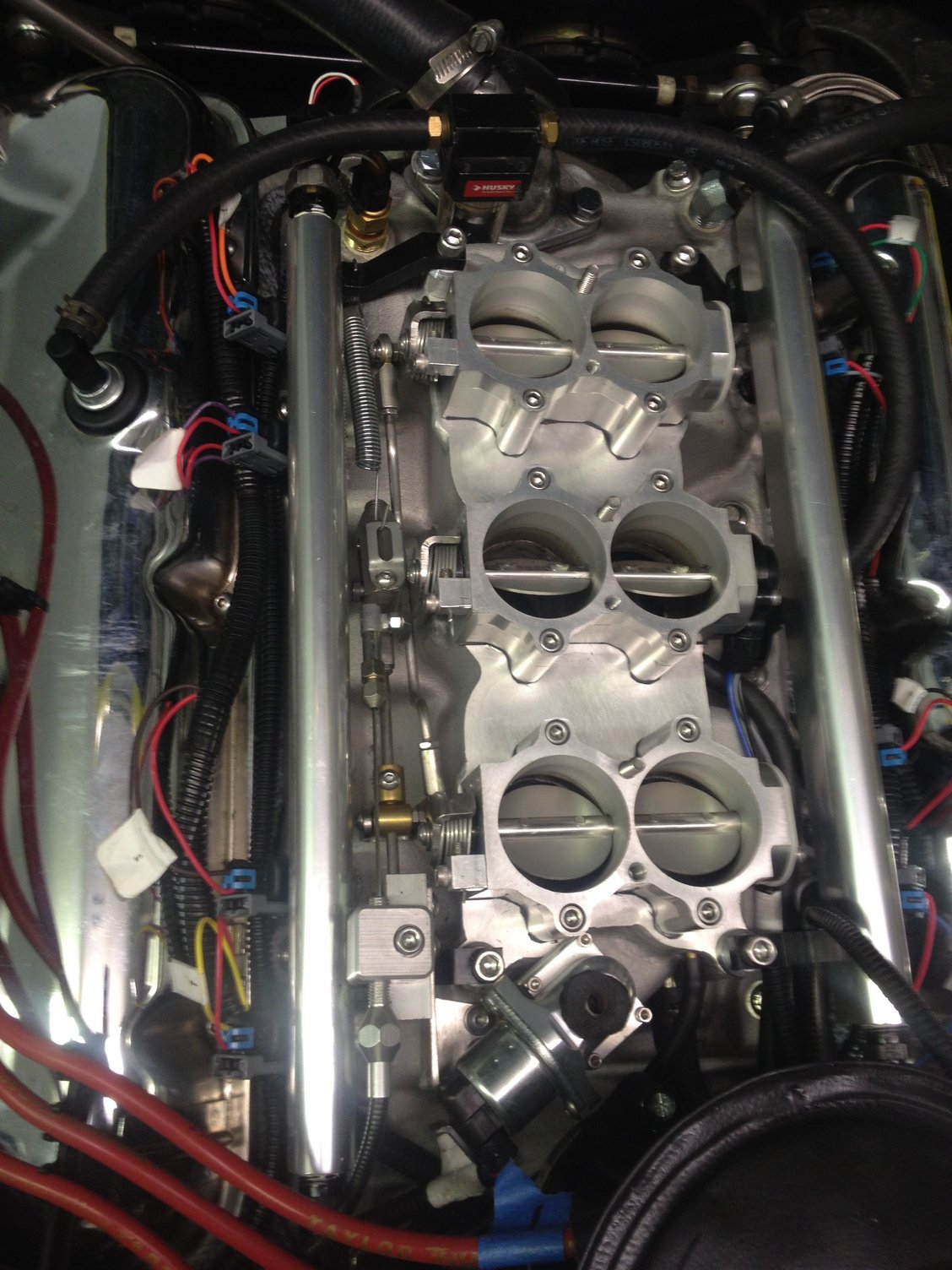

Carbs have been bastardized by removal of the vacuum diaphragms from the end carbs. These were integral to a good driving system. The throttle linkage has been modified to a mechanical secondary linkage bu the end carbs do not have accelerator pumps.
I ran the stock Tripower setup for while on my 496 BBC then I swapped the carbs for a set of Mopar SixPack 4782/4783 carbs that are designed as a mechanical secondary setup. Accelerator pumps and jets (no plates) on all three carbs. Car ran like a monster but I was tired of the smell at idle and the fact that it would want to die on hard braking due to fuel slosh.
So, my ultimate solution is a custom port injected EFI Tripower. Manifold is an Edelbrock dual quad welded and machined for 3 two barrel throttle bodies. FAST XFI 2.0. All work was done by Bruce at F&B Throttle Bodies. This is all under a stock '75 hood with ~1/2" of clearance and filter that is 3/4" taller than stock. If I was using an L-88 hood, we could have used the Dual Quad Air Gap manifold as a basis.
