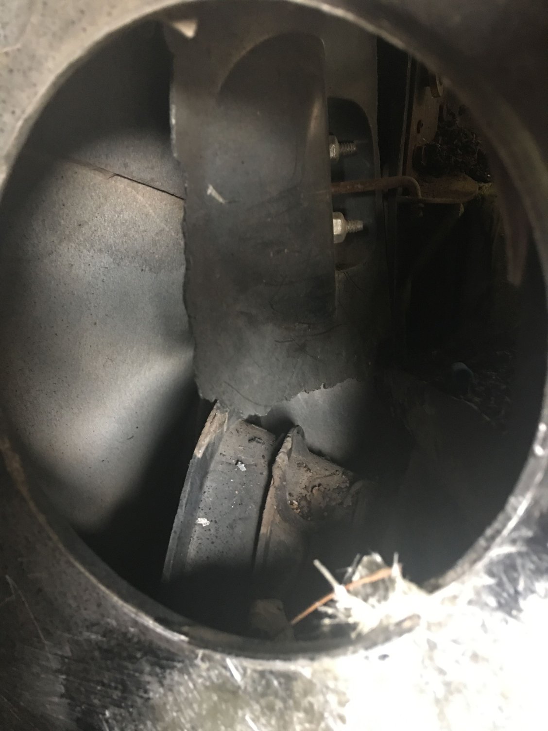

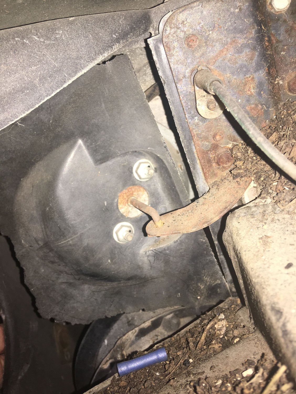

So my AC hasn't worked since I bought he car and I am trying to get it back in shape. I took it all apart and Found this broken part behind the heater core. Not sure how this is supposed to be. Or what it's supposed to do. Any help?

Flapper door tucked up under the passenger's side fender. If memory serves, they are not being reproduced. Corvette salvage or eBay may be your best choice. IIRC the door is open for fresh air and closed for AC.
so if I can't get one, if I make sure it stays closed, I should be ok?

It was suggested to me a few yrs ago on the forum to go to Michaels (the craft store) because they sold material to use for the flapper door. I did that but didn't think it would work too good. I went to my local hardware store thats been in business for like forever, explained what I needed, and the guy went up in the attic storage and produced a sheet of rubber that has seemed to work out. He didn't even charge me.
