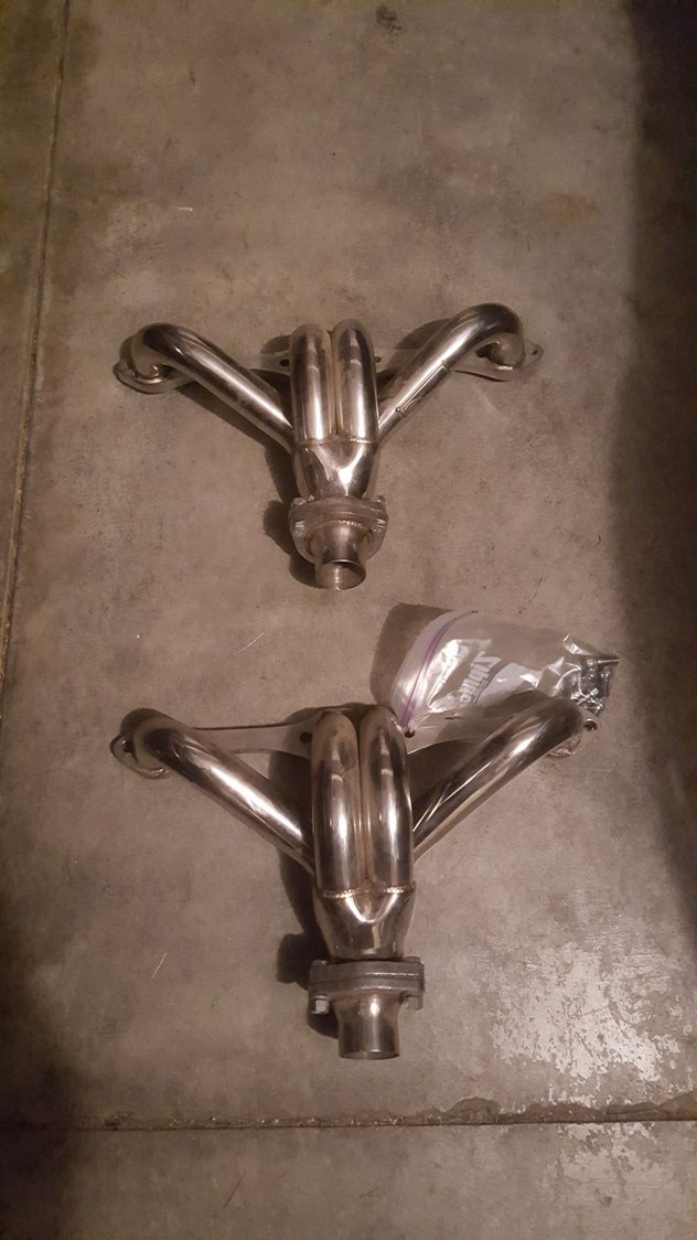

As an update I got the block hugger headers from my father. They are XSPower and appear to be SS. I really like them but have continued to read that these block huggers/shorties will burn up the motor mounts and plugs. Considering getting them ceramic coated from somewhere here in KC. Anyone have luck putting these headers on their C3 L48? Any done it without problems? My L48 does have A/C so that looks like the biggest obstacle for installment.
