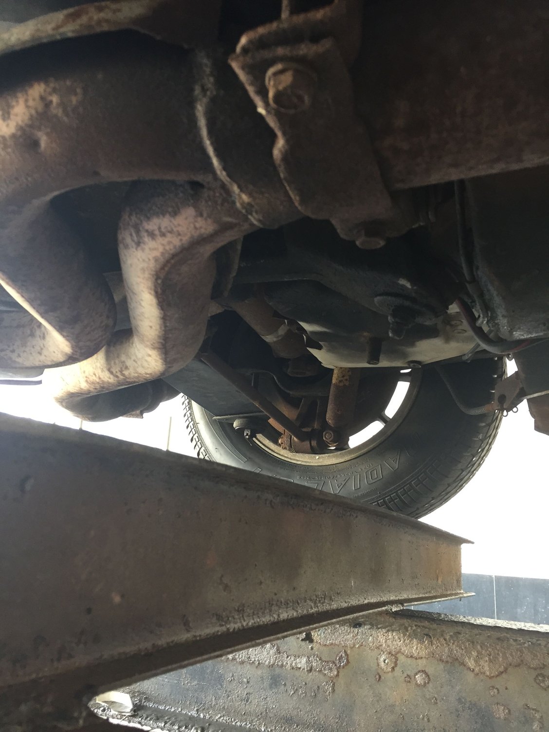

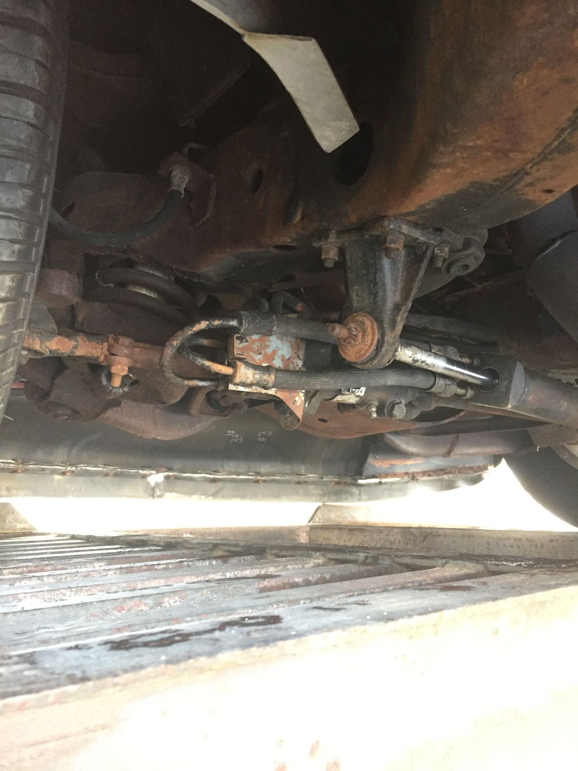

More photos:
Old May 3, 2017 | 11:31 AM
MelWff's Avatar
MelWff
Posts: 18,740
Likes: 2,583
if this car is in the middle east why all the rust underneath?
why is the engine coated with a fine dust, is that normal for the climate?
looks like none of the steering components have ever been lubricated.
there is evidence of over spray on the spare tire compartment, was the car rear ended?
shocks are old and bushings dry rotted.
the car from Connecticut and it's been parked for awhile... agree on the shocks and suspensions set rusty.. original color was silver it was painted red around a year ago... interiors been renovated that's according to owner.
Im hesitant to decide on this one looks like a lot of work involved. Any thoughts?

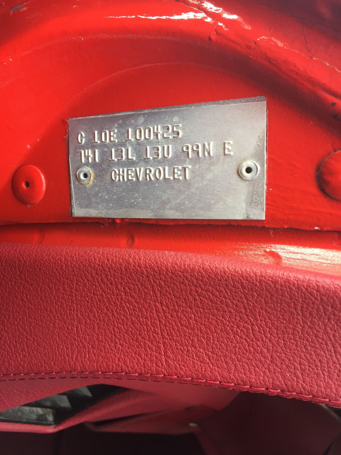

Originally Posted by ZEROVETTE7
...original color was silver...
FWIW: trim tag codes say the car was two tone silver and dark claret (13 and 99)
Yep I noticed.. Donno why would anyone tamper with originality!
Anyway as usual thanks all for the valuable feedback. Don't think I'll go with this one I guess one of the main thing in buying a C3 or any other vette is maintaining originality. Plus this one requires a lot of work and $ to bring it back to original.
