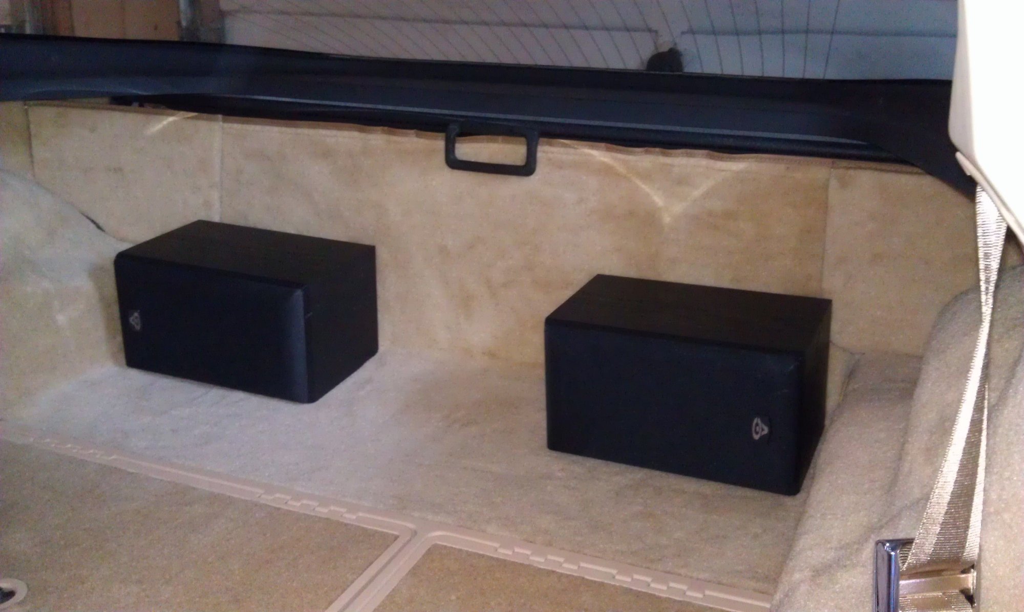

I just ordered a stereo and power amp for my 80, and want to hide the amp. I see a lot of guys just put it on the rear cargo wall, and I would prefer not to see it, so I was thinking maybe under the storage tray behind the passenger seat. (Where the jack is supposed to be.) I think it might fit there, but then I was a little concerned about heart build up.
Maybe I could use a sheet aluminum base for a heat sink, and it would be OK.
So I'd like to see where others have tucked their amps if you have pics, that would be awesome. The amp I bought is about 10x4x2 inches, 150 watt.

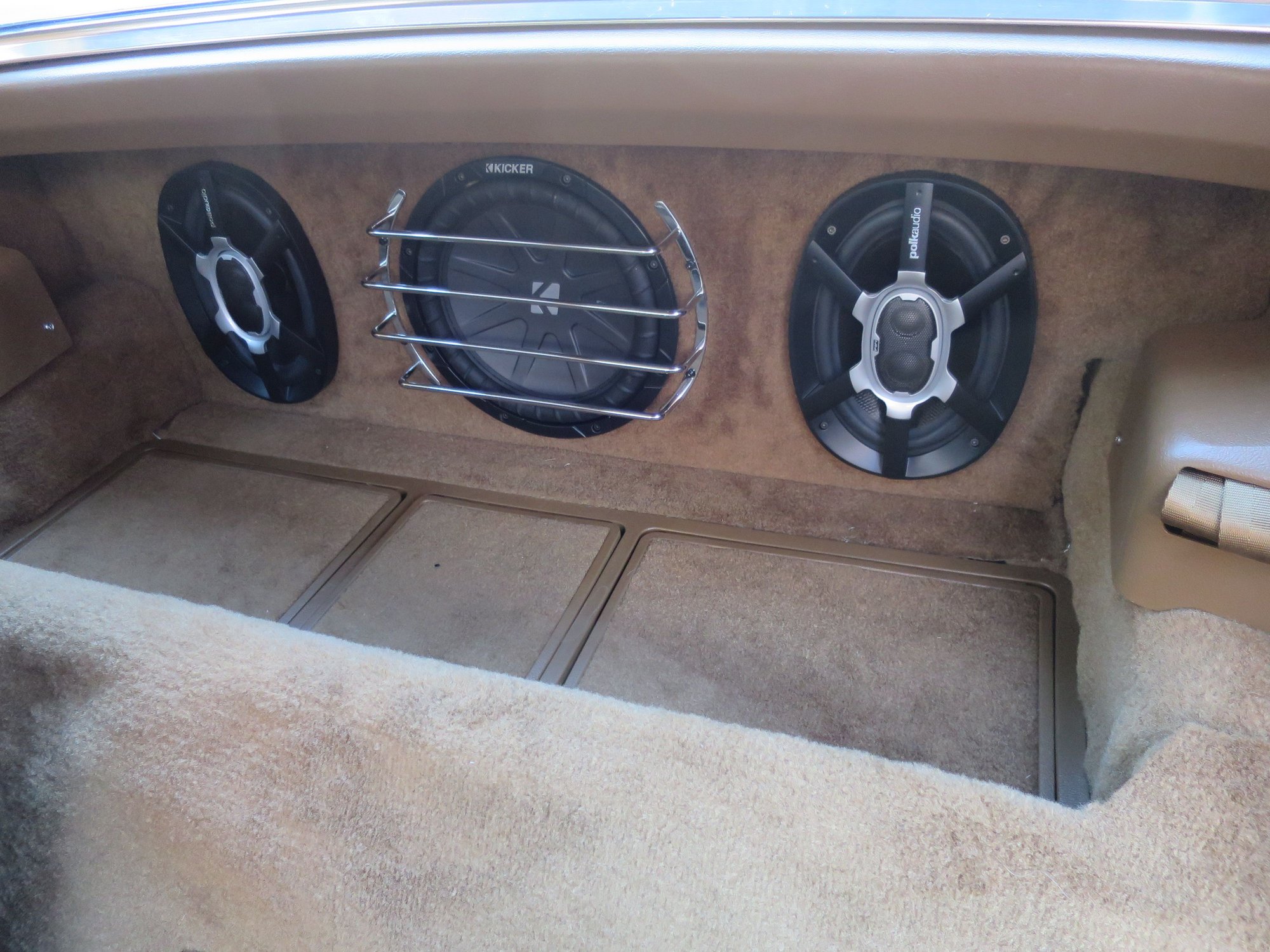

I mounted mine inside the right storage bay, behind the passenger seat. I dont think it is any hotter there than anywhere else. My msd 6a is mounted above it on the aft wall of the same compartment. 2 yrs and no issues. I've thought of running a little fan inside of enclosure, and venting it, but again. Nothings overheated as of yet. I built a dedicated speaker box that runs from fender to fender, I made the woofer enclosure per speaker specs, both 6x9's are also seperated from the woofer by panels. I used 3/4" mdf. I have speakers mounted in the kick panels too. Im using a retro sound model 2. All in all, its a nice little system. The photo taken is before I finished installing the compartment door, and wrapping up the carpet installation. But it gives you an idea of which direction I went.

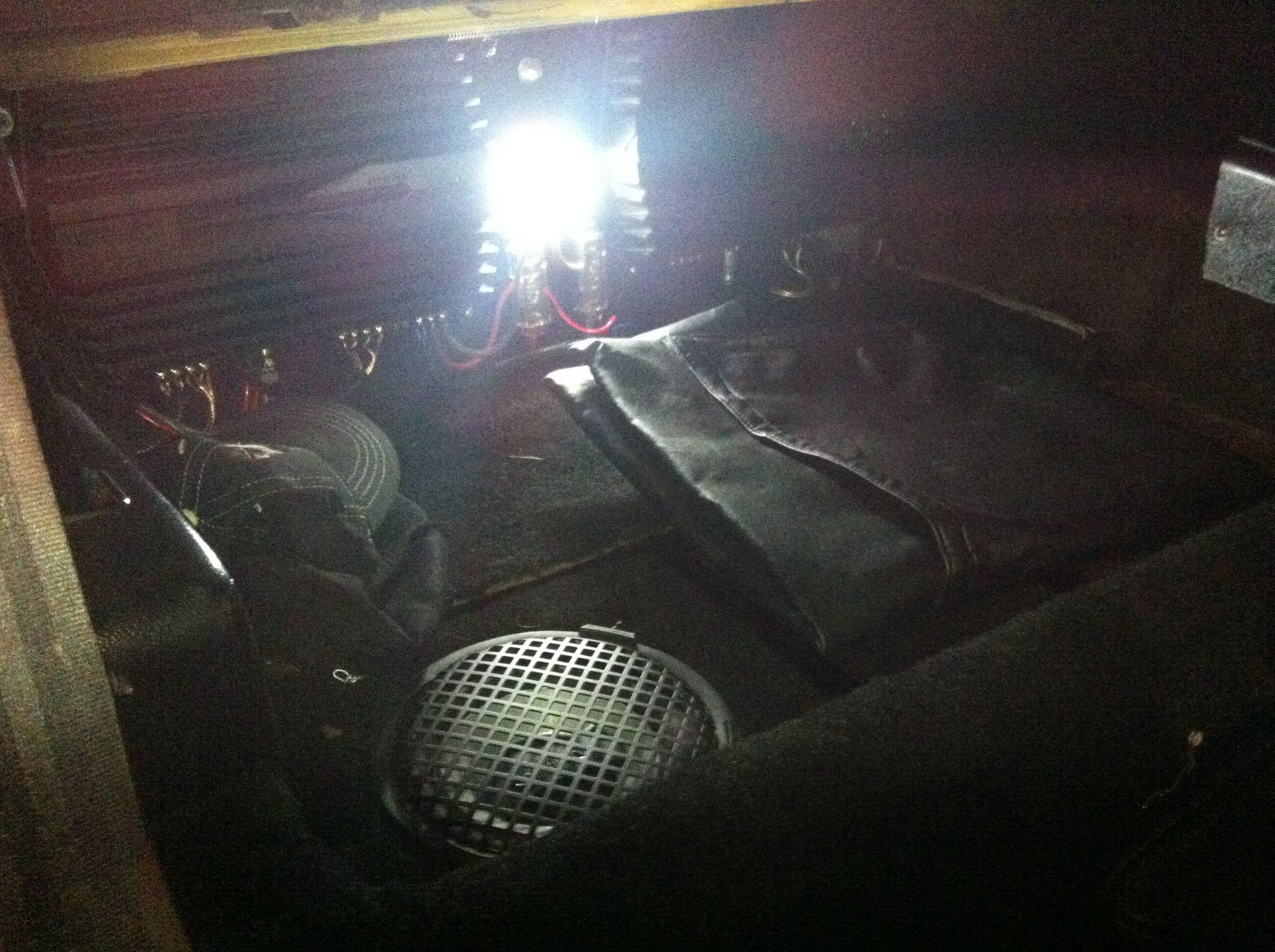

Heres the other photo I was looking for. Pretty much all wrapped up. except I fixed the area where the carpet is pulled back on the left side aft of the compt door.

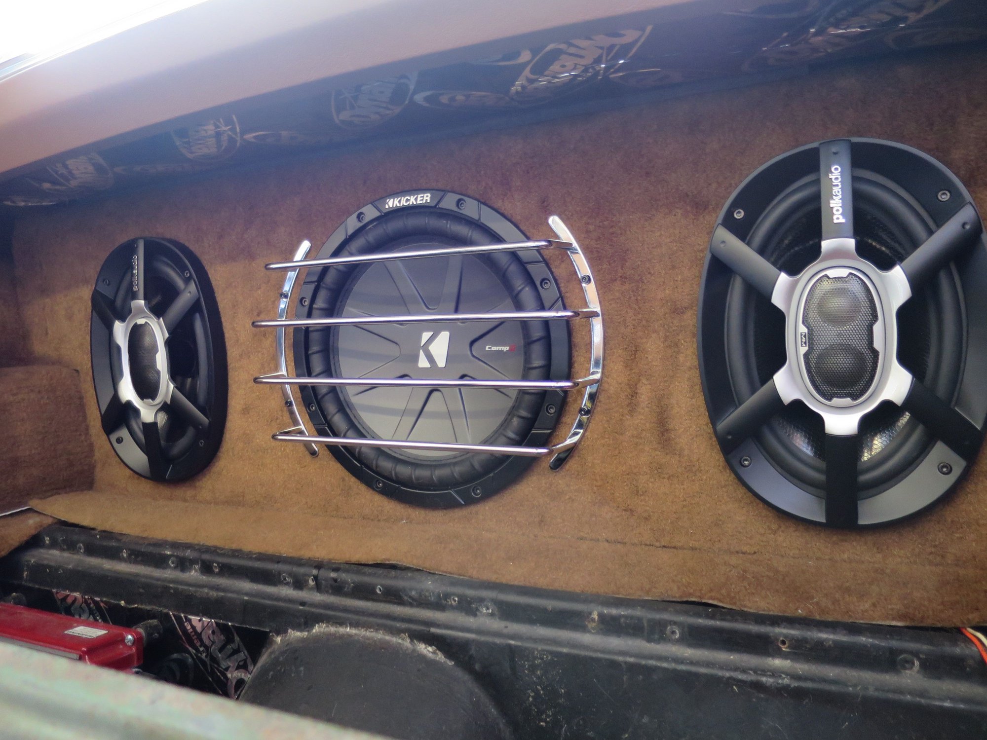

Heat was one of the reasons I put my amps on the back wall. Size of the amps was another. I also wanted to keep enough space to be able to put my t-tops in the bags back there. I also wanted a sub woofer in the car and there aren't a lot of places to put one and still keep the back wide open.
It may not be your first choice but it may be your best option.
In my 74 you can't see them unless you are looking for them, in your 80 the bubble window lights up the back a lot.
Sorry for the poor picture quality, I need to take better ones when the car is outside.
