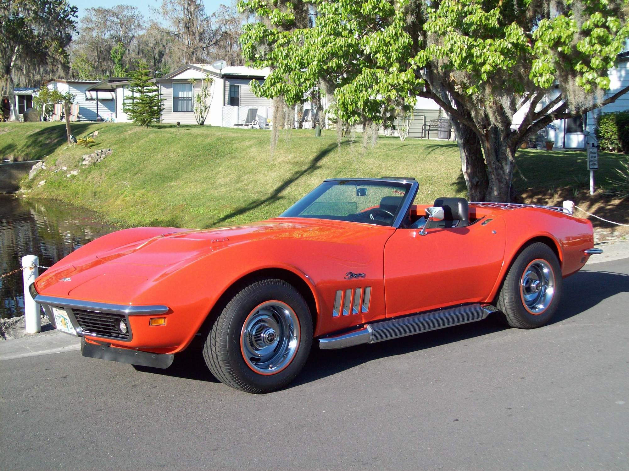

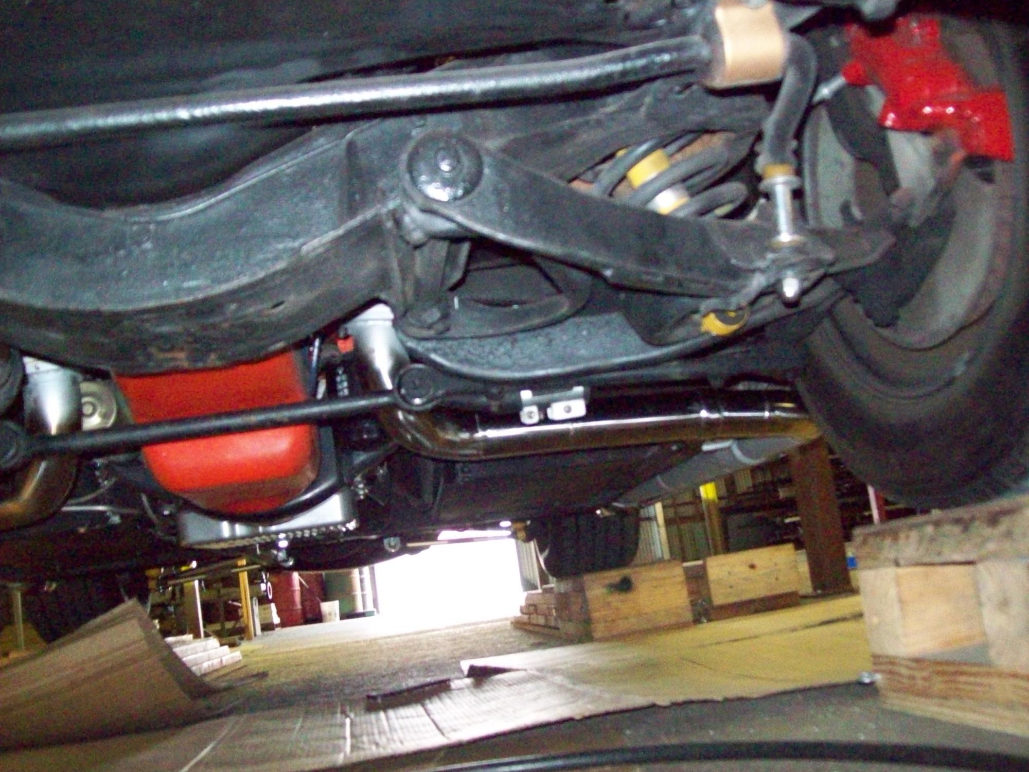

I am running the Classic Chambered Vette Pack on my 69 original side pipe car under factory covers. I also am running a 383 stroker motor, but with a few less ponies. ( only 439)
I like the sound and do not think it is too loud. My wife has not complained about them either. (Yet)
I have a friend with the full chambered muffler under 67 covers and his seems almost twice as loud.
My set up is shorty S/S headers with 2 1/2 collectors, 2 1/2 in. S/S pipe to the 2 1/4 in. Classic muffler inlet, the classic 20/20 muffler and Sweet Thunder S/S tips.
