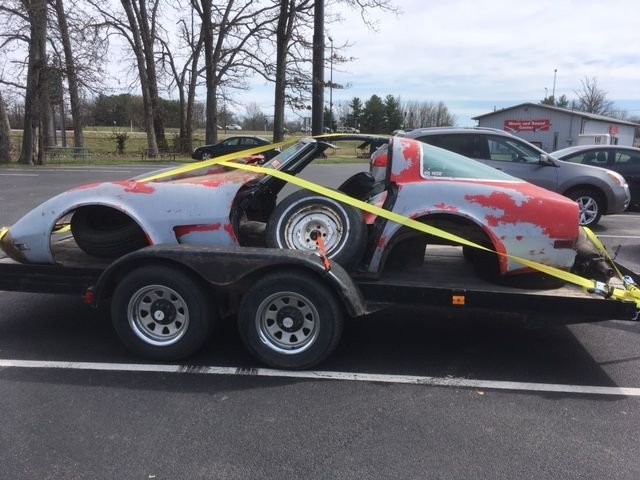

I'm making some progress on my '78 project and everyone seems to like pics so I thought I'd share some.
Bringing it home.
After I got it home and in the garage I spent several days doing inventory on what parts I had. I was well aware when I bought the car that it was missing a ton of parts since the previous owner had turned it into a drag car.

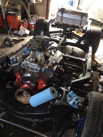

More progress has been made on my '78. I got the motor done finally and dropped it in the chassis with the rest of the drive line.
Just finished the bottom end
Test fit the headers
No pulleys yet
It's a gen 1 350, ported 487x heads, single plane high rise intake, holley 650 spread bore, stage 3 cam, roller tip rockers, flat top pistons, and side pipe headers. I didn't have to bore it out thankfully. Overall, my total cost of the engine, including the purchase of it is around $700. I'm not counting accessories like the ps pump and alternator.
I got a great deal on the ps pump and brackets from a gentleman on ebay. The alternator brackets I got at summit for around $30, and the alternator and starter are autozone cheapies. The only thing I had for the motor that came with the car when I bought it was the radiator, which was in bad shape to begin with. I plan on replacing the radiator before too long with an aluminum radiator. I fixed the original radiator just for testing and tuning purposes, though I met a guy a few months ago who restores these harrison radiators for corvette resto shops.
My next piece of the puzzle to tackle is the steering column. I knew mine was in bad shape but after pulling it apart to replace the turn signal harness and key cylinder I found a lot more damage so it's getting a full restoration now. I'm also working on getting the body ready to go back on the frame, but still have one more floor pan to repair and a lot of fiberglass work before then.
