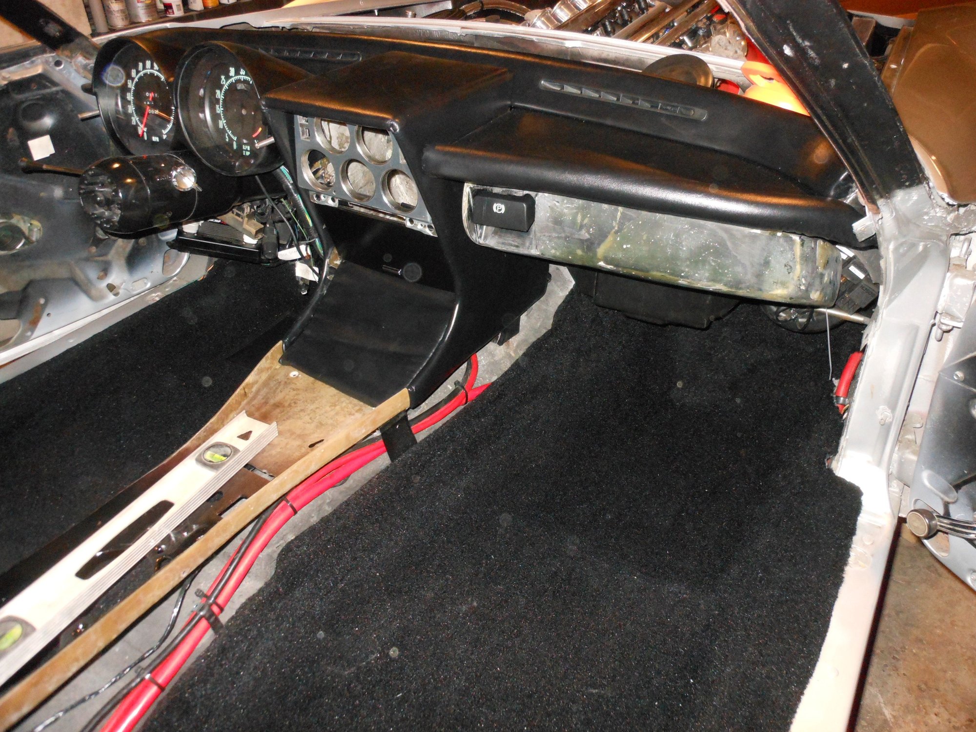

I did the e-stopp electronic parking brake-
One you get rid of that - you have a lot of room.
Mine's just a little over the top...
electonic E brake
I'm mimicking a Lamborghini Miura-

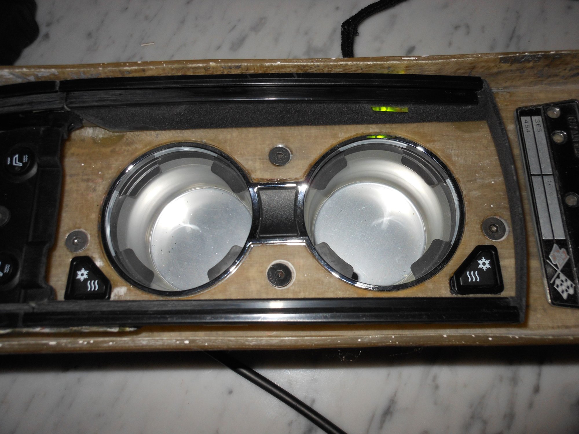

Console- will have armrest- will fold back to access cupholder
electrically heated and cooled cupholder - out of an Escalade
Wood slide- off a Volvo S70

Do look at the early 90's Mercedes-Benz 300/500/600 SL- model R129
The console is skinny- under 6 inches so it'll fit between the seats in a C3.
All the other cars I looked at were a lot wider- and you'll see in the pic that it would be one of the easier ones to fit as it uses carpet covered panels on the side like your 78.
Good luck-
To Center Console
