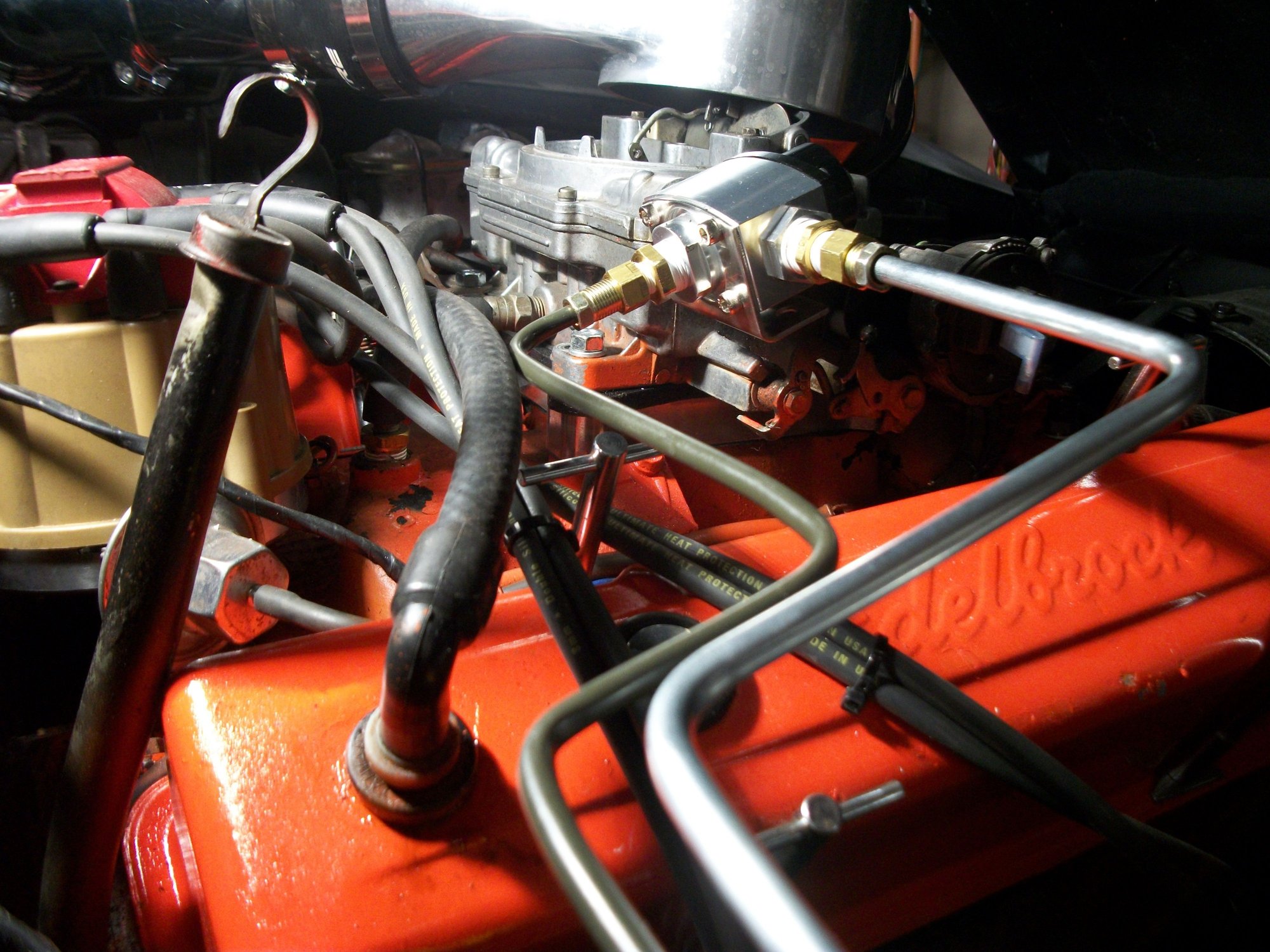

In that case.....since my project was a basketcase/the fuel hoses were rotted/fuel pump was failing, I replumbed the underhood fuel lines to a "cooler" location/added a fuel pressure regulator to bring the (lifetime warranty) 10 psi electric pump (I bought an OEM electric fuel pump rather than a $50 "throw-away" pump)down to 5 psi and installed an EXTERNAL electric pump at the gas tank.......
