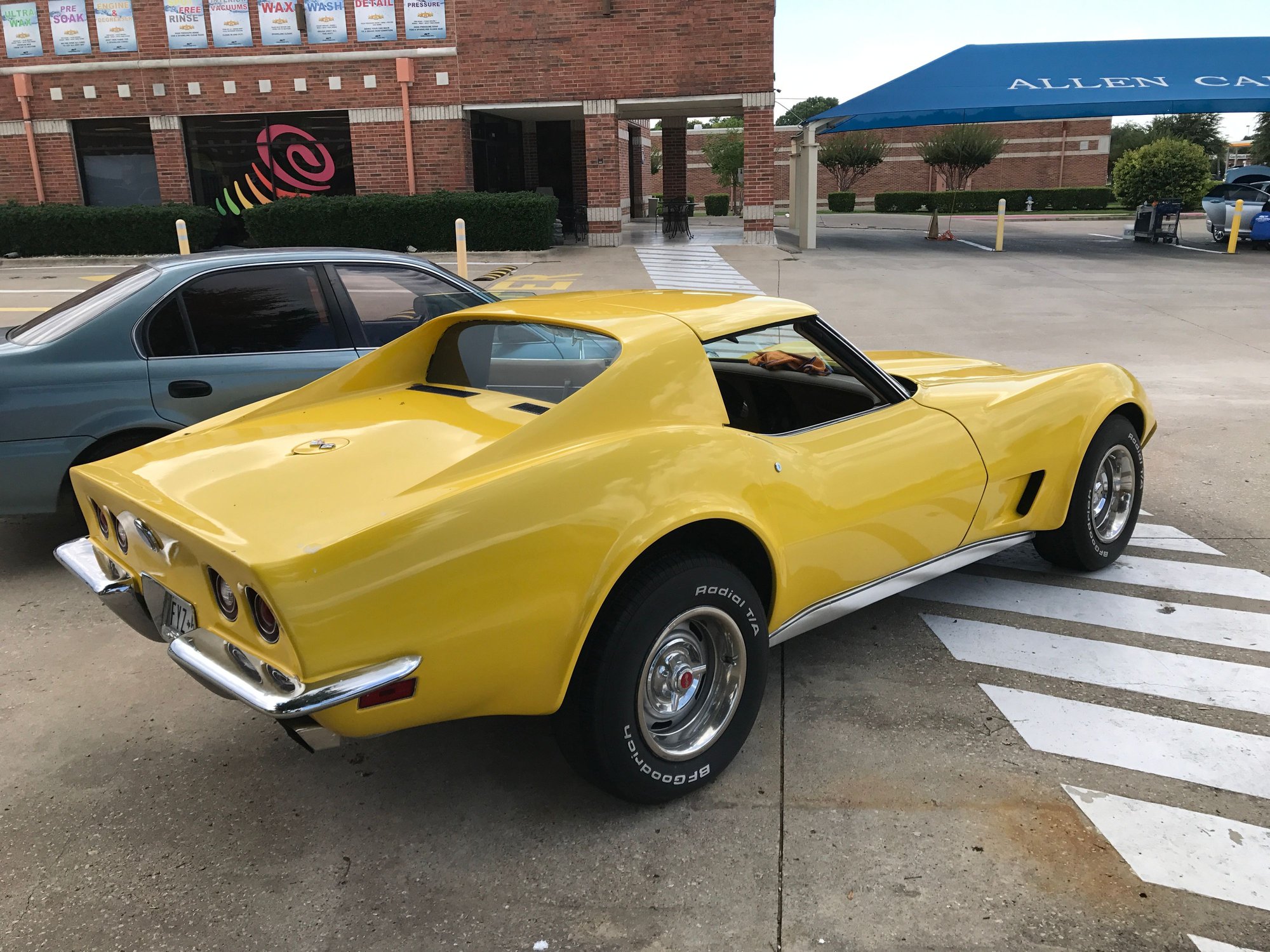

C3 n00b here. Apologies for my virgin post being so long.
I've been in the hunt for a C3 for a good while, never all that serious, that is until a co-worker decided to take me up on my "standing offer" to buy his L-48 '77 (dark blue w/white interior) for around $7500 (yet to be actually negotiated). At which point I decided that if I was going to spend $8k, I needed to see what $8k could get me nearby.....and I found a '73 that I would like some feedback on. I love that chrome bumper, but not enough to make it a deal breaker.
First things first, it was originally dark blue, but was repainted at some point to yellow. Second, it's an L-82 car, but the motor is not the original. It's a nicely rebuilt 350. I know the chrome won't get me home, but it does appear that the guy who did the work took the time to do a good job. I've driven it twice, and it is strong and fast. Definitely more power than my buddy's L-48. I know what NADA says a 73 can be worth, but I'm unclear just how much to deduct for a non-original color & non-numbers matching engine.
Tomorrow I'll have receipts of all the work he's had done. Things mentioned include a new rear leaf spring, "suspension stuff," new bushings all over (unclear as to what extent, I see two rear body mounts were not replaced), and an alignment.

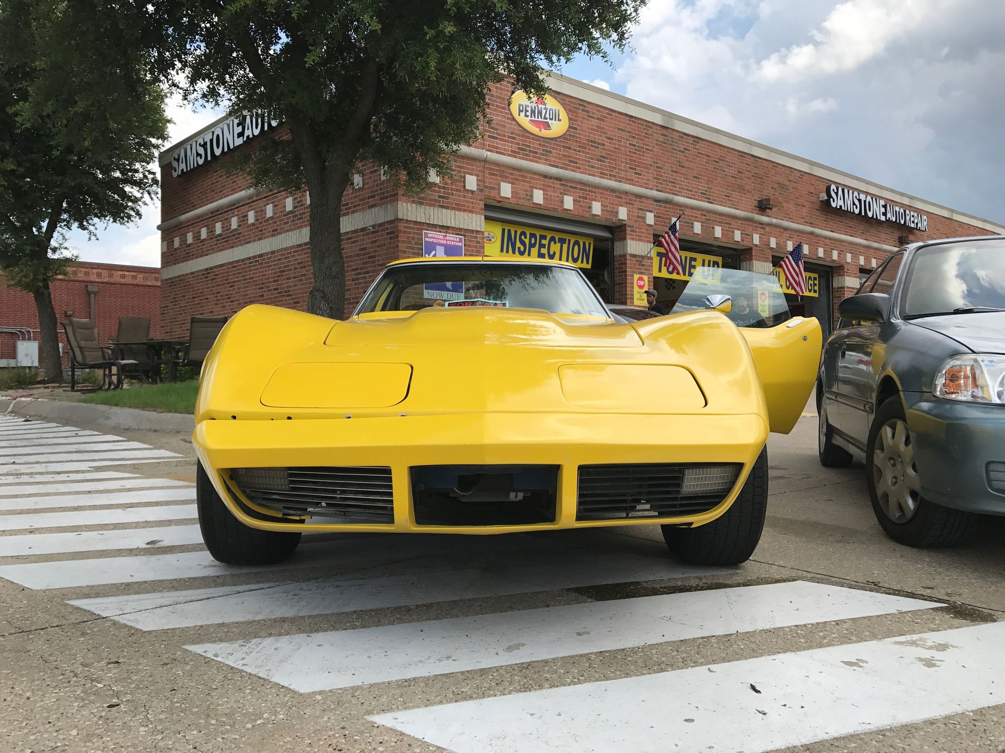

Known minor(?) issues:
emblems are all wrong/missing
headlights hiss when I pull the ****, but no action.
wipers kinda sorta move, but MAY be bound by the edge of the hood
fan does not work, I think the heater core is MIA.
no horn.
Tach does not move...probably related to the MSD ignition the PO put in.
door panels don't fit well on the doors
cowl vent on the hood is quite ghetto
front bumper is only half attached....it appears like it's a simple matter of bolting it back together; the fitment looks OK, but why display the car with that easy fix left undone???
hole where the antenna used to be
some interior trim doesn't fit quite right (pictured the panel aft of the drivers seat, passenger side looks similar.
fuel gauge doesn't appear to be working (or I've test driven it on E)
**no clue how to open the gas cap**
And the biggie....Needs new weather stripping. The car is currently sitting "on display" in a parking lot at the guy's shop. We've had a bunch of rain lately, and the carpet in the floorboard & behind the seats are quite wet. The seats don't appear to have any water damage. My understanding is that 73's had fiberglass floorboards, so rust won't be an issue there. I would be replacing the carpet anyway, but what other problems could be lurking as a result of this? Like under the rocker trim?

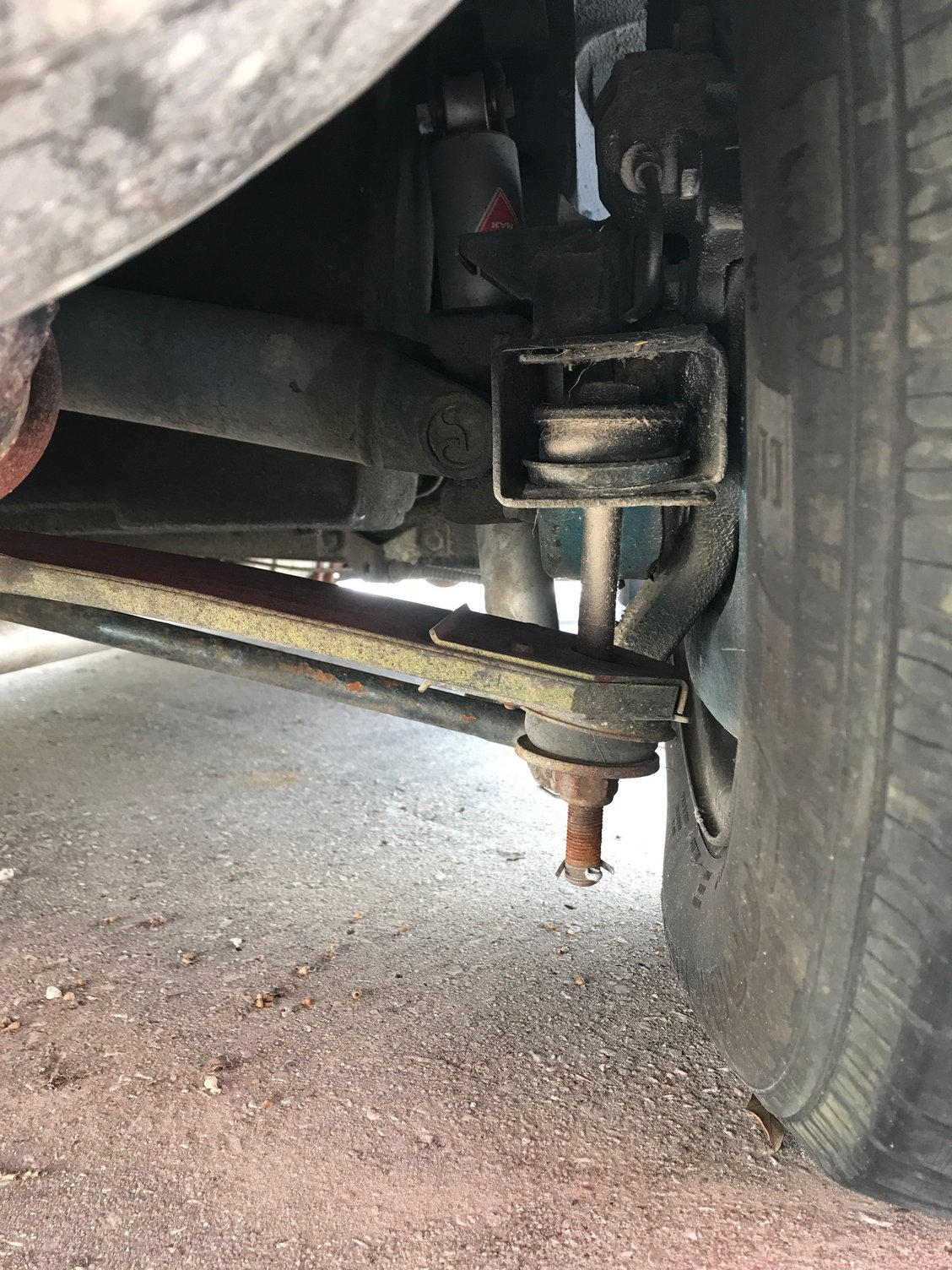

From underneath, the thing looks SOLID. I see zero evidence of rust, although I have not looked behind the kick panels yet. I've knocked on various stuff underneath, and it feels & sounds solid too. Drive wise it started up pretty easily, seemed to hold steady around 210-220F even today as it was 100deg outside. The steering is a little iffy; the wheel has some play before it makes the tires turn, and the car likes to wander a little bit. I took some gentle curves on a smooth road at about 65mph....I wouldn't say this thing was on rails by any stretch of the imagination. I'm not sure how well I should expect a car this old to handle, though.
Guy is asking $9k. There's not a 73 on the internet less than ~13k, this seems too good to be true...and it probably is, I'm no dummy. Maybe the paint & engine devalue it more than I realize. My biggest concerns are (a) what am I missing and (b) what will it take to deal with the things that would make it fail inspection [horn, wipers, lights, etc].

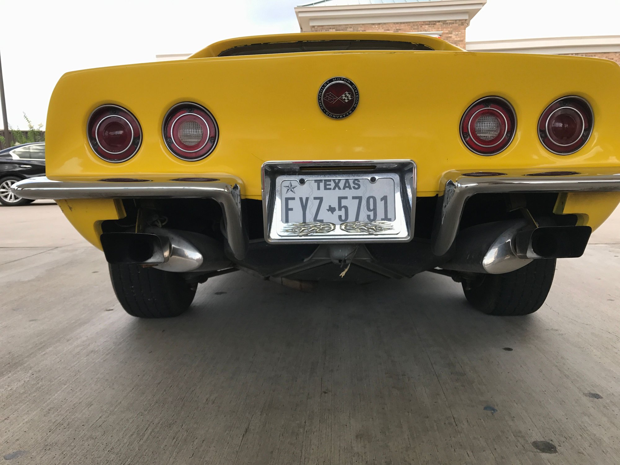

rear
Interested to hear thoughts. Thank you in advance.

If I were you I'd pass on this one. As others have mentioned it's going to take a lot of money to get the car just in decent shape. I see many things missing just at first glance.
No heater hoses.
The hissing you hear when headlight switch is pulled means vacuum leak or disconnected vacuum line somewhere! UGH!
No wiper/washer hoses connected to the wiper motor pump.
No lower rear valance.
Definitely wrong exhaust. Probably why valance was removed!
No security keyway on rear deck. (Covered up with front logo).
Corvette letters missing on rear end and holes filled in.
Lower front valance is also missing? So right side grille area not attached to anything. Not sure what the other side would connected too?
Steering wheel doesn't fit well, thus no horn. Probably wiring is disconnected.
The vent pulls on lower dash are missing/ as is the left side vent ball. The pass. Side vent ball doesn't have anything inside of it???
Many interior pieces are missing, and existing pieces don't fit well.
To me I'd be really Leary of water damage else where, the foot well carpets look black like they've been under water !!
For all the money you'll need to get this one together you'll be in it for way more than a 73 coupe is worth. Especially with a NOM engine, wrong color repaint and an automatic.

I see what appears to be a crack in the fiberglass coming from the upper left corner of the rear license plate bezel and perhaps a crack along the upper part of the ducktail or at least bodywork that doesn't look right. Also crack/separation at the driver's side B pillar. I'd wonder what other cracks/bodywork problems will appear in time (and perhaps not a lot of time).

In the picture of the rear it looks like there is a seam right below the top edge of the ducktail. Maybe a replacement panel after a rear end accident. May want to check the frame for any accident damage.
As much as I love 73's, I think I would stay away unless you can get it for about $4000. The general rule of thumb on these cars is to buy the best that you can afford.
Tom...
That's what I said.
The left corner of the license plate is a strand of something...I tried to pull it out but it was caught tighter than I felt like pulling. It's not a crack. The center of the ducktail is just some discoloration, I think it would buff out. Directly above the right reverse light is some not-quite-matching touchup paint. You guys have good eyes.
