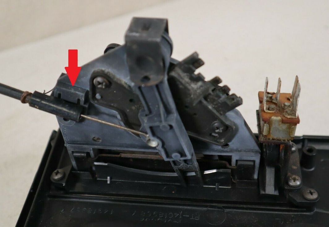

I will also add, that the vacuum switch for a Late 1979-1981 is visually a different switch.
I like the later switch much better because the travel required to activate the vacuum switch is much shorter.
And you can actually carefully open the switch for cleaning and to re-lubricate the inner spool using Vacuum Grease.
The short vacuum line on the right "I" attached to this switch is showing vacuum in.
The center port (when button is pushed in) is the vacuum signal to the hot water shutoff valve in heater hose.
The left off center port is the exhaust port.

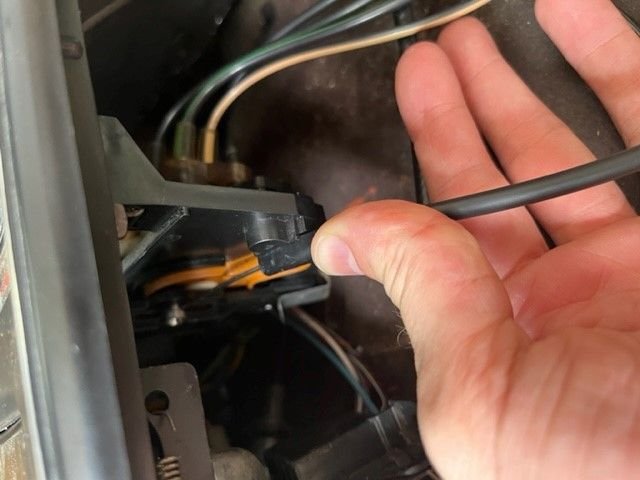

Thank you for your input. When I pulled the glovebox, I could see that when I moved the temp control it did not move the cable at all to shut the valve.
When I saw this, I notice that the cable had come detached from the HVAC control at the point where a plastic tab slides into the HVAC control and serves as an anchor point to allow the cable to move within the plastic housing. When I held the cable at that point and moved the trmp control it would shut the valve.
As I see it, I will have to replace the HVAC control as I am sour glue will not hold and may damage both parts. See pictures.

That stinks. Hopefully you can find a decent used one that’s not too pricey.
fwiw, I’m guessing someone in the past got aggressive with the lever trying to shut off the heat and broke the attachment point. Exactly the problem I was trying to avoid with my “upgrade”.
Best of luck, let us know how it works out.

I looks to me the plastic slot where the tab of the cable slides in has broken off.
See if it didn't fall under the carpet or surrounding are, then try a good 2 part epoxy made for plastic.
Broken slot may look something like this.

Yea, that someone was me a few years back. I have owned the car for 22 years, and while adjusting the cable to shut off the valve behind the glove box today idiot me was not paying attention and pulled the metal ball off the cable where it attaches the temp controller. I have ordered a new cable and HVAC controller from Ecklers this evening, expensive for what they are but if I could even fix what is broken, I would be afraid it would not hold, and I would have to take everything apart again.
I'll keep everyone up to date.
