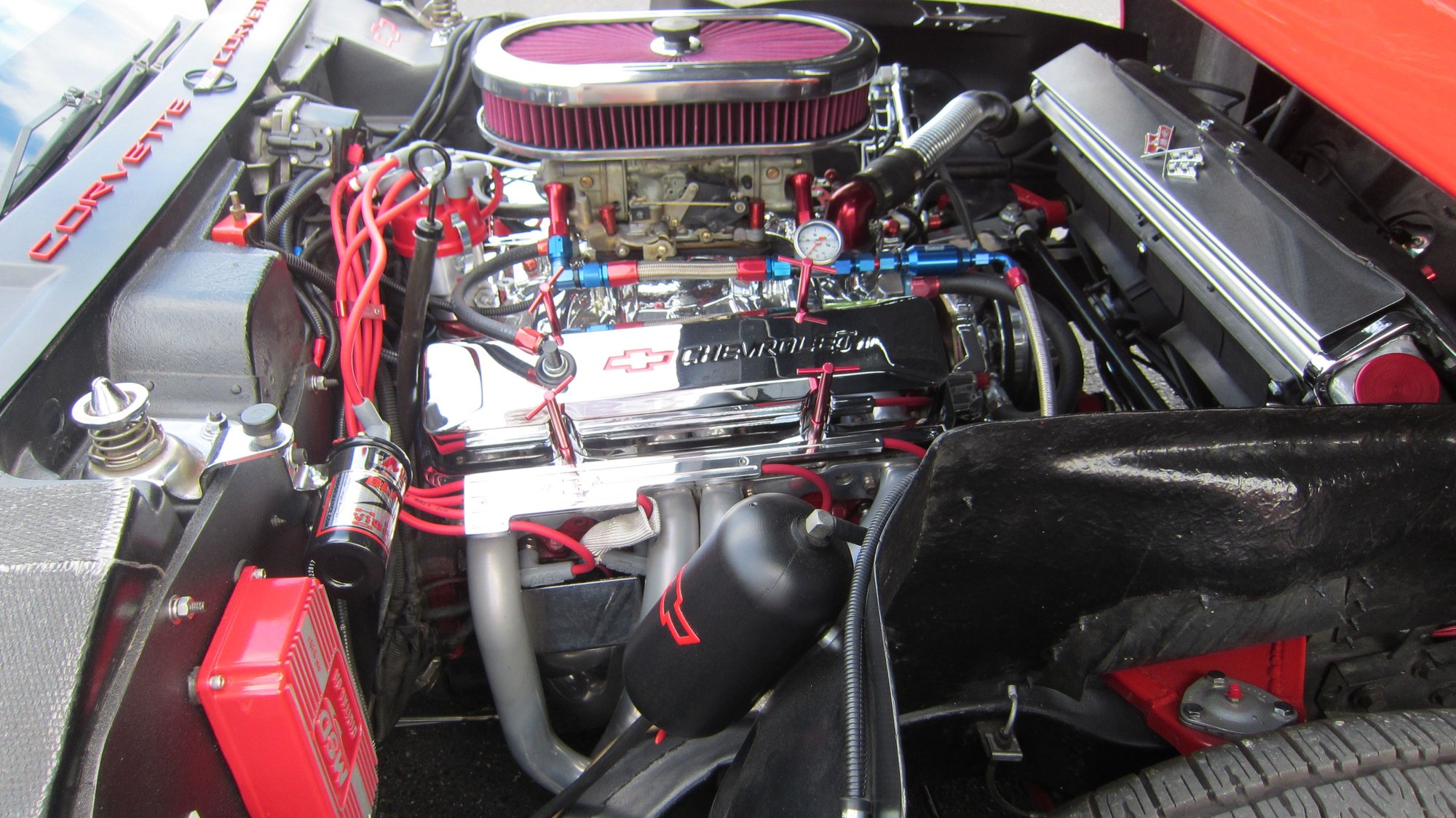

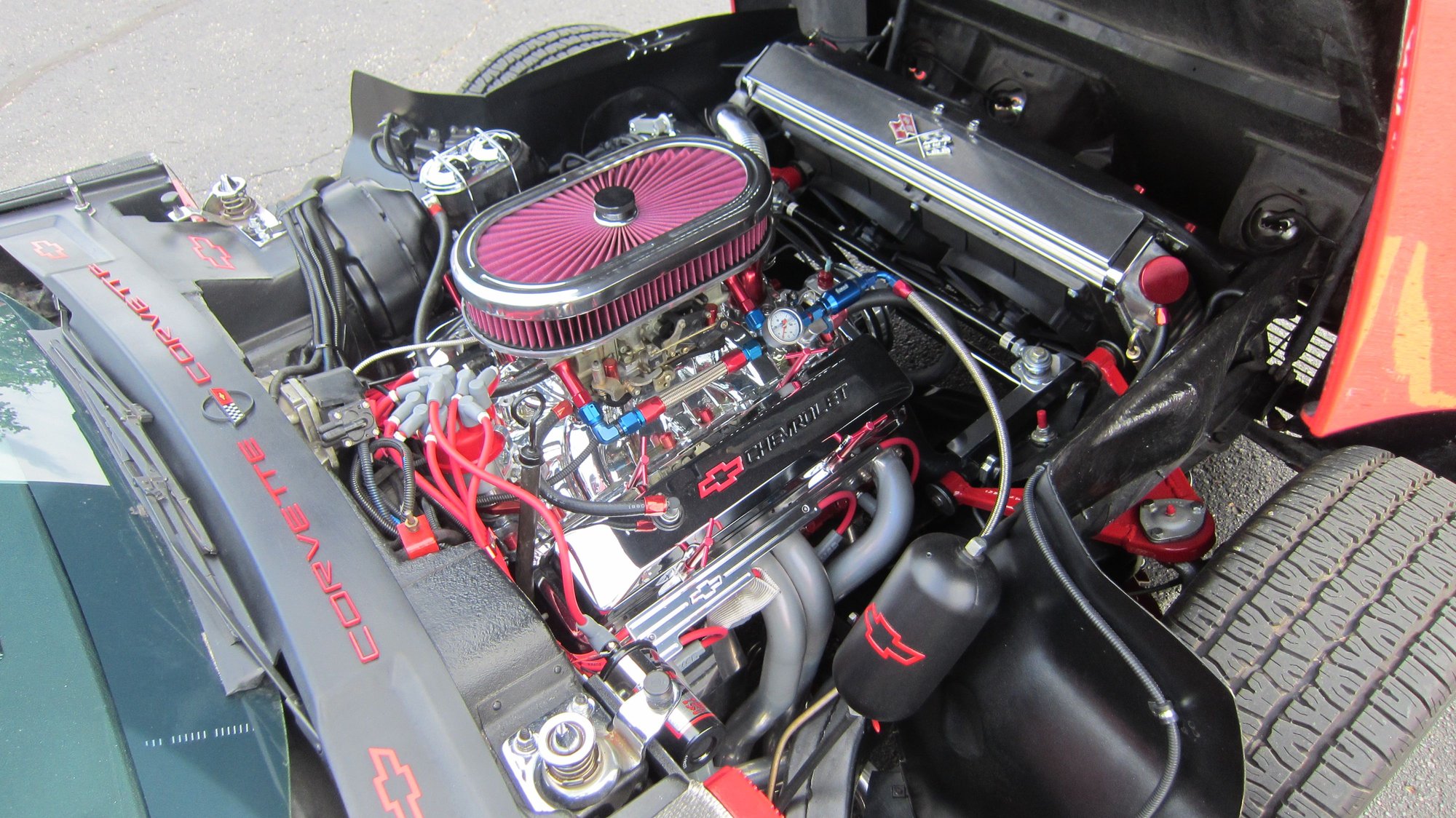

I bought the Endurashine, i love it, if you like shiny this is for you.

Very nice engine bay,
Is it as easy to keep up and clean as they advertise with no polishing?
Edelbrock's tech people told me it's basically a bright silver powder coating with clear powder coating over the top.
Have you had any issues with the finish?

No problem keeping it clean, i just wax it once in awhile but what i did find is it's NOT IMPERVIOUS TO GAS, imagine that on an intake manifold. i had some standing gas on it that I wasn't aware of and when i went to soak it up and clean it a strip of like plastic came off it ARGH! Just a lil spot down by the front bolt but it turned a dark color! Not that noticeable. I also bought the Endurashine water pump which i've had no problem with.
