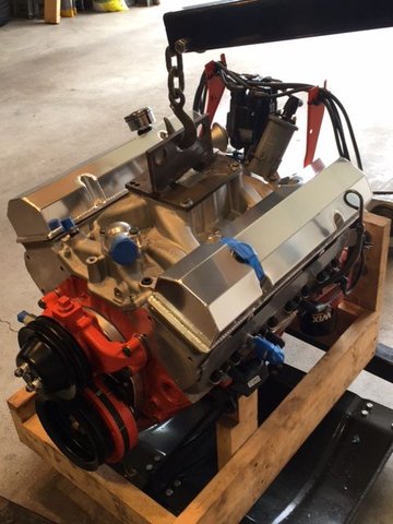

Not the greatest pics but this is also a 383 with rollers and the tall valve covers. The bracket came from either summit or jegs.

Terry.....thanks for the picture......I believe that may be the bracket we ordered on Monday.......glad to see it works. MY husband sent off for it because it looked like it might work......the description suggested it won't work with over-sized
valve covers yet the picture suggested it will work with the modestly taller covers on this engine......looks like you may have the same motor I just bought for my car.
It's the Blueprint 383 with a roller cam. It'd be nice to get it fired up ..... the 456HP promised on the dyno sheet that came with it suggests I may get more go out of this than the promised 430HP......either way it should be better than the 355 HP ZZ4 it's replacing.

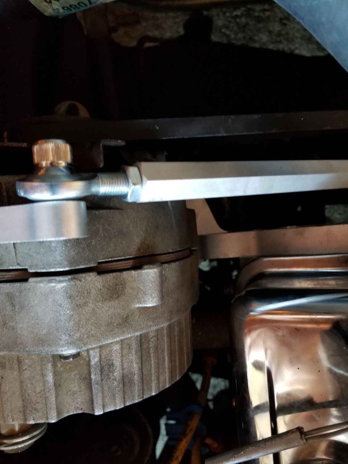

I installed this same Summit bracket on mine, but had to cut and lengthen the tension bar on the top as there was not enough adjustment to get my belt tight. My valve covers are tall, but fabricated aluminum, so wider than yours. My starting point when installing a belt had the alt swung out further. Otherwise, nice bracket. The belt does run between the PS pump tank and pulley, so no interference there.

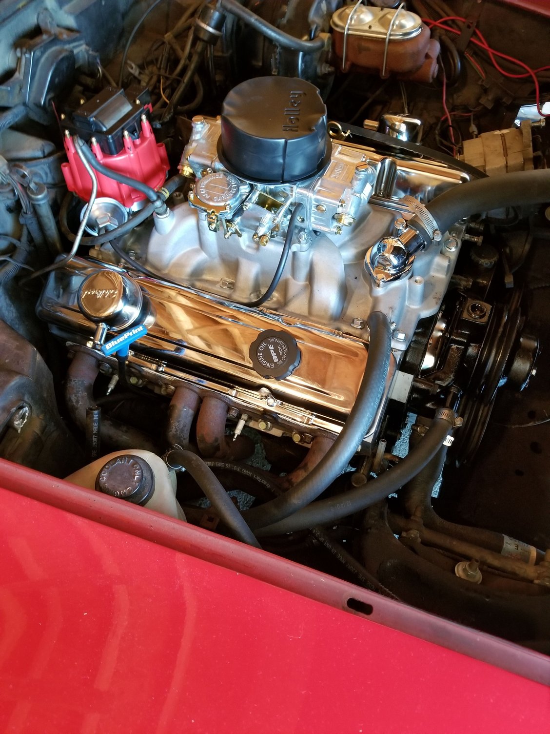

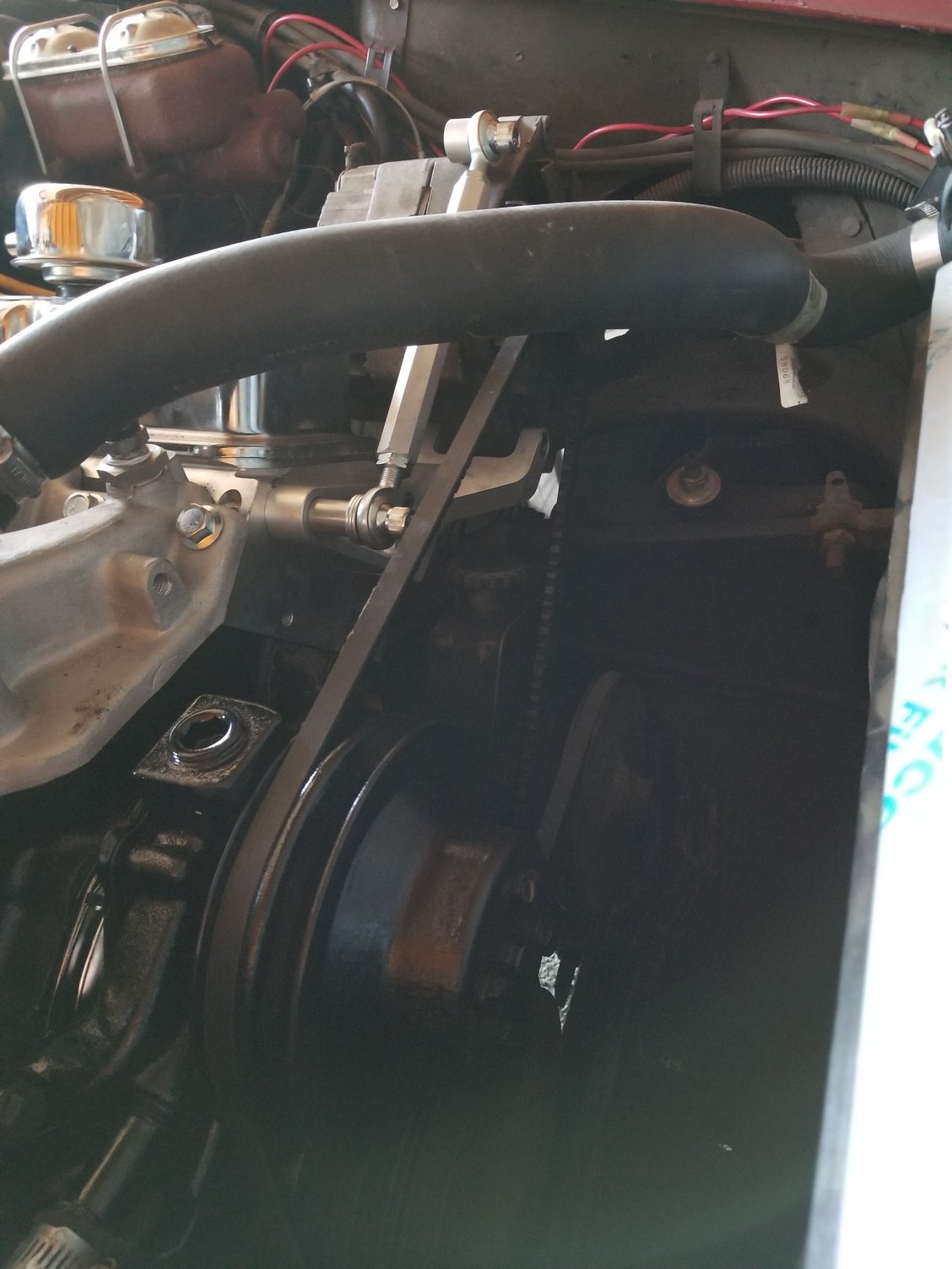

OK....looks like I did get the same bracket......it worked perfectly..... for anyone needing a similar "fix"......https://www.summitracing.com/parts/sme-2001
Plenty of room and no interference with the power steering bellow......the only modification required was a few extra washers between a too small spacer and the mounting to the head......this may not required with stock iron head or heads from another aftermarket maker of Aluminum heads.....but in my case this gets it done until I can pick up a spacer just a bit wider than the one that came with the mount. Overall though......it's a big win. Get's the job done, looks better and adjusts more easily than the stock bracket.
