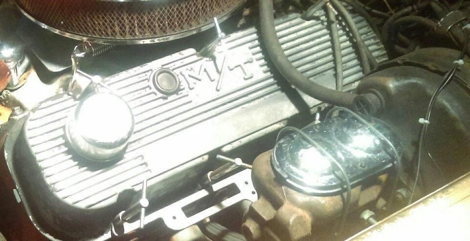

Hi OldCarBum,
Here are some pictures of my set up on a 69. The brake boosters are probably similar. I believe these covers are original to the car, the engine is not. It’s a stroked 71 454 with roller rockers . Looks like someone cut the casting flanges for clearance.

Originally Posted by Gold Dragon
Hi OldCarBum,
Your valve covers are good ones. I had a set of those on a boat several years ago. Thanks for the photos and the info. It gives me a good idea of what will fit.

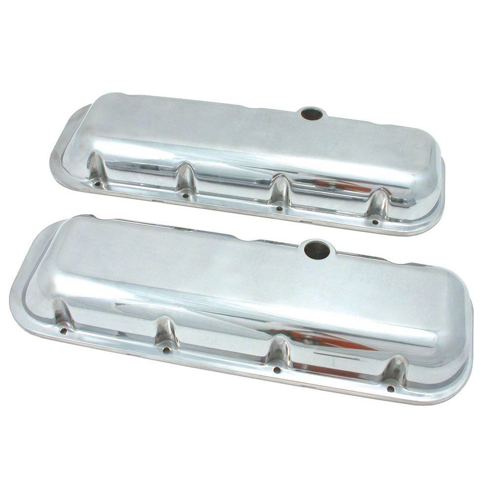

I found these polished cast aluminum through Spectre on their website. Come with baffles installed. They are on my list.
