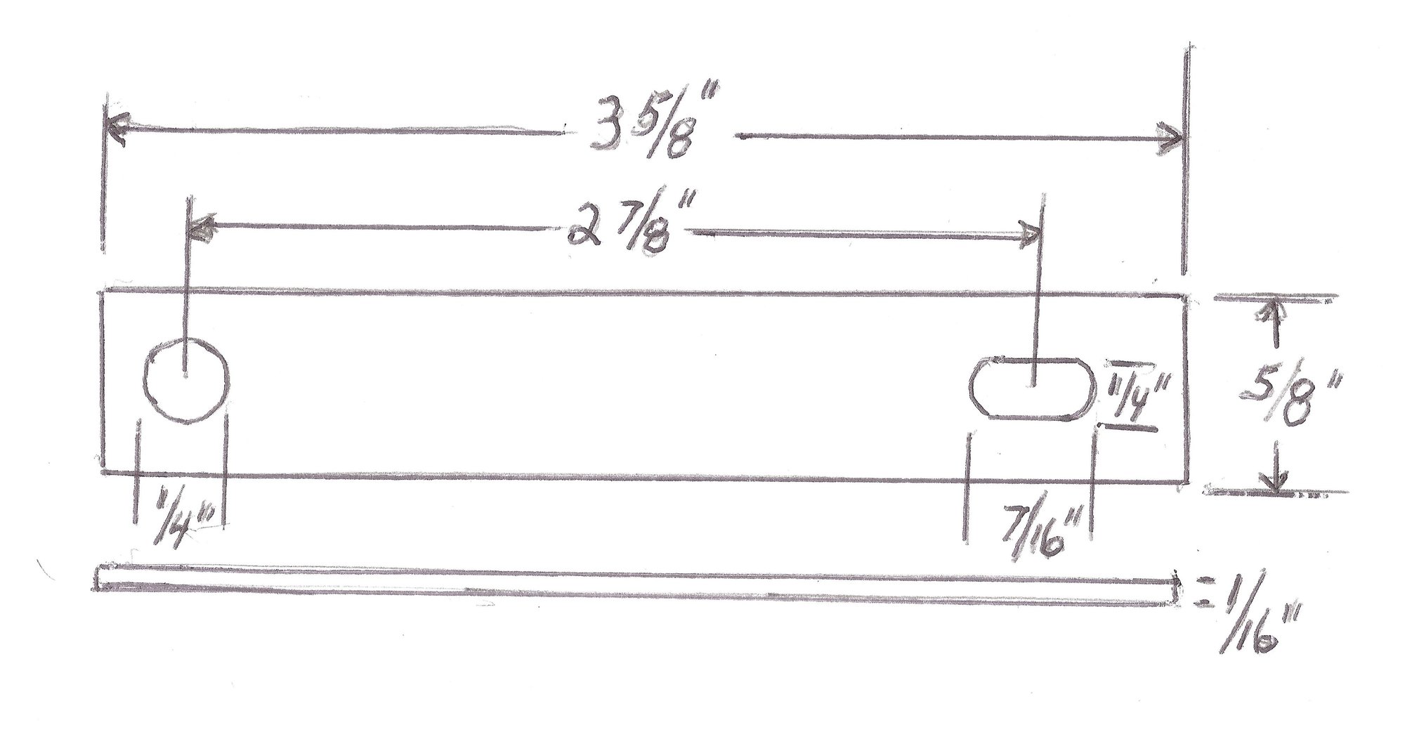

Do any of you fine gentlemen know the hole to hole measurement of the flat support bracket that goes from the bracket mounted on the transmission hump to the stud on the radio. My radio is the stack digital face model, if it makes a difference. I am putting the stock radio back in. It came separately with the car, but not with the bracket. I took an aftermarket Pioneer deck out of it. Thanks for any help you can provide me.

69ttop502 was so kind to send me that bracket that I thought it only proper that I should post the dimensions of it on here for anybody else that may need one. It would be very easy to make it.
