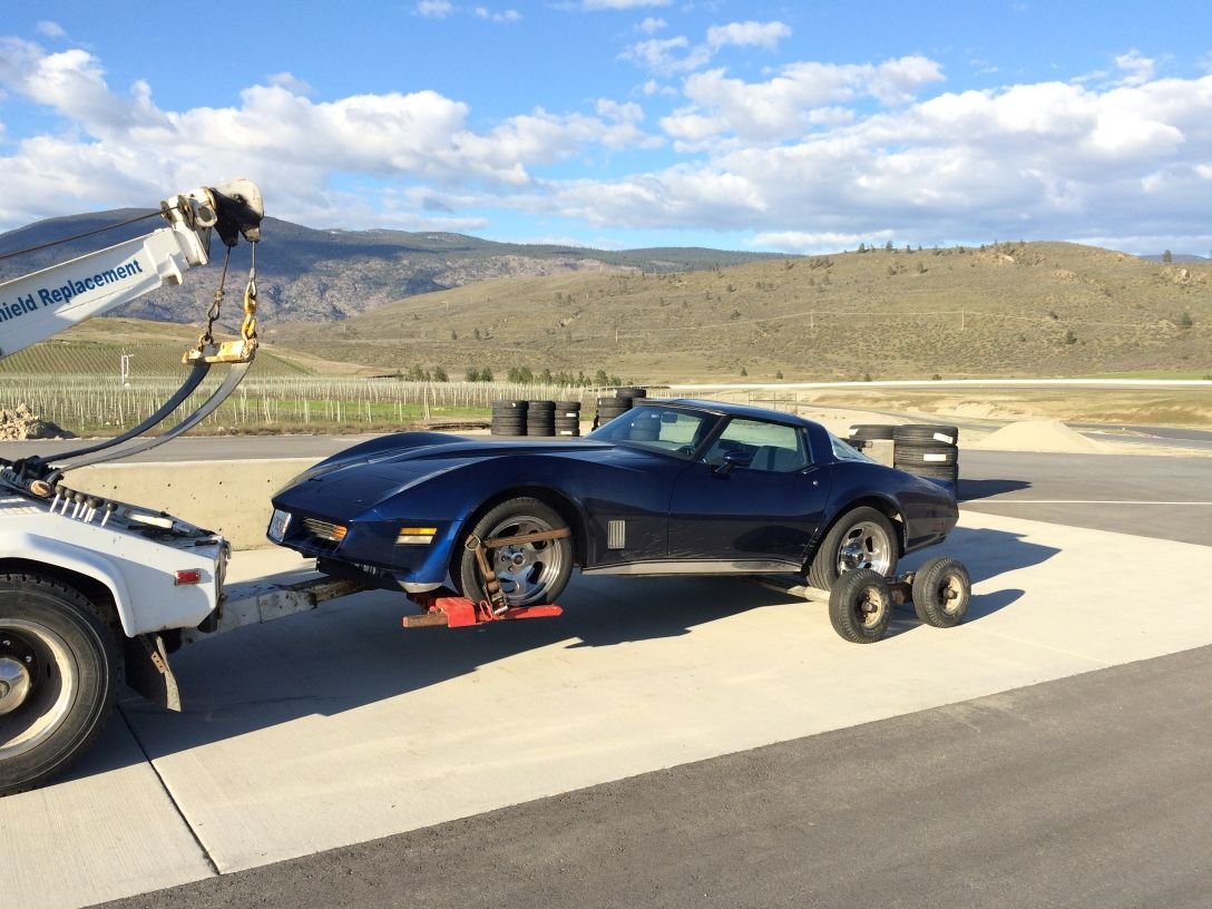

When I blew my engine at the track last spring I was lucky that the gentleman that came to my rescue knew exactly what to do; he owned a C3 a long time ago.
