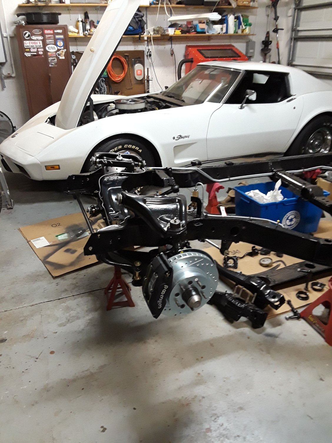

I got them on front/rear on my C2 (Same brakes)
OP question "Do I need these?" NO probably not unless you race.
BUT they sure look GOOOOOD
George
To Wilwod calipers.
