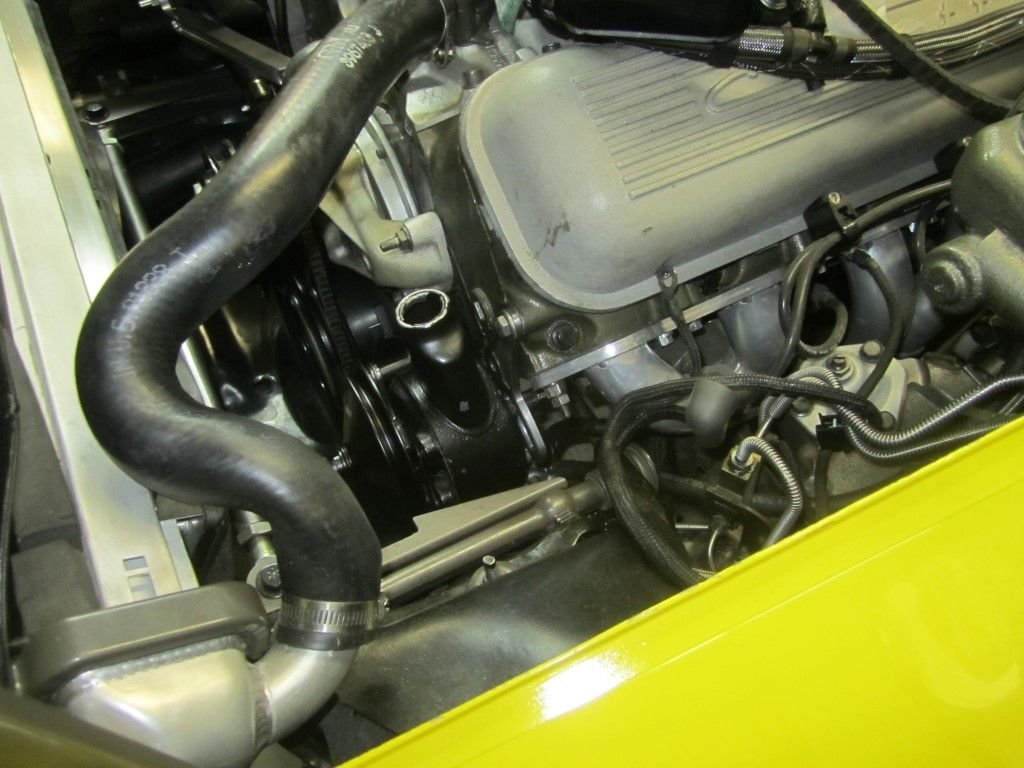

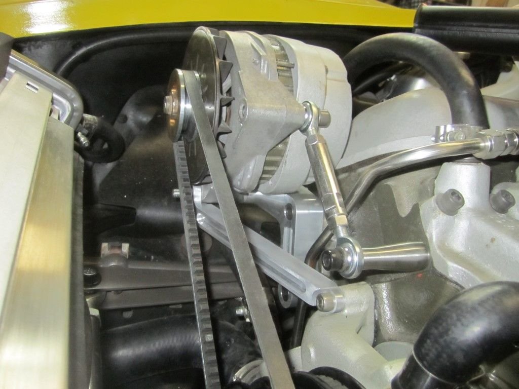

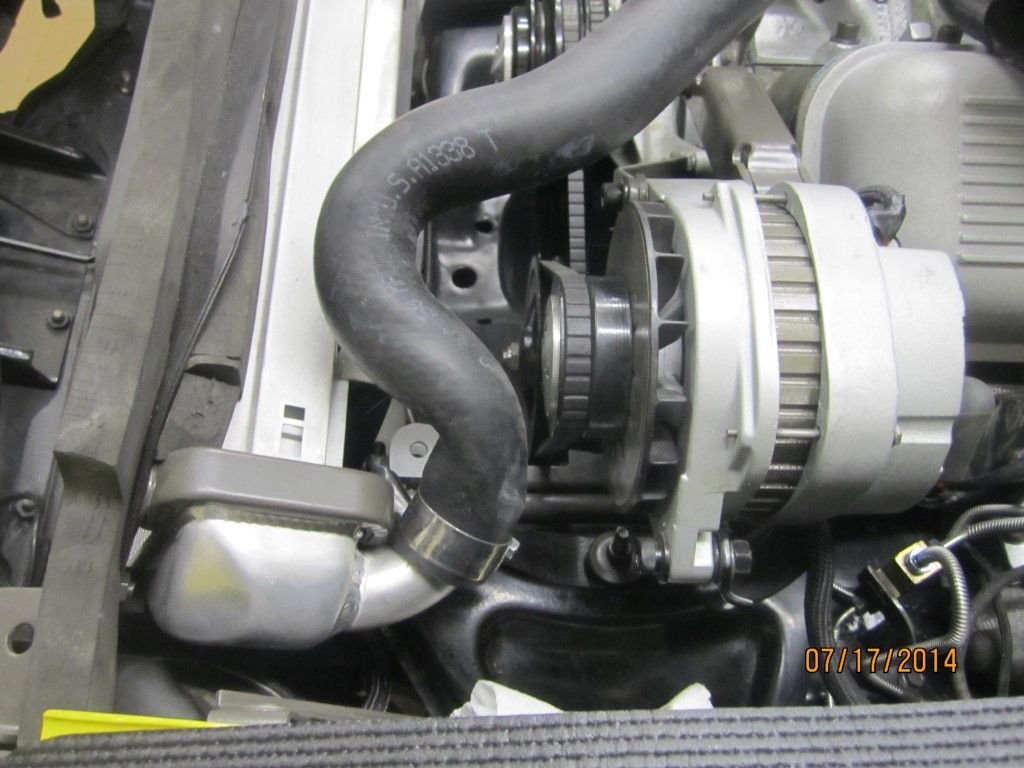

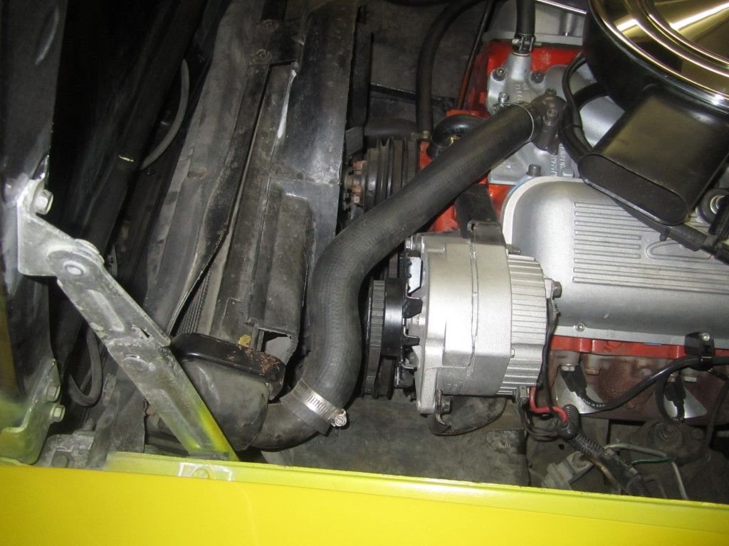

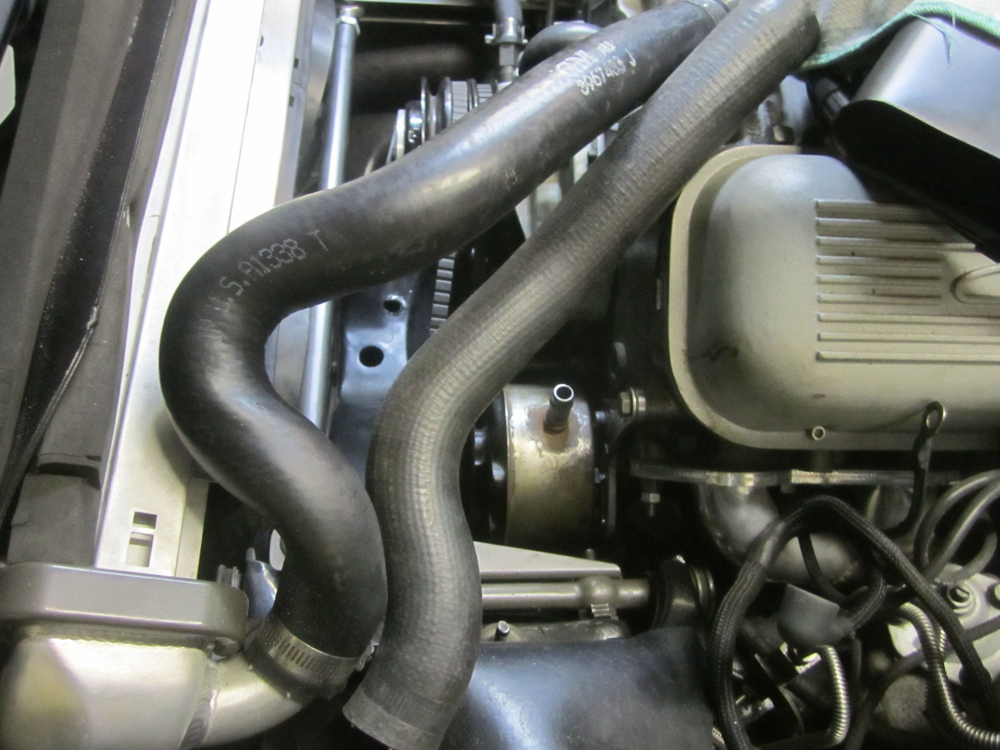

Take a look at a different brand of hose
These were two on my car, one I believe was a Gates hose from NAPA and the other a "GM" hose from CC
Yes there are other differences (rad and alt) but the shape of the hoses were significantly different
This probably should have had a 1/2" or 1" trimmed from the intake end to pull some of the kink out
Neither actually touched the alt-belt but they are certainly close to the pulley.
I'm currently in the process of changing all of this so I can't reference anything other than these old pics
M
M
Is the second hose the Gates/NAPA hose? It looks a bit less busy than my present GM hose. I moved the alternator over to the RH side for better weight distribution, and the second picture hose might look a bit more at home in my application.

LOL
I'm hoping I still have that hose somewhere around because I need the number from it as well for the same reason you just mentioned, well maybe not for weight distribution but for visual balance and access to the power steering pump
And now I have to find something better than this snake hose
If I find the numbers I'll let you know
M

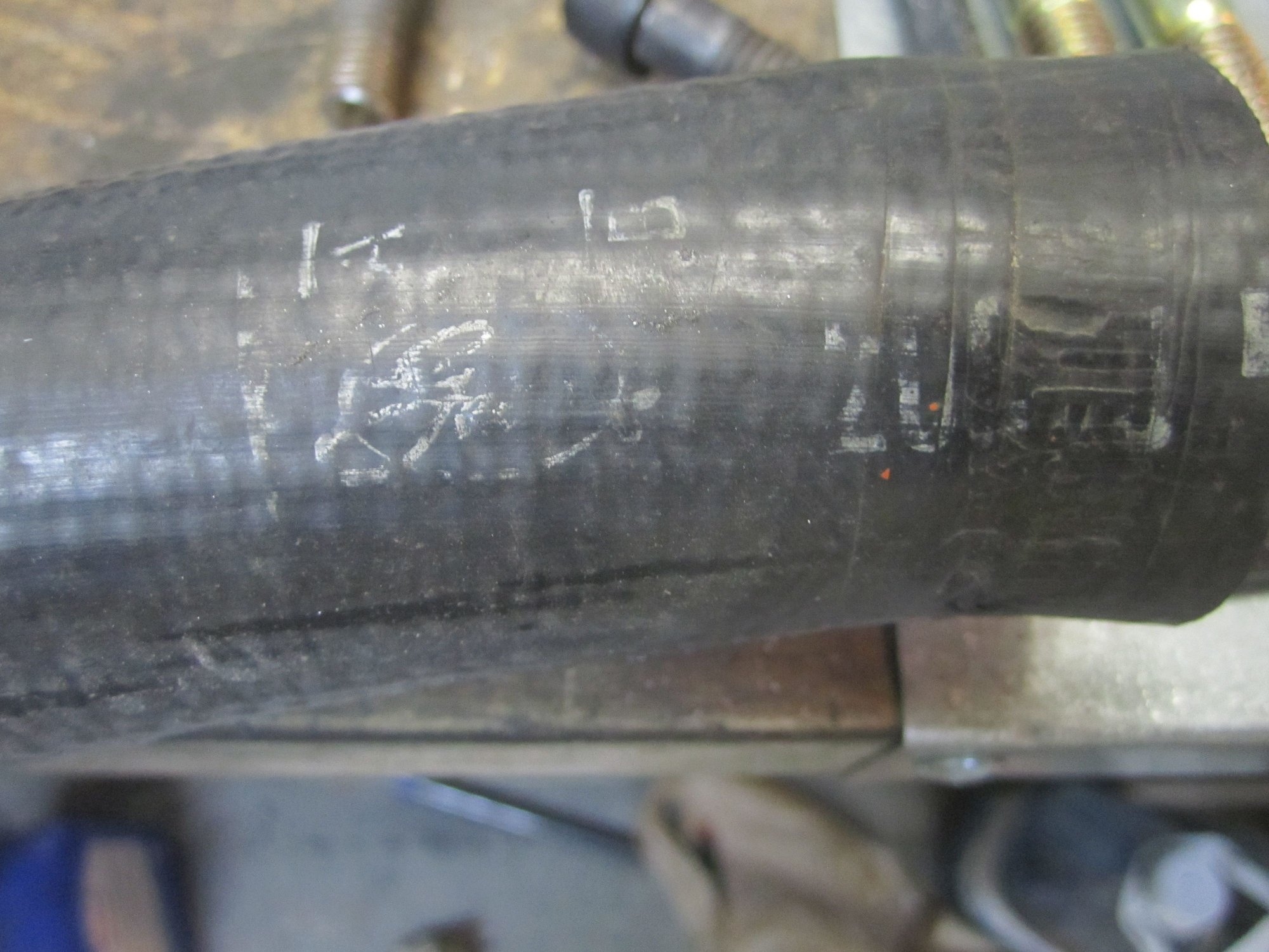

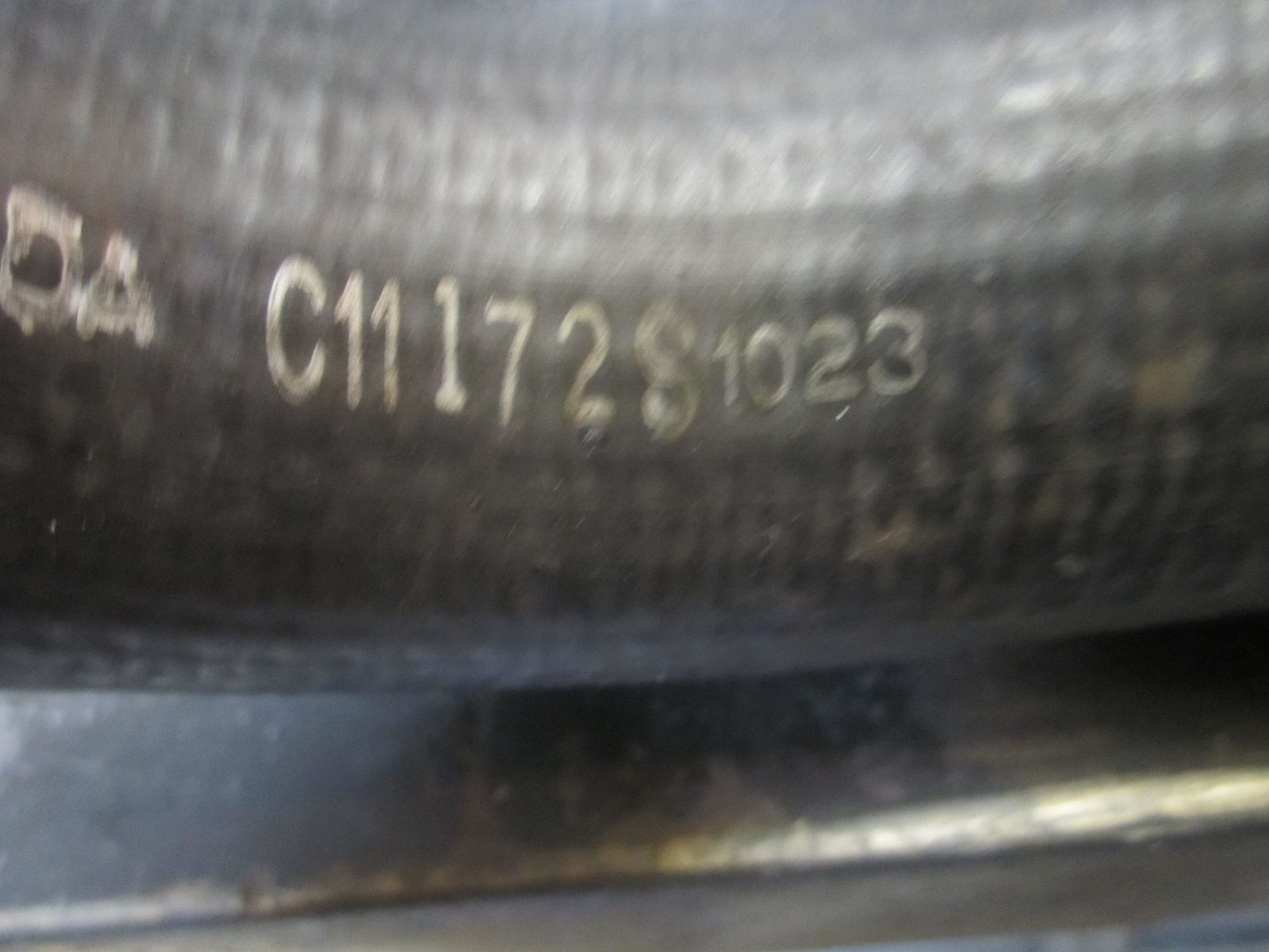

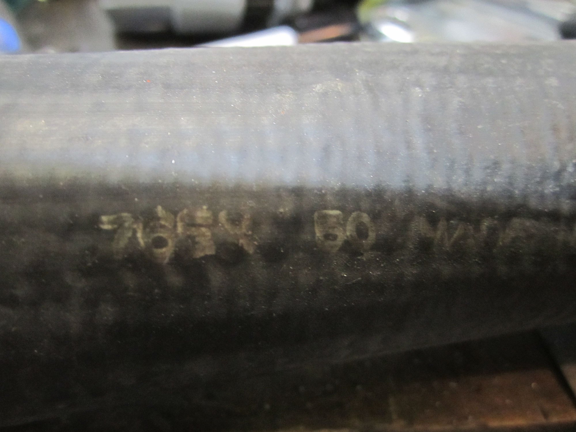

Gates
Can't find any references to these numbers at all C11 172S or 1023. Pretty sure I got it at Napa but that was years ago
Can't make these out 7654 but I think it's part of the general "made in Canada, shift etc.<br/>
Might be off a snowmobile or something. I'm still going to look for a better solution but I'm not that far up the engine yet.
