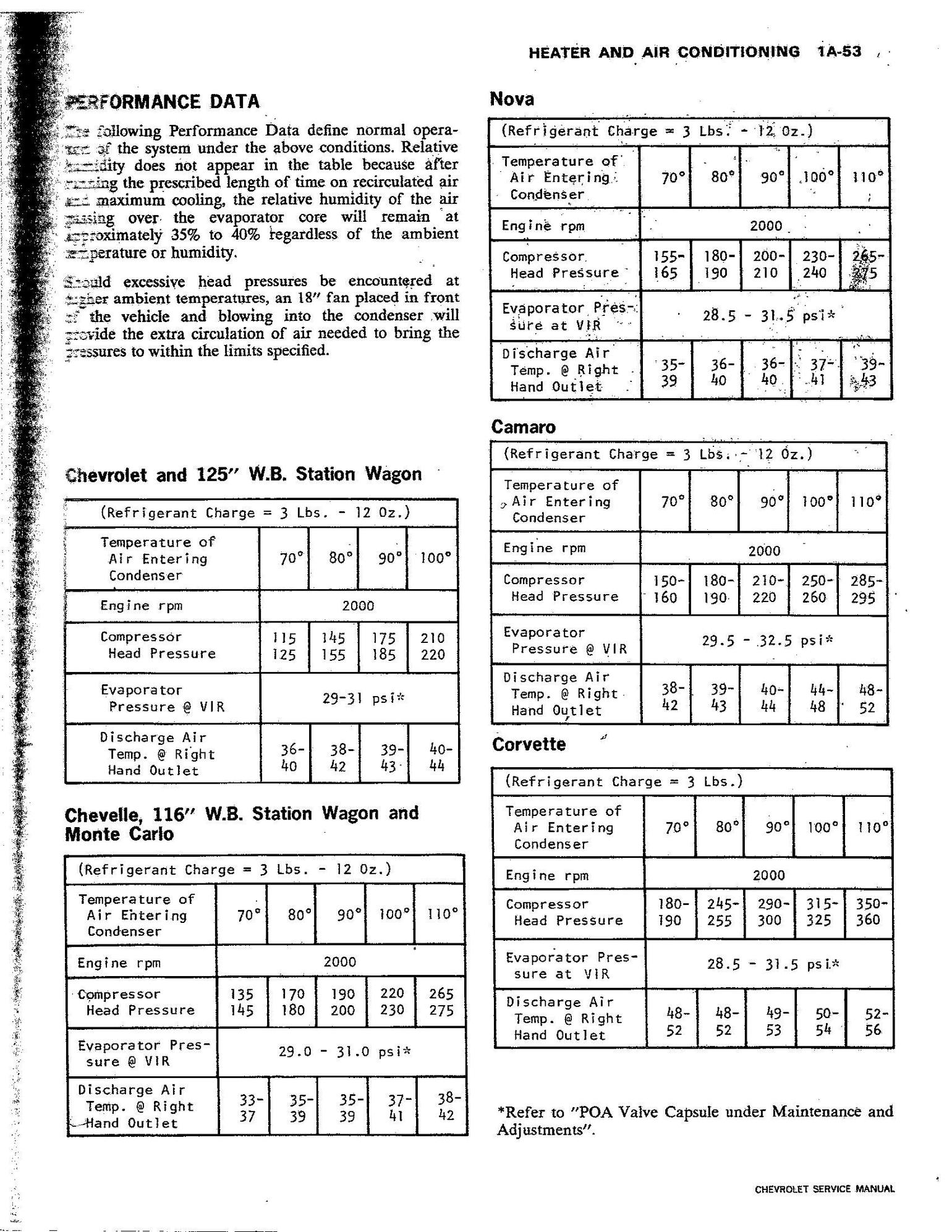

how much r12 does my ac system hold thanks

do you have a sight glass on the high side??? fill it until the small bubbles go away, usually around 3 cans(?). should say on a decal somewhere about how much if you were weighing it. You are certified to be working with R-12 , right?

yes cert to charge ac no site glass or stickers i really need the psi on high and low side thanks
Old Feb 4, 2018 | 03:13 PM
Peterbuilt's Avatar
Peterbuilt
Joined: Aug 2006
Posts: 7,417
Likes: 1,554
From: mount holly NC
Default From my 74 manual.
