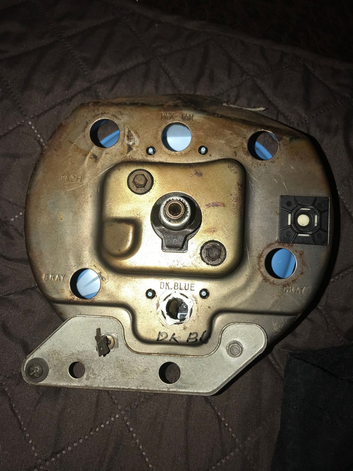

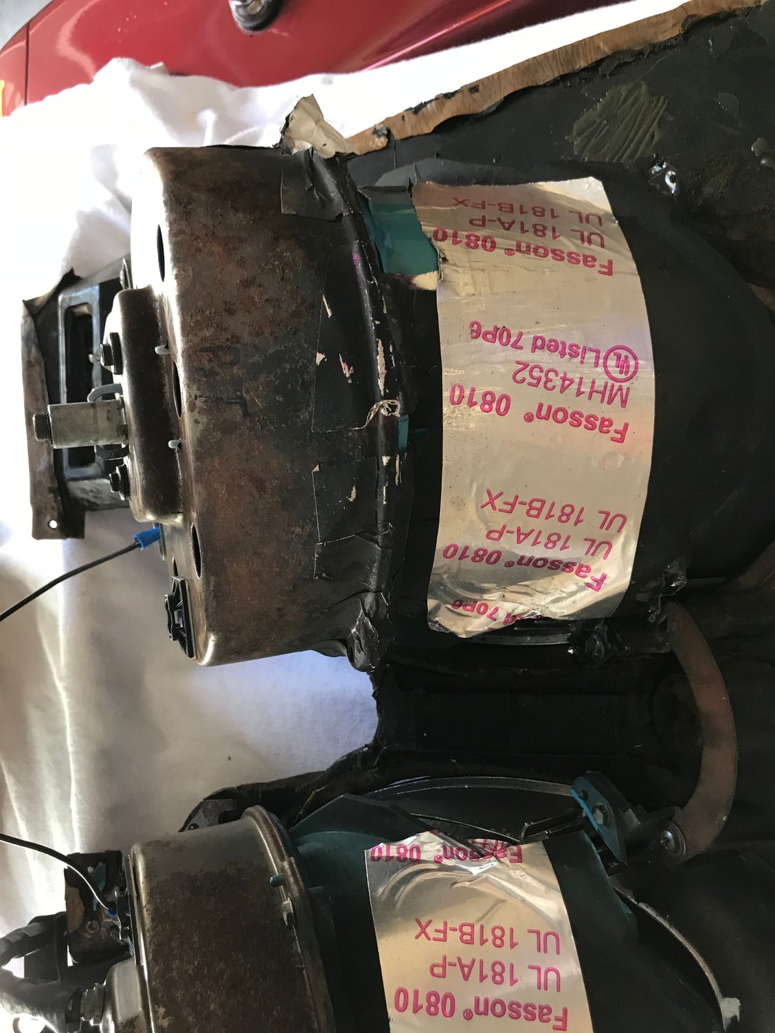

hey guys, I’m in the middle of digging myself a hole with my corvette and took out the dash and steering colum for some restoration, replacement and a vintage air install. As I pulled Out the lower left dash my speedo and tach basically fell in my lap because of cracked housings held together by tape. So my question is should I replace My tach with a rebuilt unit, buy a new one or keep the old? The tachometer worked just fine when I remived It, but the needle would bounce around with the lightest of taps on the gas. And from what I’ve read is that could be from the cable needing to be lubed. Any advice Is appreciated. I planned on putting a new face kit on it because all of my gauges work.

The blue plastic housings crack from age and heat damage. Ive glued mine together a couple of times. The cables break. The guage itself has issues. If you want it to be factory correct, plan on spending the big bucks. I tried the electric conversion to the factory tach. I have a few issues with it but it wasnt too far off. Im using an autometer electric tach now.

If the guts are good you can buy a new face. I would replace the plastic and the metal can be blasted and repainted. My car looked like yours twice since I got it in 2015. I just put it back together again this week. Are you going to stick wth the old style incandescent bulbs or make the swicth to LED. I just decided to go LED since I had to pull the dash for the fiber optic cables. I decided to swap both of the forward harnesses since i overheated the ignition wires with a starter issue. Another wonderful, "WHILE I'M IN THERE" moment in corvette upgrading. I'm noticing my dimmer rheostat in my headlight switch is getting twitchey but its only 2 years old and a new one probably wont be any better

I'd replace the plastic housing and cable, and put it back together. The plastic housing is about $80 and the cable $25.
You have no idea how old the cable is, you could lube it today, and it could break tomorrow. Everything's apart, so now is the time to replace the cable.
A new tach is $180, and it doesn't come with the $80 housing. The "bounce" you describe, sounds like a cable. So why replace a tach, that by your own admission seams to be working?
