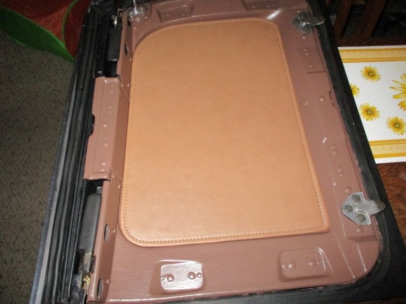

OK, Thinking about this, and it seemed like to much Black..................
Found a can of satin brown on the shelf...............
Old Feb 6, 2019 | 03:45 PM
Barrist's Avatar
Barrist
Joined: Aug 2015
Posts: 373
Likes: 170
From: South Bend IN
So, Anyways, This is the result...............
It works for ME. And cheaper than Glass Tops......
I'm Very Happy with the Upholstery Shop on this one......
I'm not sure, that I could have planned this any better.................
And YES, Plenty MORE HEAD ROOM !
A little chrome polish, then Done with that One.
