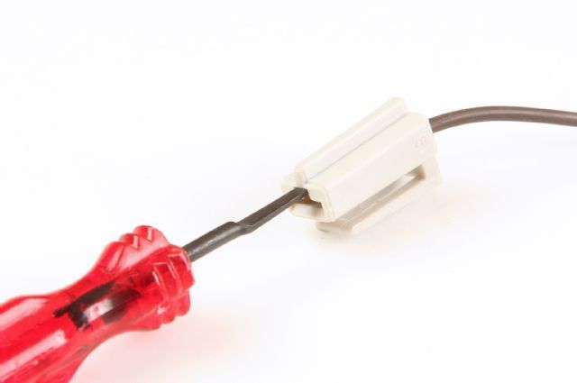

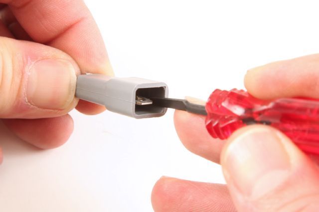

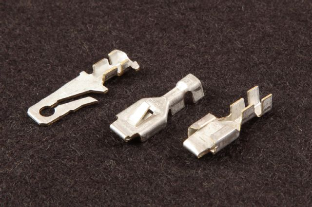

You should be able to pull each wire connector out of the plug and "tighten" the brass/copper a little to give it a tighter fit. If one or any of the actual ends are broken you'll need to replace it or the whole socket as mentioned above.
To remove the lead from the socket you'll need something narrow and flat like a straightened bobby pin or flatten out a heavy paper clip or even the proper tool..... insert it into the bulb end of the socket and push the lock tab down, then the wire will pull out the back
HIH
M
Typical packard connectors, yours are most likely the middle or right one so you can see the tab that locks them into the plastic housing
Here to remove the top style retainer
Here for the side (I don't think yours are like this but)

You can pull the light, remove one wire at a time from plastic housing as shown above, put that single wire on the light and tighten with some small pliers. Bend the little tab back up a little on the connector and reinsert wire into housing. Repeat on other wires.
Just a side note, I actually found a bad crimp on one of mine. Bought the crimping tool and connectors redid all four lights. These are not standard Delphi/Packard #56 connectors, they are Delphi/Packard #59. #56 are 1/4" #59 are 5/16". The double wire crimp is a #12 gauge connector and the single wire is a #16-#14 gauge connector, so there not all the same.
