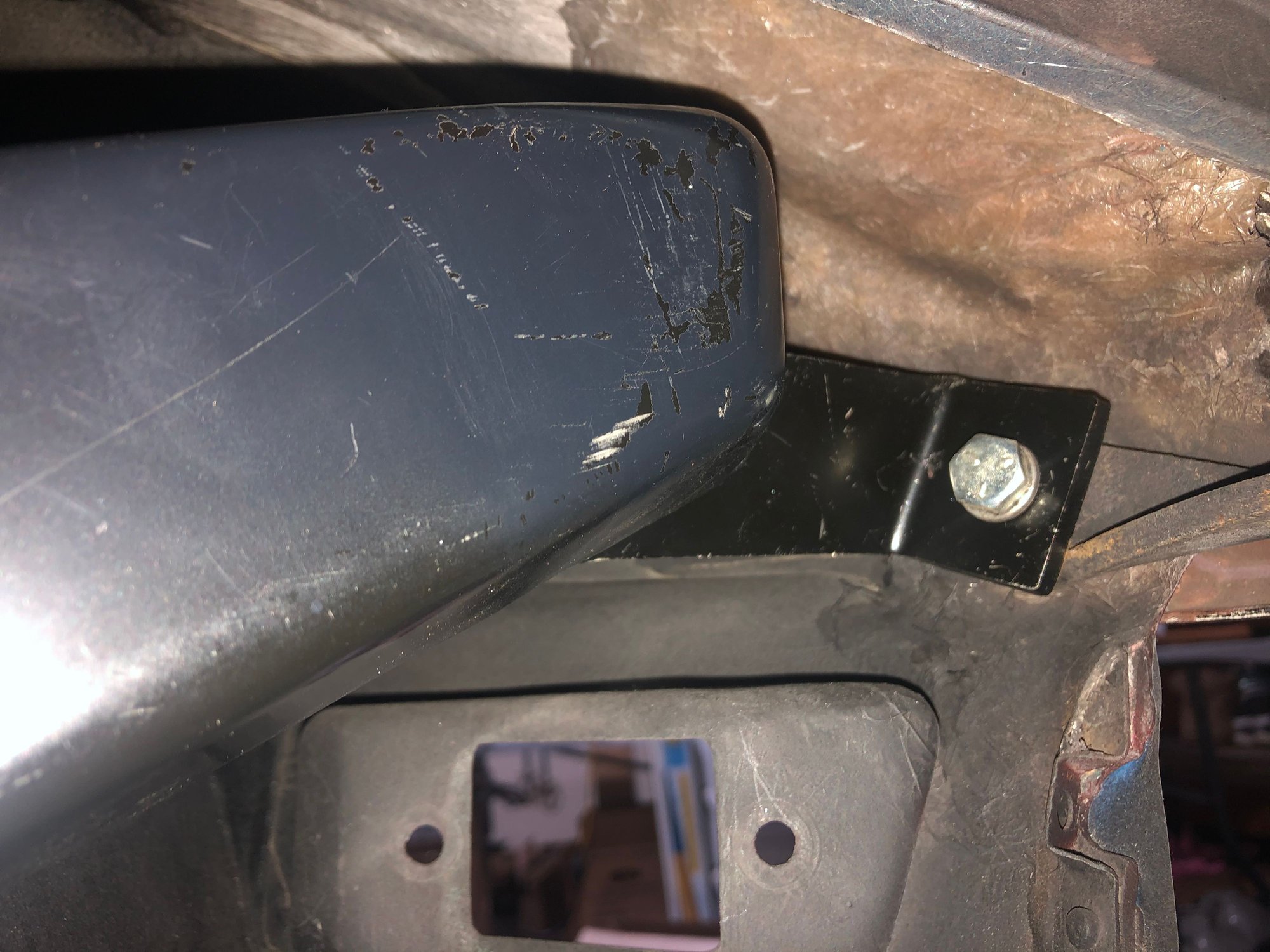

I have a 69 that my dad bought in 1981. We did an on-frame restoration and discovered it had a 1970-73 nose (side vent sections were cut and glassed in). So while rebuilding the front end now in 2021, I went crazy trying to find these braces only to discover that for 37 plus years these front bumper braces have not been on the car and bumper has been bolted directly to body. I ordered new '69 braces (from Corvettepartsworldwide.com) and they appear to be about 1-1/14 inch too long. I see in the first photo that the second set of braces appear to be shorter than the rest, or maybe I need the last pair (to right).
I crudely measured the bracket on another '69 and the distance from the tip down to the dogleg is an 1' or so shorter than the braces I have.
Does anyone have any insight on this?
Thanks. Bill

I would find a set of braces with the correct 68,69 part numbers and the correct corresponding brackets to go with them. I got a nice used set from forum member geopar here on the forum. Original stuff is almost always less hassle than repop parts imho. Go back to earlier posts in this thread for the part numbers. Check EBay as well.
If you go with the 69 braces, you will need the correct twist brackets and extension brackets as shown in my previous post.
Here is a right and left on EBay.
https://www.ebay.com/itm/Corvette-Or...kAAOSw29Jb6zFL
https://www.ebay.com/itm/Corvette-Or...oAAOSw18FgChhA
Bill
