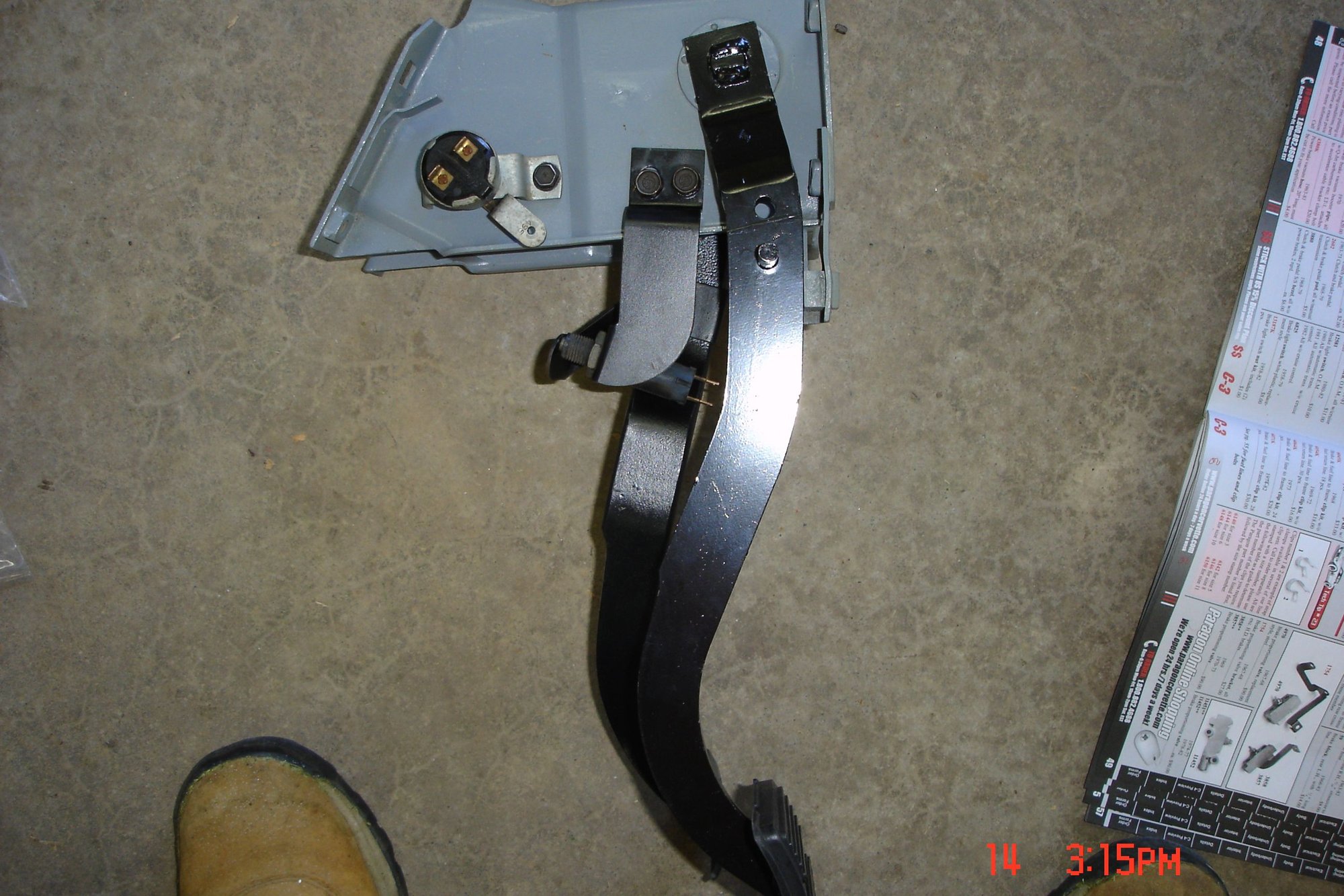

On my 69 4 spd car I noticed the neutral safety switch is missing can anyone show me where it goes and how it mountsThe problem is it starts in gear without pushing the clutch and that could be dangerous, I found the switch and rod all in tac and plugged in .

If memory serves me right this is the correct diagram.

Thanks ya'll I havn't looked under the dash yet but this lets me know just where to look and how it's mounted it may be there and unhooked or missing but this will help.Thanks

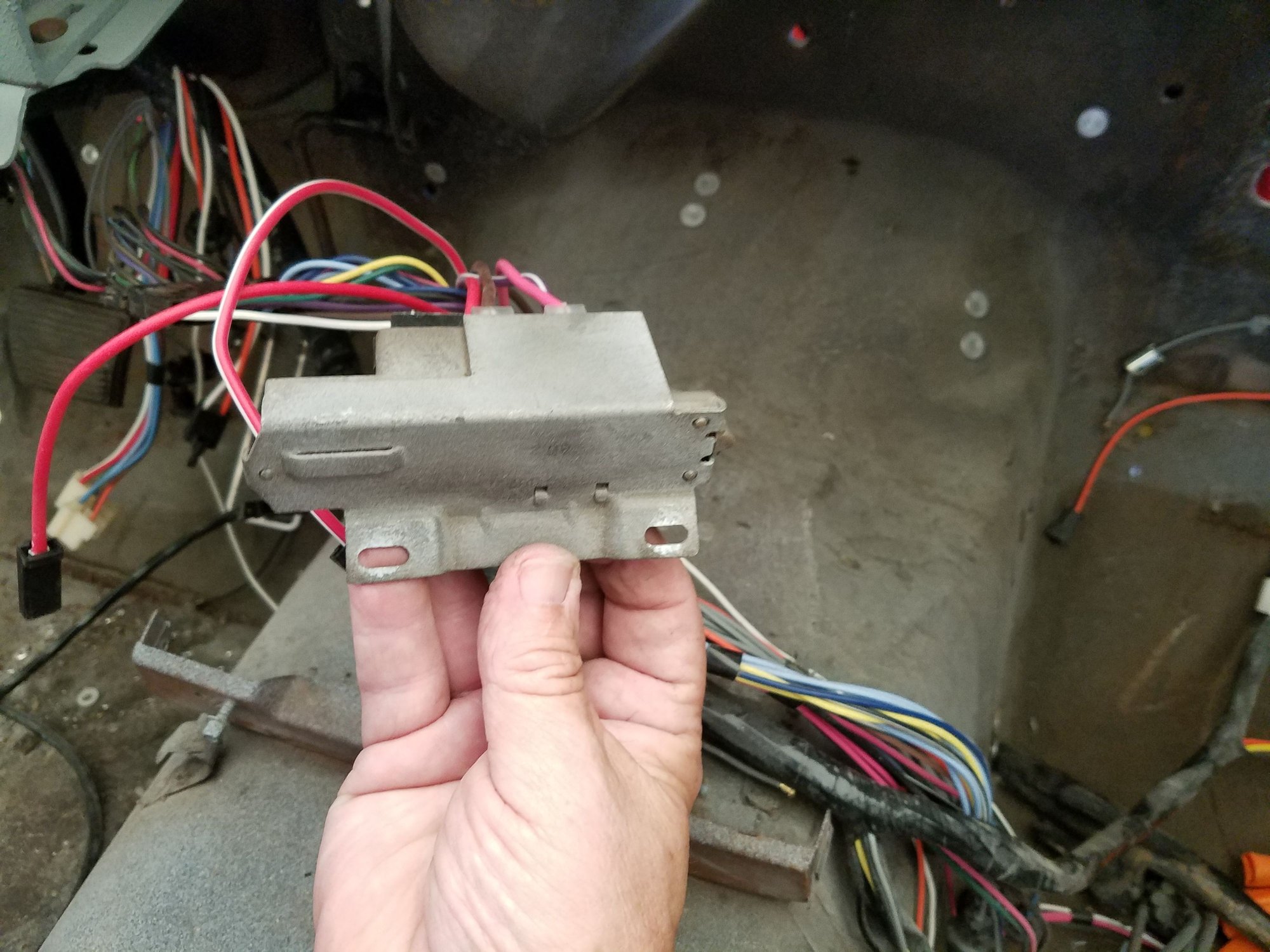

The top pic shows the switch but remember there is also a relay under the center console. It has two larger purple wires and if it is unplugged n a jumper put in the neutral switch is now bypassed. The bottom pic from Rvzio is the ignition switch which moves when the key is tirned.
found the switch and rod are all in tac and plugged in didn't know about the relay so Ill check that also , I have a new switch if I need it, not easy for an ole guy to get to. Thanks
