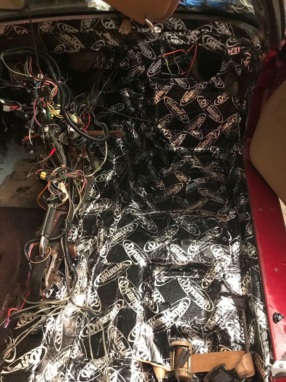

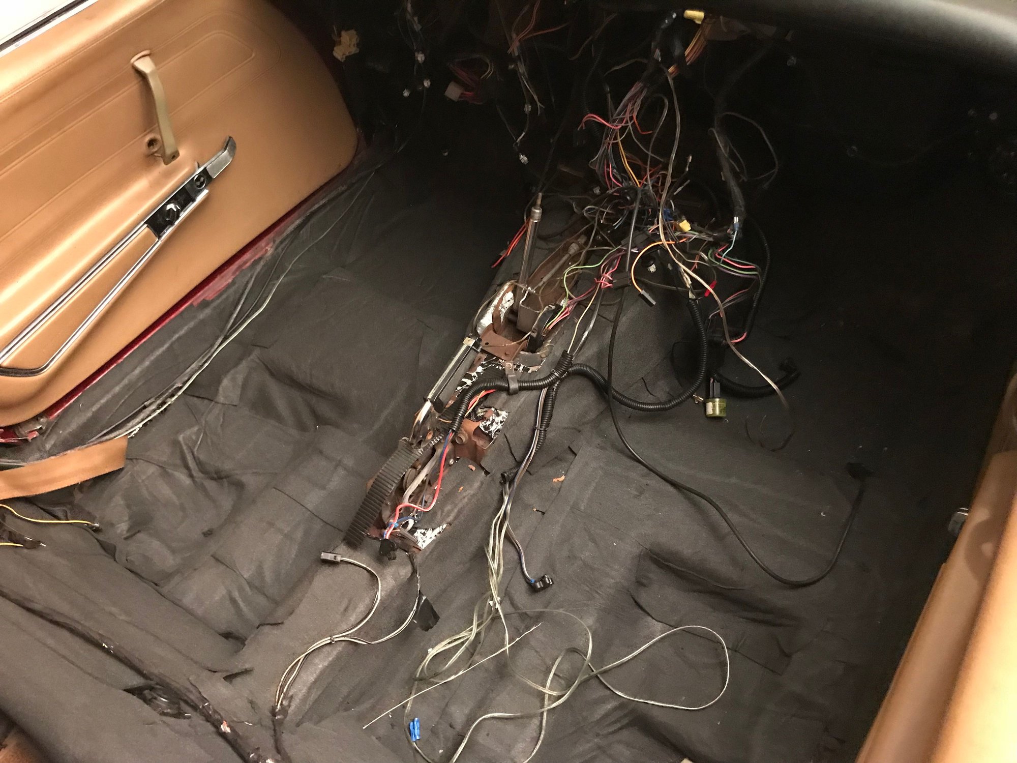

Stripped
Lined with dynamat
Then put ensolite peel and stick from RAAM audio
