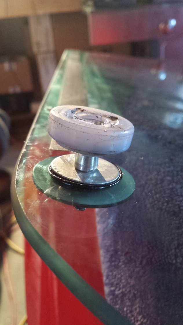

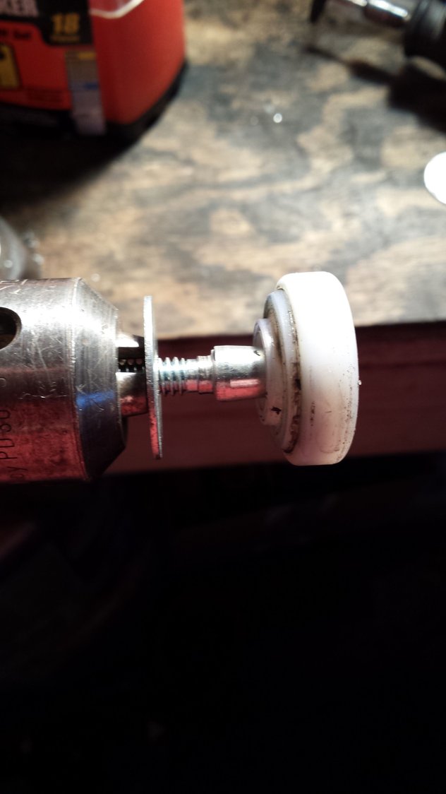

Finally got the driver door window to not tip in so far that it runs into the windshield post. It still tips in but about 2 inches less. So its actually enough to catch the weather strip and rides right up into place with no problems. So here is what i did. I tried all the advice including the suction cups adjustments i had actually just got a pair about a month ago to install the front and rear windows. Although this adjusting helped it still didnt prevent the original problem of the window tipping in.
i removed the bottom track from the glass and removed the plastic centering washer and glass nut. Laid a strip of heavy electrical tape on the glass and attached the track to the glass on top of the tape used the bolt glass nut and centering plastic washer on the outside. This gave me about 1/4" closer toward the interior of the door at the bottom. Then removed the front guide bolt from the glass and used a dremel tool to remove about 3/16" from the shoulder to again pull in the bottom of the glass. Installed a thin fender washer and the same type centering plastic washer and glass nut with a little window urethane adhesive on all attachment points assembled and this actually moved the glass out about 1 1/2" at the top.
photos for reference.
