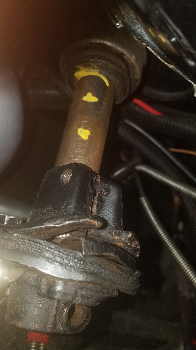

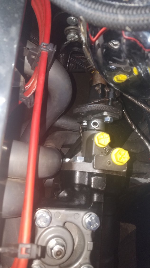

I seem to have typical p/s leak issues. Switching to Borgenson steering has a lot of appeal and the various vendor price seems reasonable. HOWEVER one issue gives me pause- the sentence which says the column must be shortened or collapsed 1 to 2 inches for the pieces to fit. So my question is how difficult is the shortening to accomplish ? Thanks in advance ,

it is very easy. I put some vice grips on the shaft as a stop/marker and smacked it down into the column. I think I put a 2x4 over the end and beat on it a couple of times if I remember right. I really like the upgrade.

I've had Borgeson steering for a very long time. Trust me, you won't go back.

Mine collapsed fairly easily. (meaning the plastic pins are doing nothing but providing a friction fit)

I'm still working on it in my 79. I had to pull the steering column out to get it to collapse, and to use a Dremel to fix the damage done with a few missed hammer hits while it was still in the car. It collapsed easily enough when mounted in a vise, but there was no way I could have hit it that hard in the car with the engine still in place. Now I'm just waiting on parts to fix the problems I found when I pulled the steering column.

Not hard. The key is to make your marks and take your time tapping. i used a small piece of wood and had to take small taps cause the engine was in the car. as far as going back? i doubt you'll want to.

I used a 5lb sledge. I measured carefully the amt to move and tapped it in slowly.
I love the Borgeson upgrade. I did the hydroboost at the same time. Excellent upgrades for the C3. The Hydroboost really opens up the engine bay.
