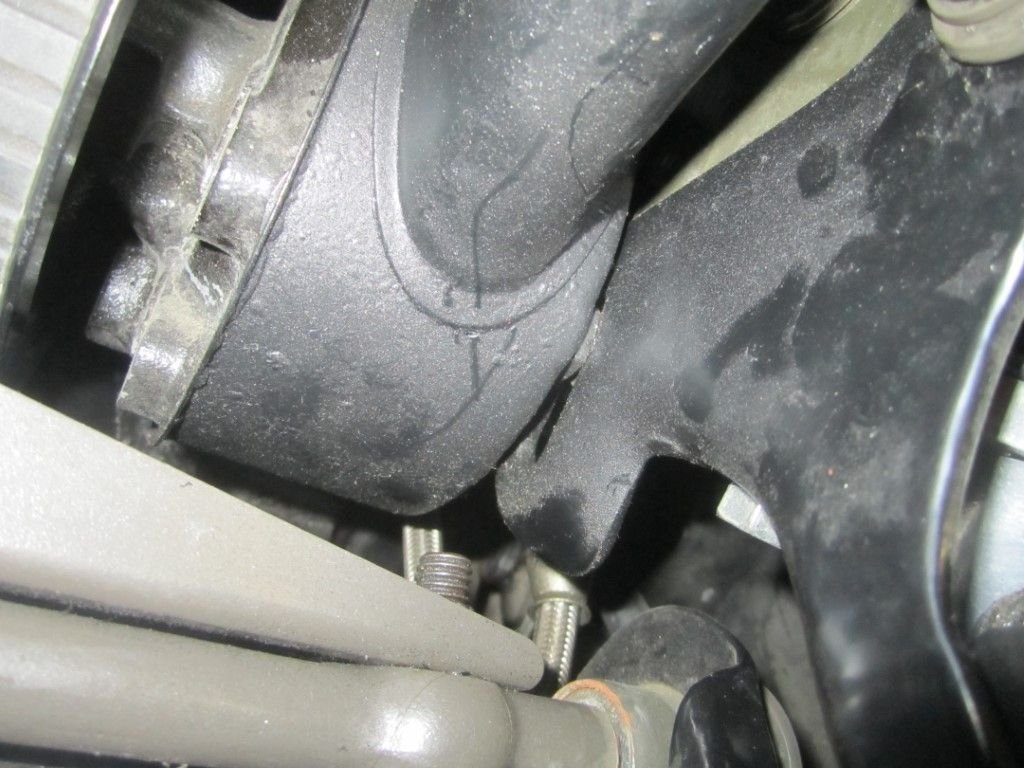

Two bottom bolt & nut need to be loosened a little so it'll pivot. Bolt on the front and nut on the rear stud (bolt and nut are not on here but you can see where it would be, bracket has a slot in the rear
The top bolt is the one that hold the tension, slides along the curved slot in the bracket that holds the alternator.
It's really hard to get at with the alt in place, really it's worth removing it to get at the bolt.
I can get under the car so it's fairly easy to get at it with some extensions (one with the ball woble end) from way back behind the motor mount believe it or not

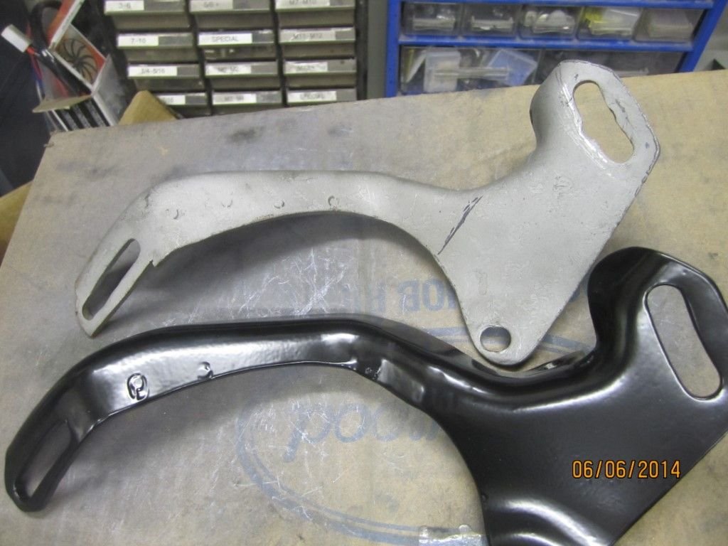

Hopefully you can get it adjusted by using Mooser's methods. But just in case you are still having issues, here is what I have found happened to me on my 454 PS bracket over that past 43 years.
In 2 cases, the bottom rear part of the bracket broke off and I couldn't tighten the nut to hold it in place. So I purchased new bottom brackets. The current one is still holding up.
On the original factory top bracket, there was a worn groove in the adjustment slot and I couldn't get the stud to hold when I tried to adjust the belt. Bought a new bracket....problem solved.
This probably won't happen to anyone else, but I thought I would share just in case.
Bottom bracket
Top bracket

You mean like this one (on the top)

Yes! Mine had the indentation of the nut embedded into the bracket. If I were to install a washer between the bracket and stud nut, it would throw off the belt alignment.
So, a new bracket was picked up at my local Chevy dealer. Yes, they use to stock the parts I needed.
