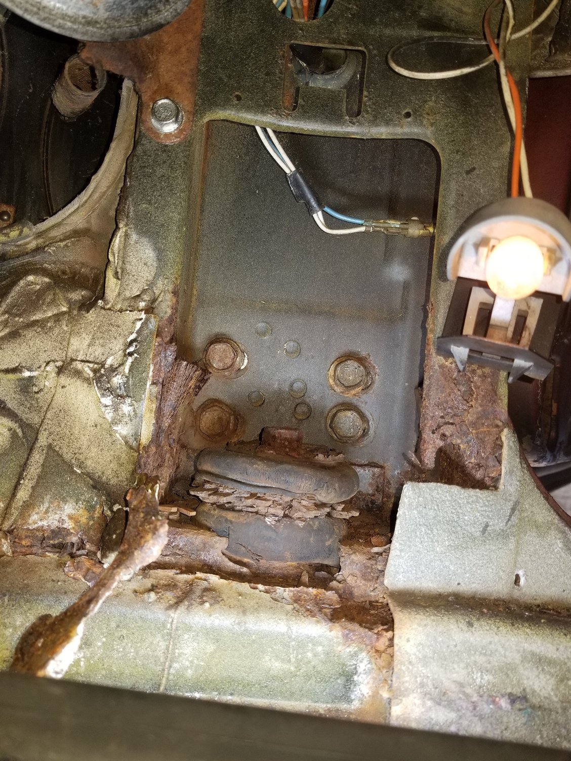

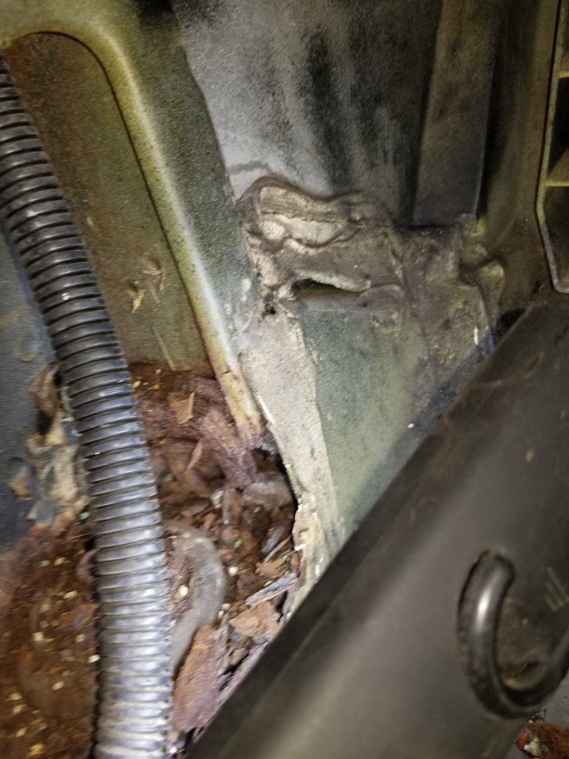

So this past weekend I gutted the interior and was going to install some speakers into the kickpanels and oh boy...you know what was coming next. its bad. the A pillar bases are rusted terribly some of it isnt attached anymore. So then I checked the B pillar bases... not good. I am going to do my best to provide some structural support to it over the next few weeks and then just drive the car for a few years hoping for the best.

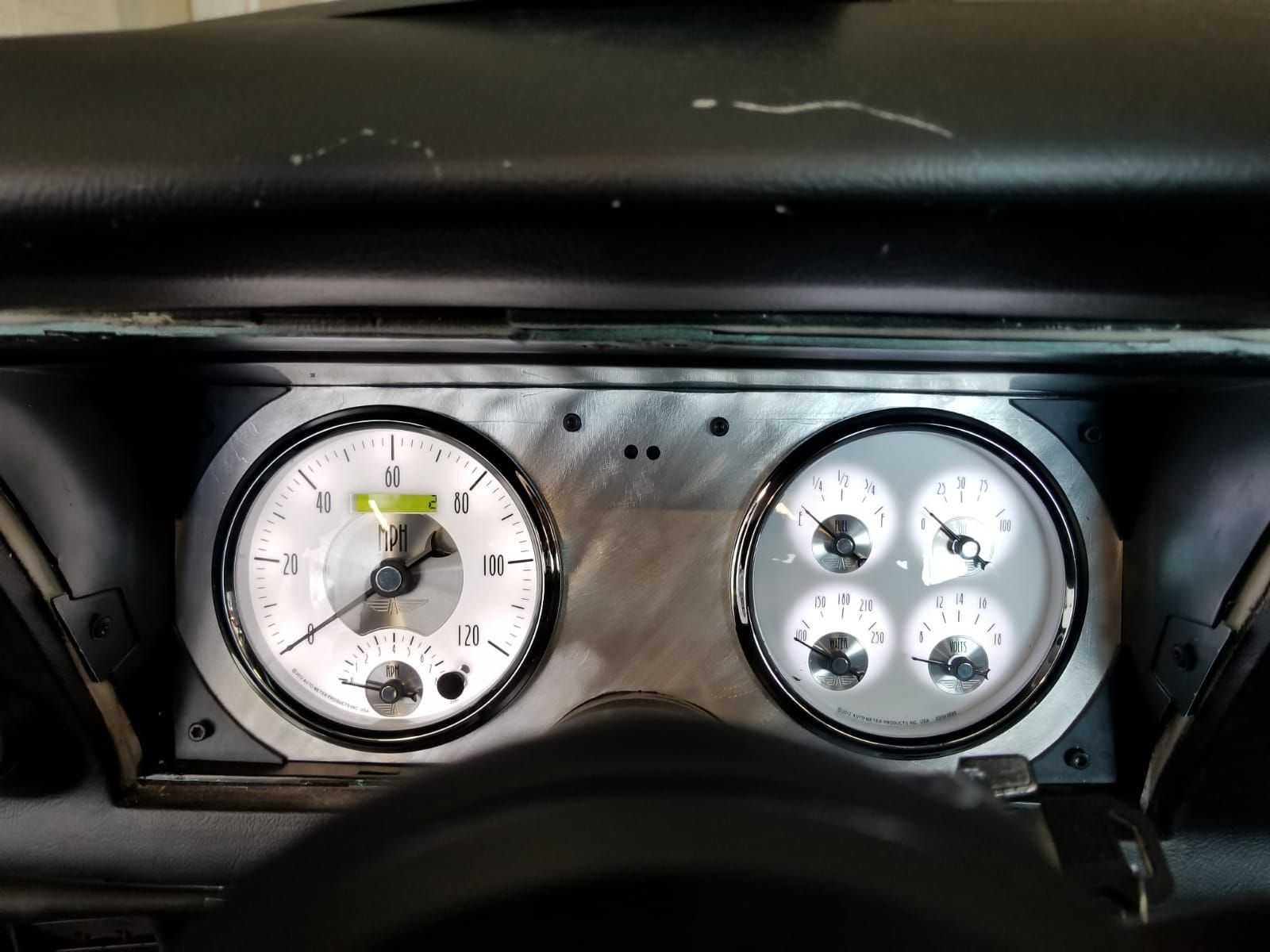

with respect to the gauges for the speed and tach I used the original housing along the outside but made new mounts for the gauges, combo gauges from autometer so i eliminated the center cluster and moved everything to those two gauges. I was hoping the housing is about the same size and maybe I could just take the entire housing unit ( see attached pic) and throw it on my next car without too much work.
This is what made my heart drop. Going to clean this up this weekend and reinforce the best I can after removing the rust, applying POR15, then bracing that area a bit with some metal and then some structural epoxy to buy me some time.

The speedo/tach (and dash) on 77 (?) and older are totally different. Look up a picture of a 75 dash via a google search, and you should see what I mean. You can probably re-use your gauges, but it'll need some fresh fabricating (which looks like your ok with anyway!)

As far as safe to drive it like that the bird cage is part of the body that sits on the frame. If your frame is good the worst damage I think it could do structurally is door sag, windshield cracks, top not fitting correctly and fiberglass cracks. Not to mention reduced crash protection. If you want to clean it up and POR-15 that will stop the rust on the inside but not on the outside. It could buy a few years.
The main thing I'd look at are all the body mounts and also the trailing arm pockets for similar rust. Check the front crossbar and radiator support and radiator support cross members too. These are the areas where it could compromise safety.

So far no door sag, they close perfectly. The frame around the windshield is pretty good ( didnt remove dash to see lower). I had the windshield replaced last week due to scratches from windshield wipers.
So far my plan is do really clean up those A pillar bases tomorrow, coat them in POR 15 and then make a brace from the pillar to my steel floor pans to provide a little bit of support and then put some POR15 epoxy around the area. I considered supporting it to chassis but then figured it might make it worse by doing that.
