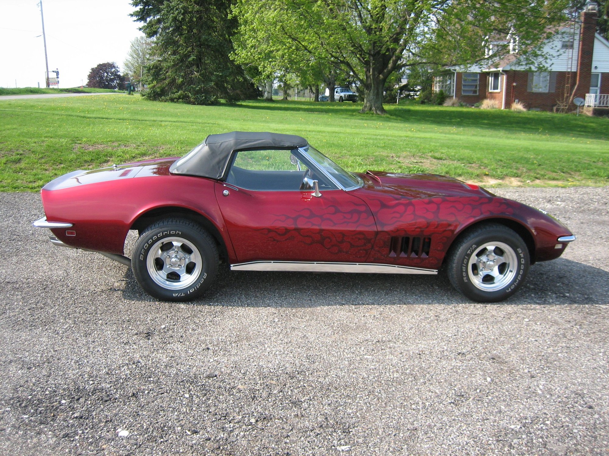

I have a friend that is selling his 68 Corvette. He has offered it to me for a deal but something looks odd with the suspension so I thought I would post it here to see what everyone thought.

it is sitting very high in the rear, it could be set up that way intentionally. can you get pictures of the rear suspension set up?
And the tire size......smaller diameter tires than original also make the rear of the car appear higher than it should be.

The axle angles show its just sitting high.

Pretty sweet car if it passes the rust questions, ( no, its not rust free )
I am not a flames on c3 fan but those look pretty darn good, get some better sized tires, lower it and have a ball...

I had those tires, they are about 1/2 inch smaller than the 27" tire size that should be on there. They will give you alot of room in the wheel well and the speedometer will be off a bit. You just have to adjust the 2 spring bolts near the tires and you can lower it.
He may have jacked it up a bit for the exhaust to clear, it doesnt look like its a kit that fits, maybe a custom job at a local garage

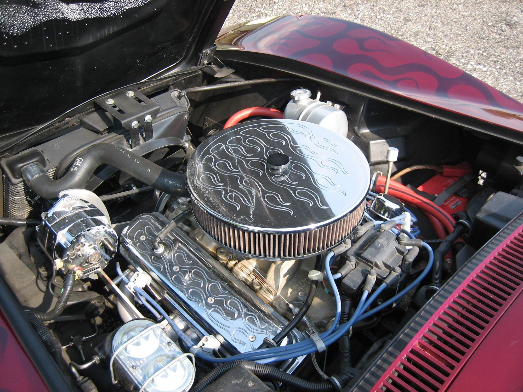

Notice the battery on the passengers side.

Is that a normal size radiator? Looks small.
