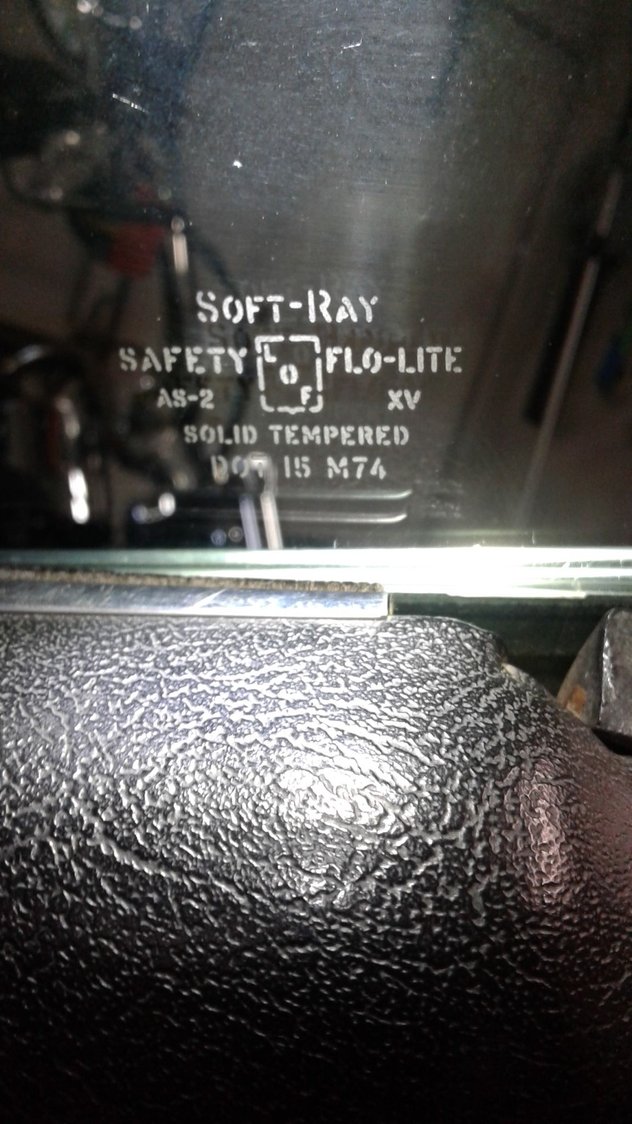

1969 SB Manual Coupe with A/C Build date October 1969
Anyone know window codes?
Passenger side looks like:
E-Z EYE FLOAT
SOFT-RAY
SAFETY LOF FLO-RITE
AS-2, JA
SOLID TEMPERED
DOT 15 M74.

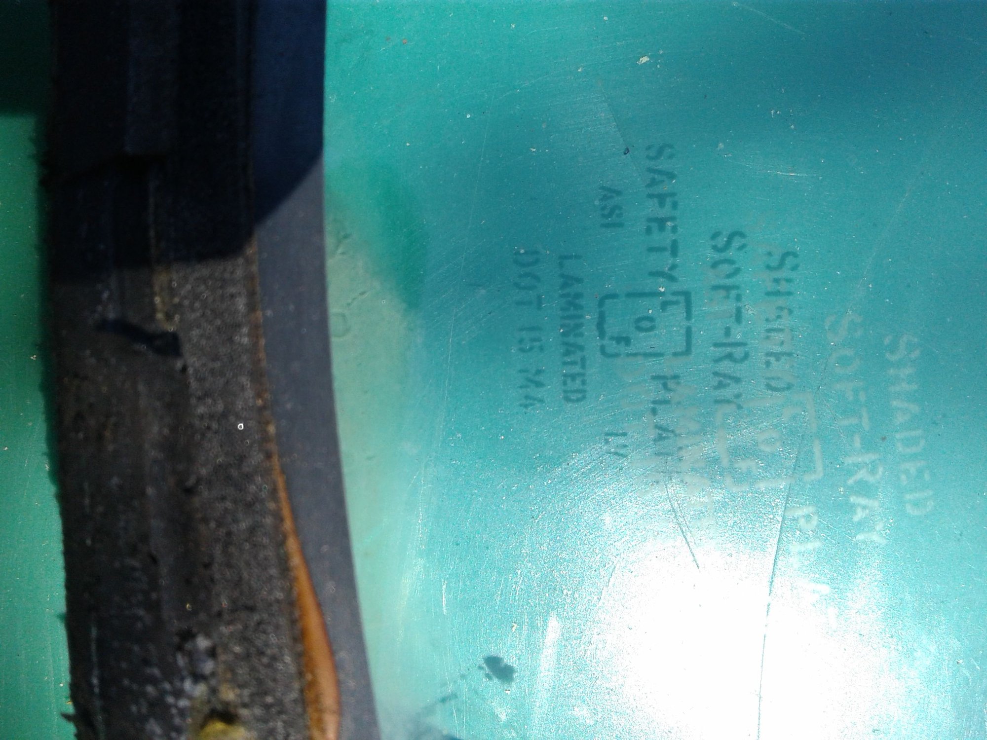

Front window
SHADED
E-Z EYE
SAFETY LOF FLOAT
ASI, XZ
LAMINATED
DOT 15 M32
Thanks

Passenger window

The above picture was edited, flipped horizontal to be readable. It is only readable from the inside.

JA would be May 1979
XZ would be February 1967,1980

That’s what I get, too. The NCRS Judging Guide also says no Safety Float Glass was used on windshields in 68-69.
Both pieces appear to be replacement.

Huumm so not original. My front windshield is delaminating in both lower outer corners I assumed a sign of being original. Regarding the passenger window is the shape of the window the same whether a 1969 or 1979? Would the fitment be exactly the same?

Originally Posted by RickDett
Anyone have example pictures of original windshield and side window codes? For 1969?
Rick
Side window
Old Jun 13, 2018 | 05:53 PM
Faster Rat's Avatar
Faster Rat
Joined: May 2009
Posts: 3,079
Likes: 314
2024 C3 of the Year Finalist - Unmodified
Rick
Windshield before going in the recycle bin
