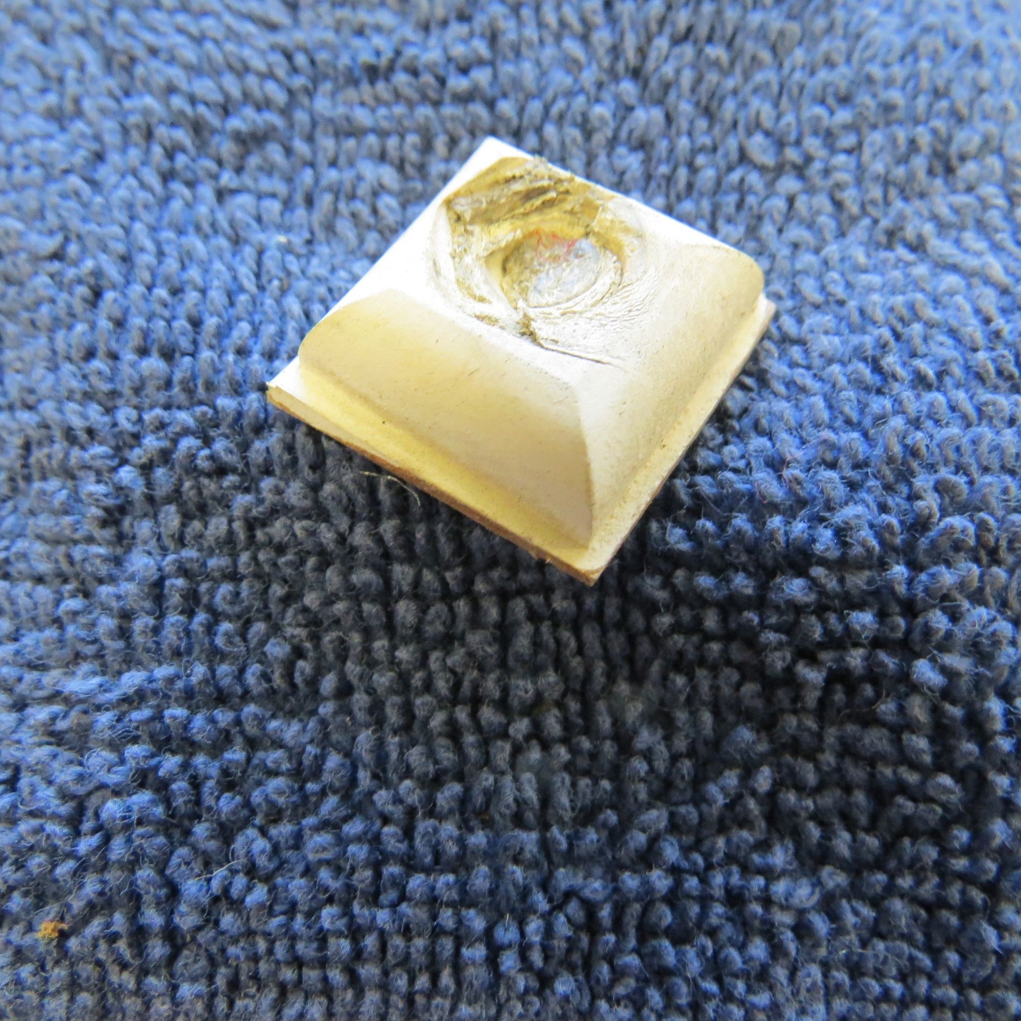

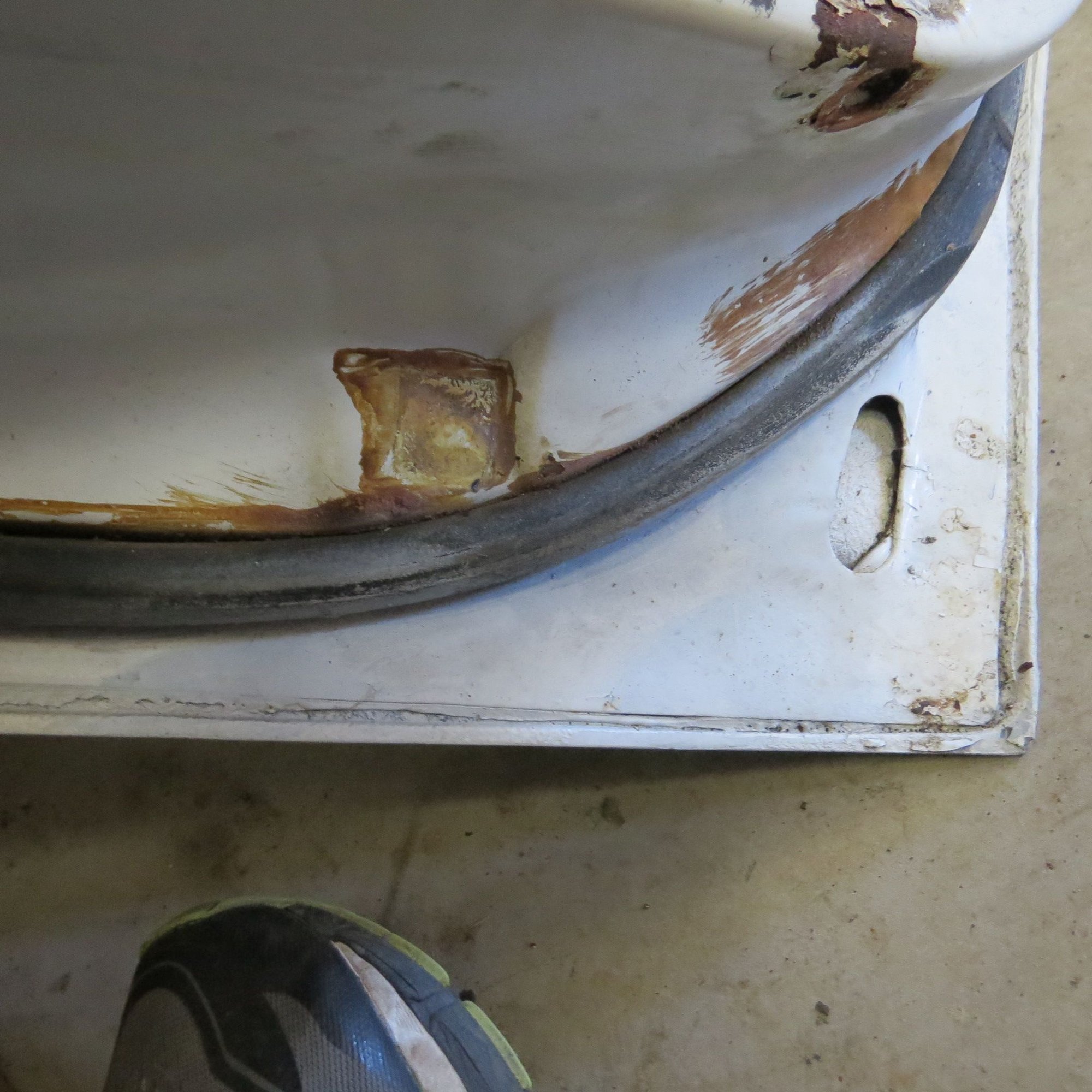

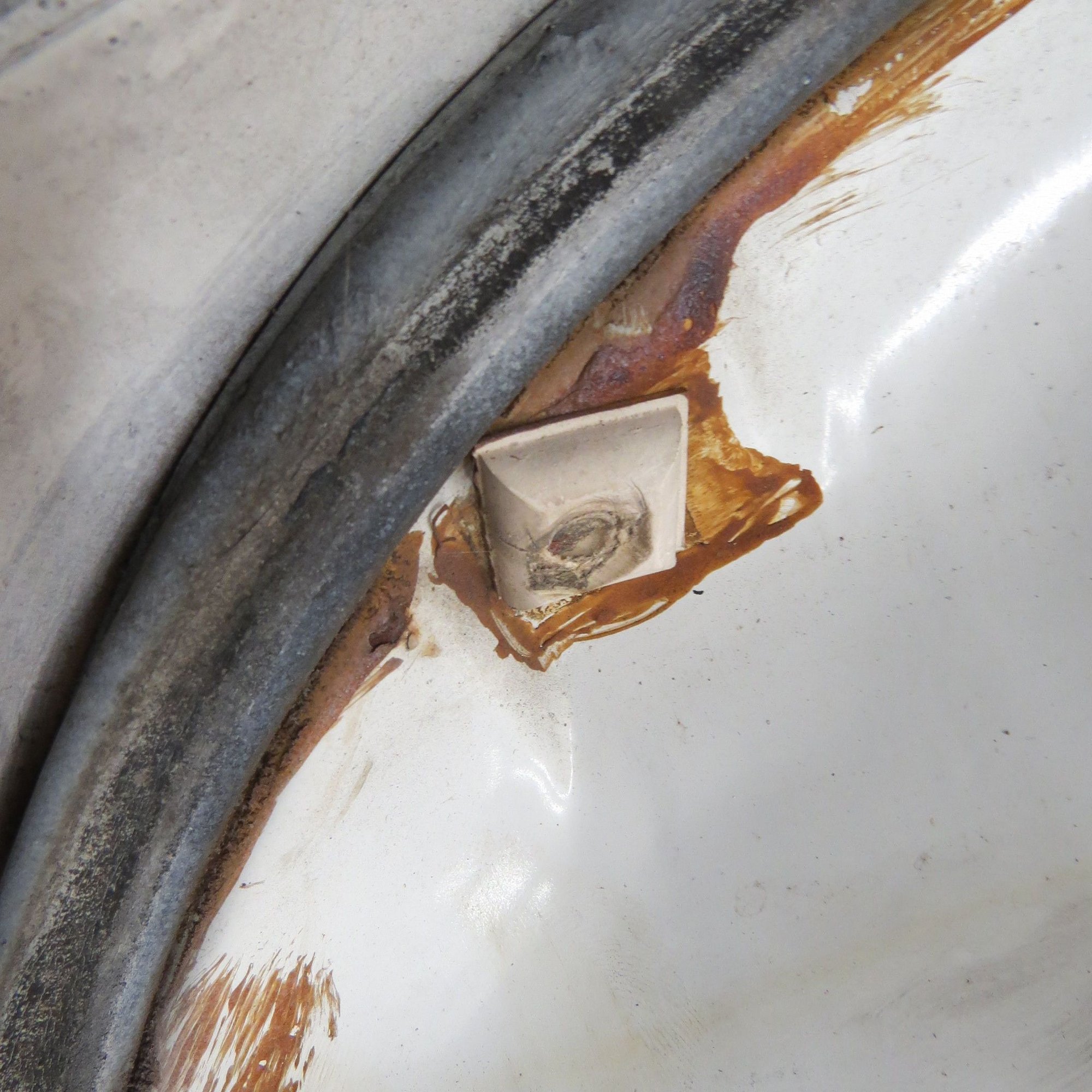

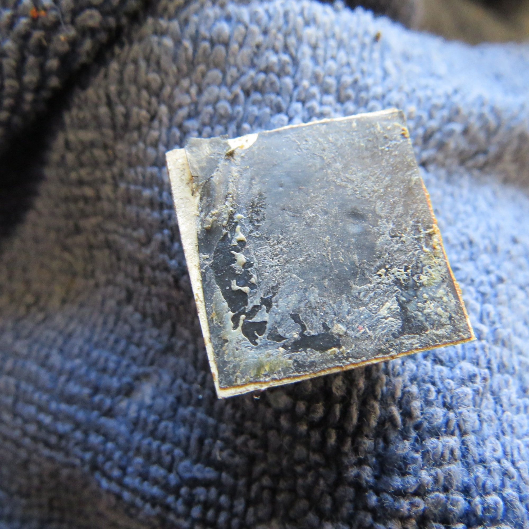

Attached are pics of placement on a white 72 door and pics of that bumper removed. Hope they help.
By the way, that brown stuff is all factory-installed weatherstrip adhesive.
