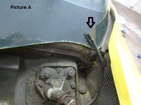

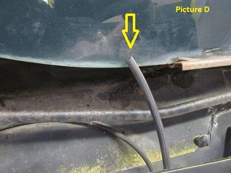

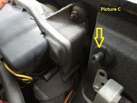

I need some help guys. I have a 73 stingray with some broken or cut vacuum lines and I don't know where the hook up to or what they are for. here are the pics and they all are where the wiper blade arms are located.

have you accounted for the wiper washer lines ?

Those are windshield washer lines that connect to the aluminum tubes with nozzle ends on the wiper arms. What about your pump and reservoir?

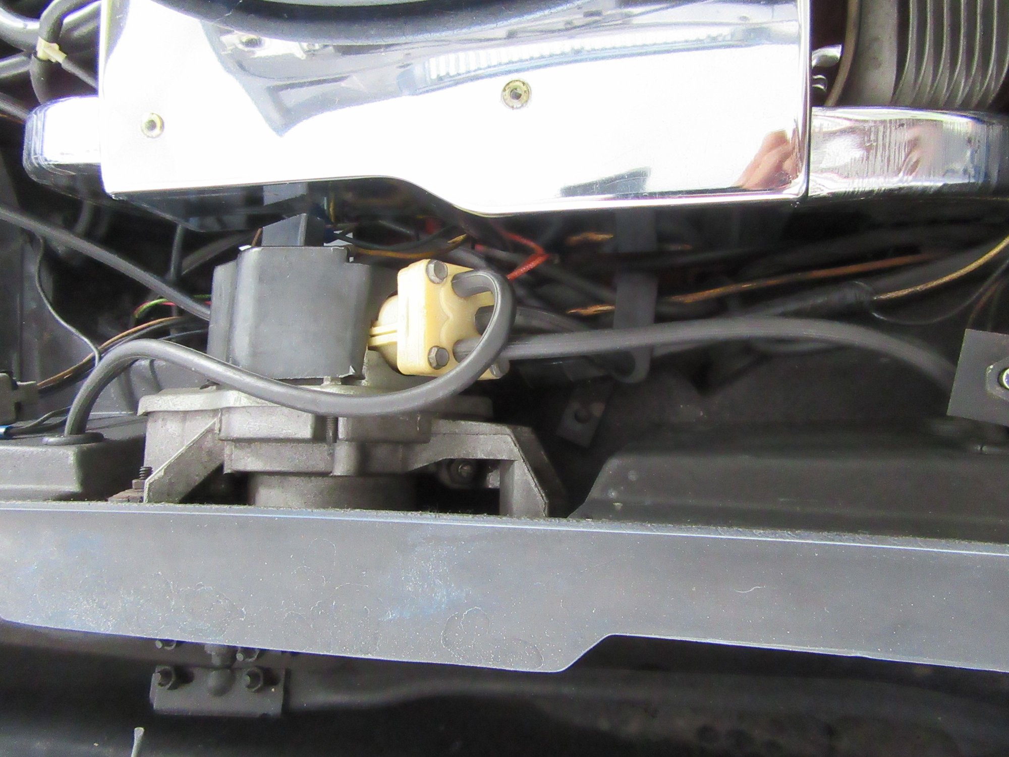

pic C shows a pump under a black plastic cover on the front of the wiper motor unit. Looks to have a couple of hoses coming off it , probably one feed from the bottle other should supply through hole to the T piece and onto wiper arms .

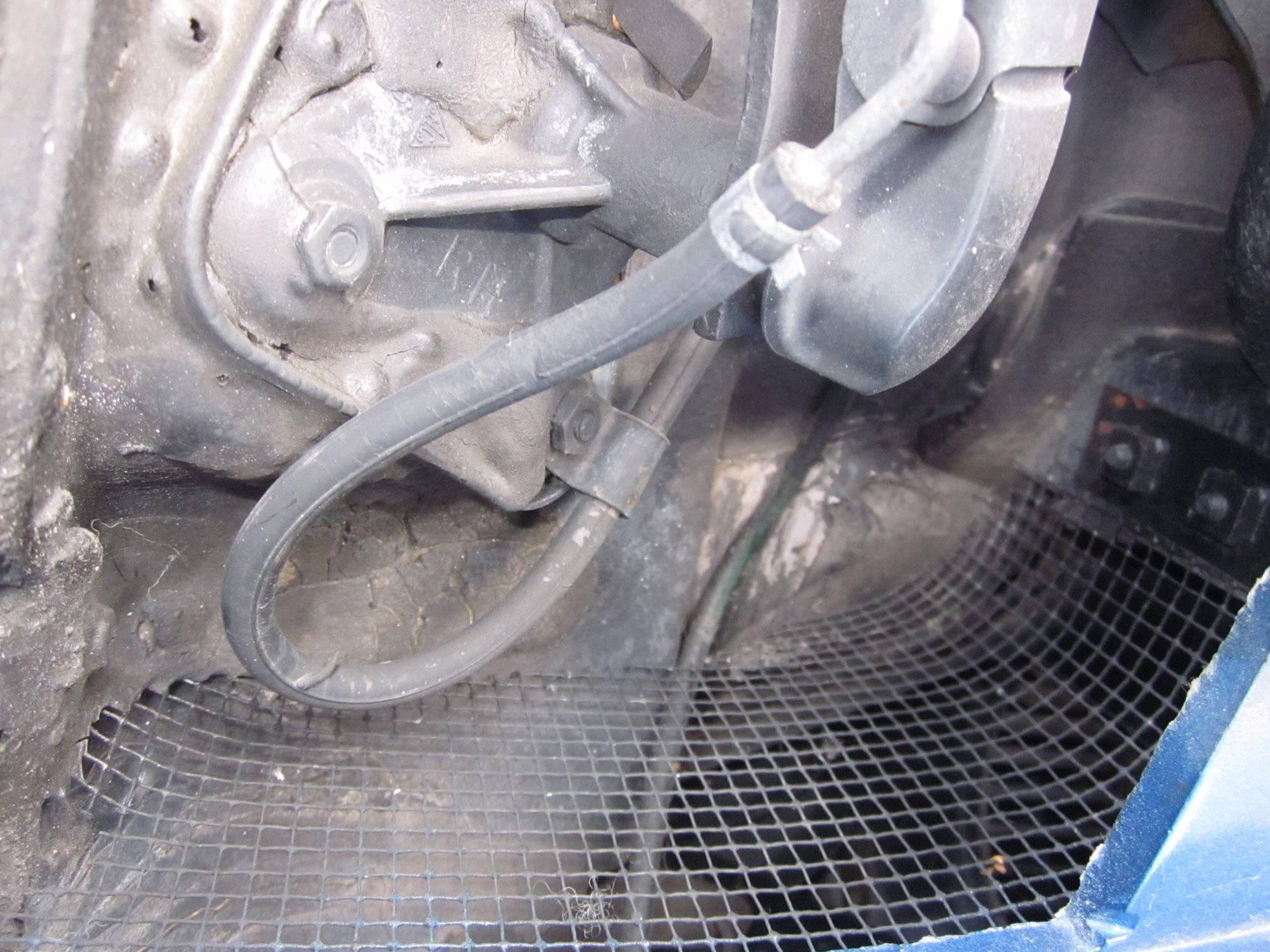

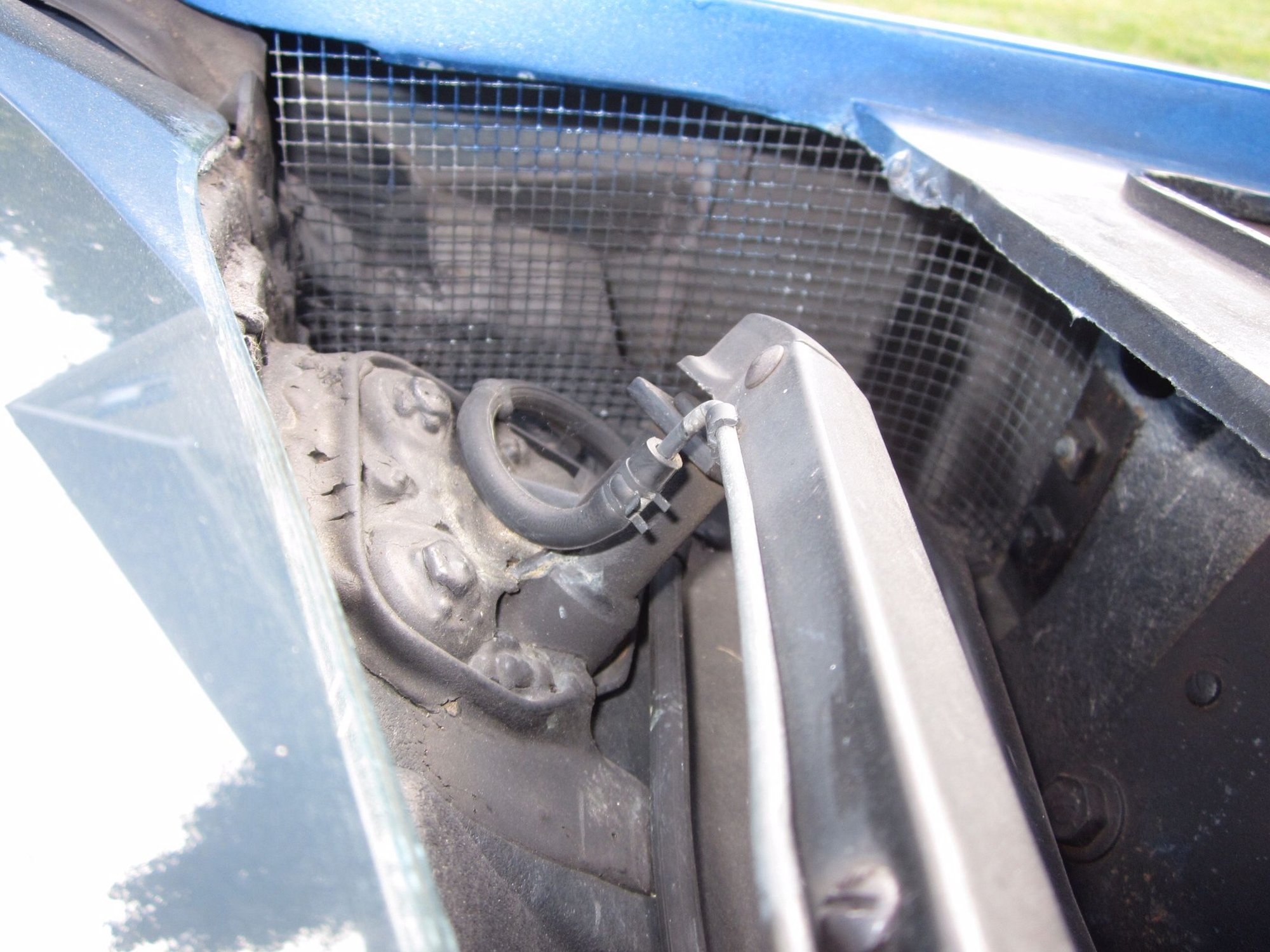

From my 73. Fran

Yea mine have definitely been removed.....weird. thanks for the pics. they explain a lot. do you have a pic of where the lines connect under the hood?

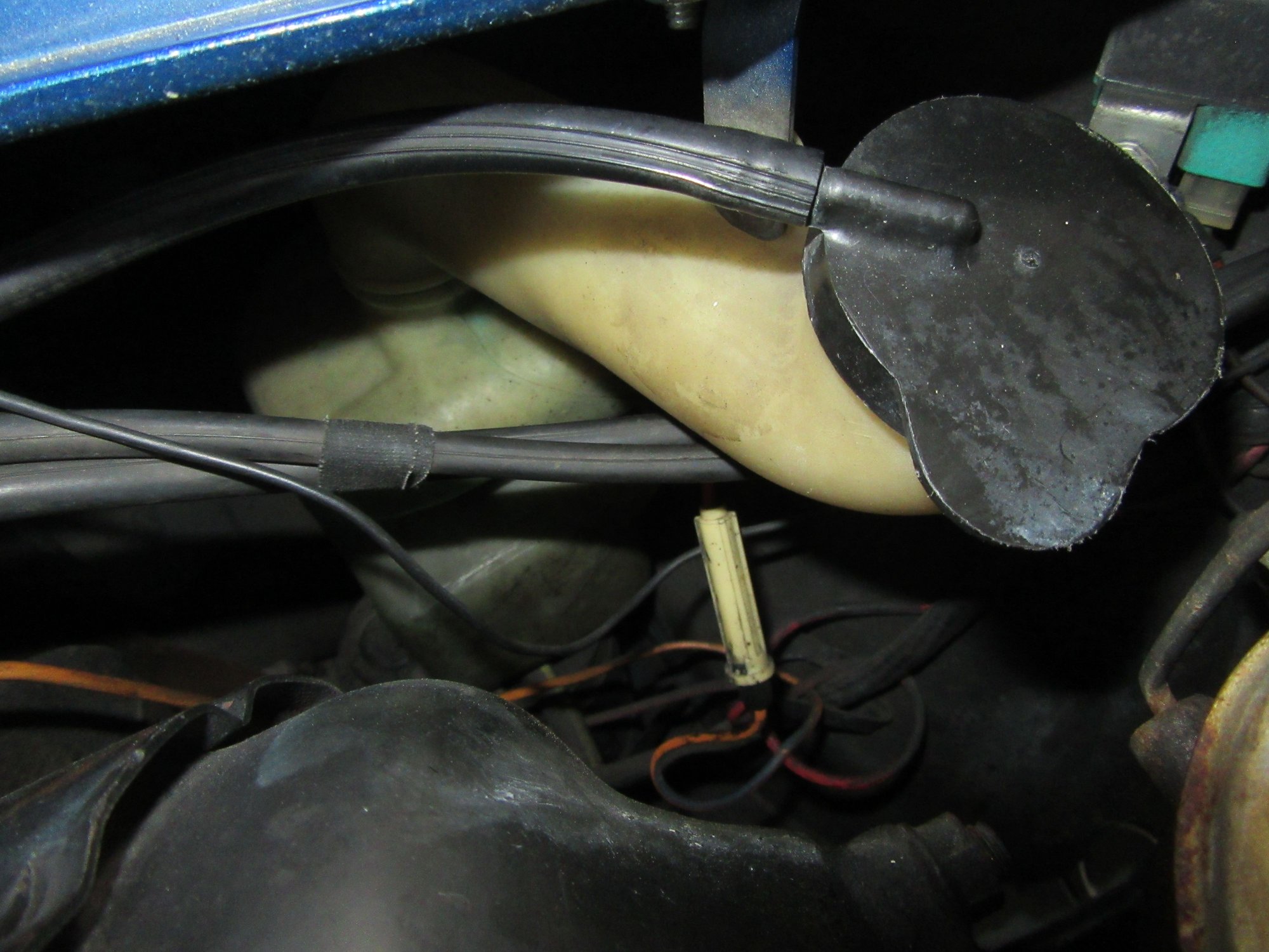

The tubes from each wiper enter the yellow plastic block attached to the wiper motor. The third tube goes to the washer reservoir. Pics of both are attached.
Fran
Fran
Ok thanks for the pics and info. Yep mine are gone...ha ha.
