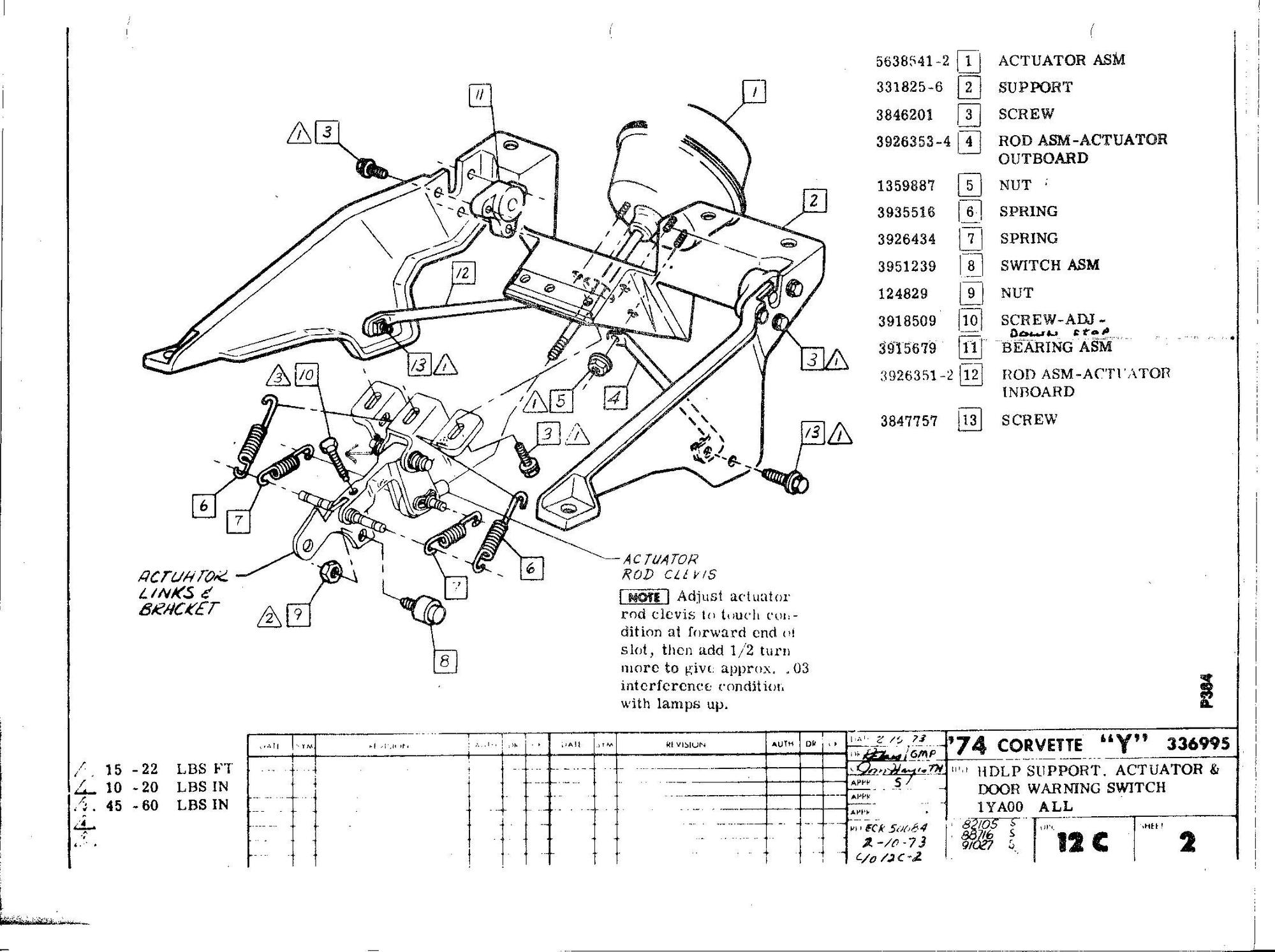

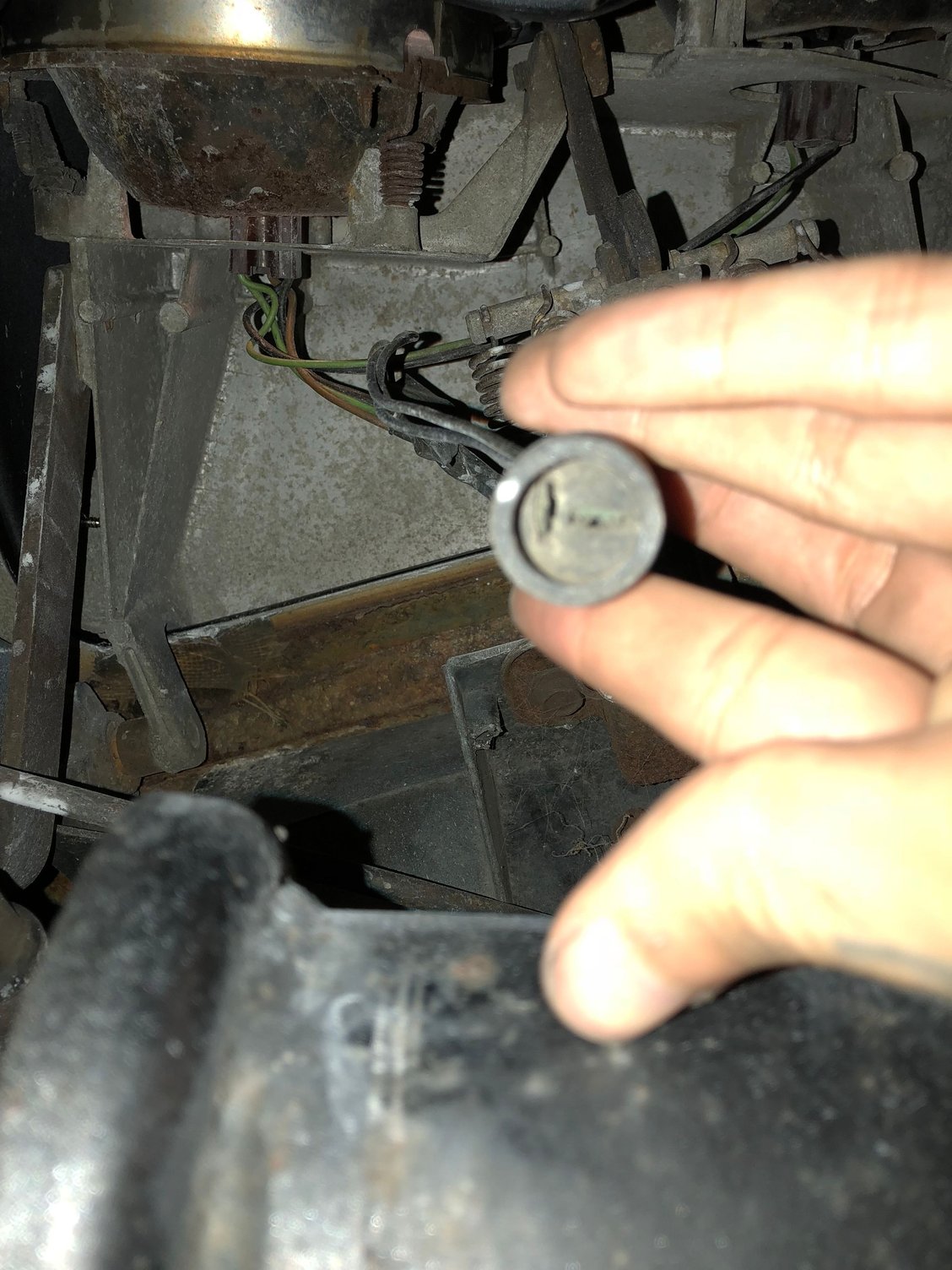

Found 2 of these which are attached to the front headlights, the have black wiring which I’ve been told is a grounding or a power part. I’m wondering if this has anything to do with my light issue. Any ideas?

Those connect to the 'headlight warning' switch.
When you pull the headlight switch the red square on the dash goes on until the headlights are UP and locked.
See #8.
https://willcoxcorvette.com/catalogs...warning+switch

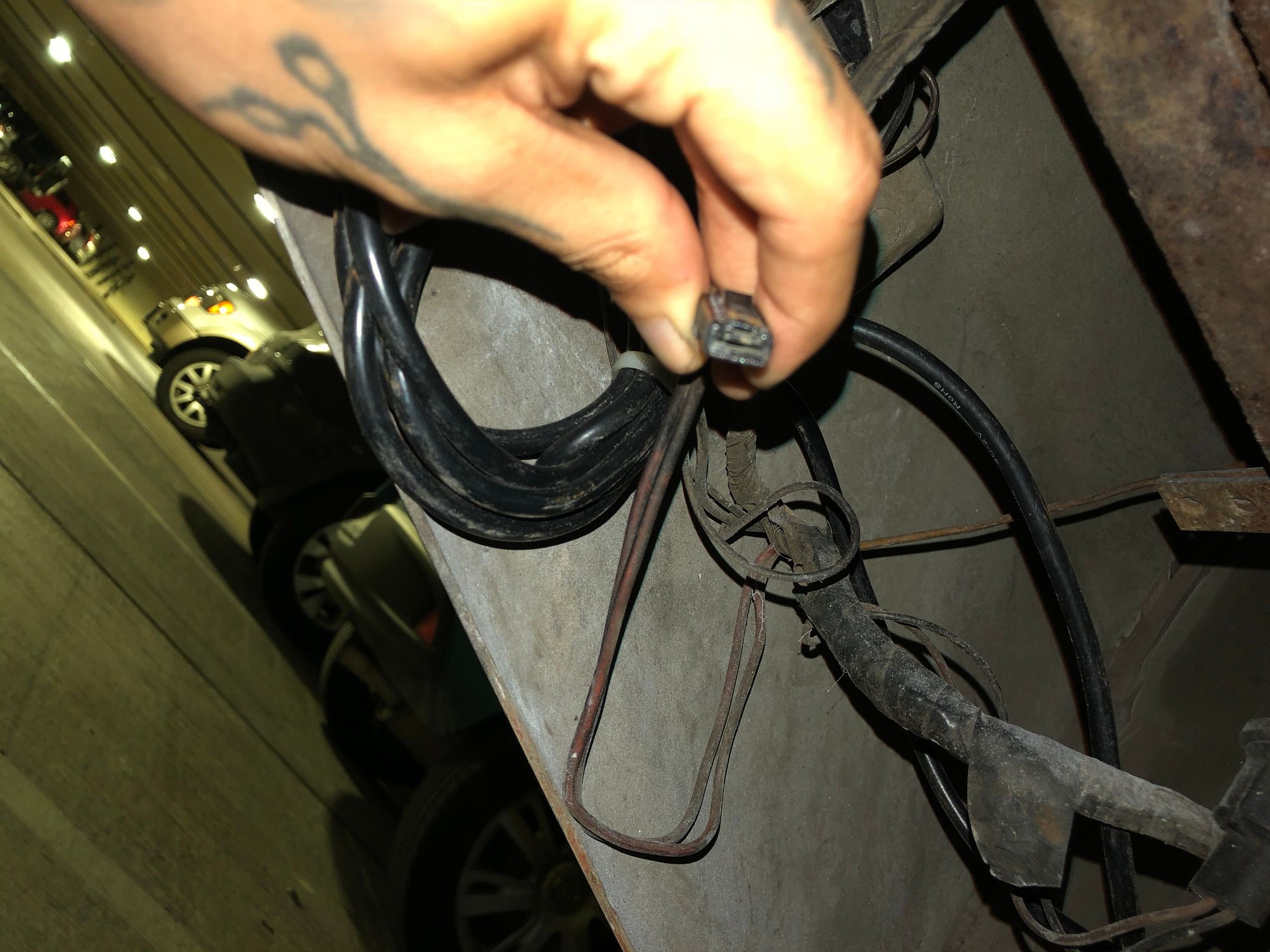

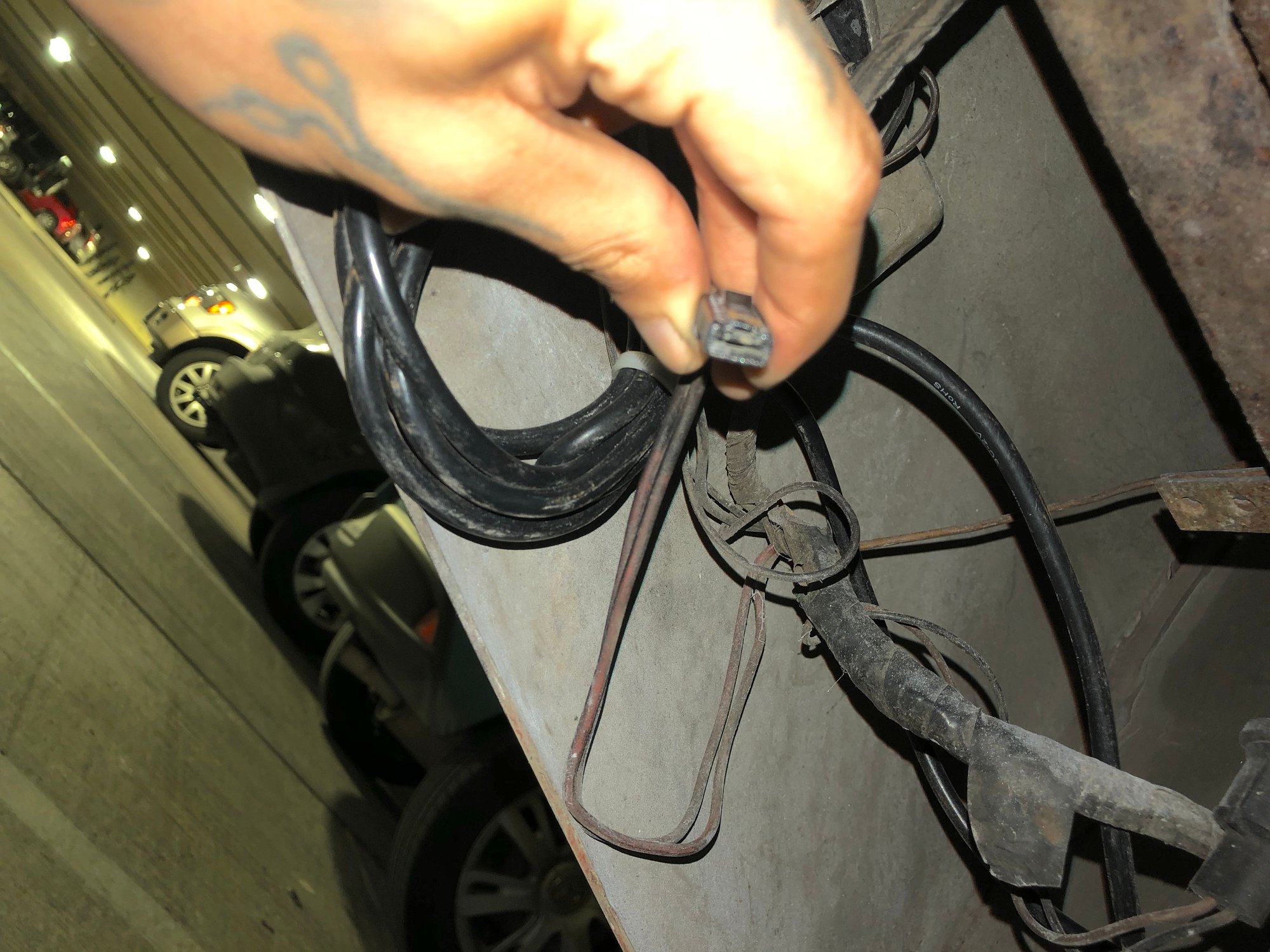

Default Rear lighting m
does anyone know what this is? Does it connect to one of the tail lights or does it need to be grounded? I believe it may be the solution to my tail light issue.

Is that on the left side? That might go to the factory alarm horn? I don't know if '75's had such a horn or where it is located though; the '72 has one back there on that side.

yes, it’s in the rear driver side. I was hoping it would have something to do with the tail lights. Looks like I’ll just have to take it into a shop because I’ve checked all the grounds, I’ve even replaced the turn signal cancel cam, so there must be some sort of resistance in the wiring and I’m not skilled enough to get into that
